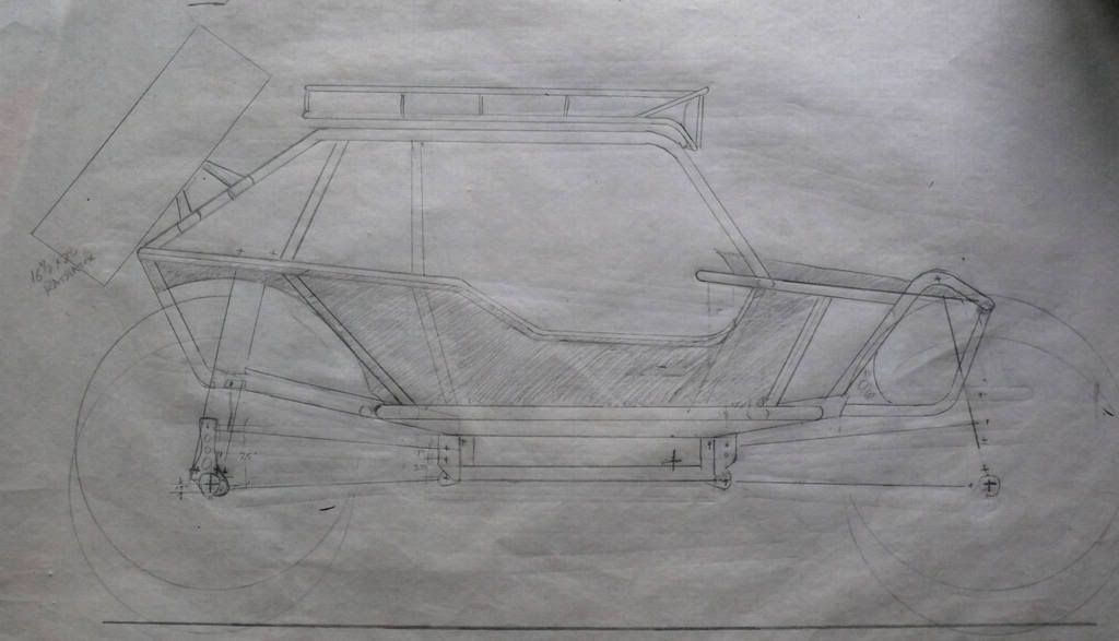

The word is out that we are working on a pretty “cool” build (no pun intended:D). This will not be a typical rockcrawler meant to tackle a few hours of trails and return back to the trailer. The idea is to build a very universal rig that will see a lot of trail time, sometimes 5 to 6 days out before returning. During these trail runs the rig must be able to crawl and climb the toughest of obstacles, yet be able to do some pre-running in the deserts of Mexico at the same time… A true all purpose “Dual Sport” rig. ...Oh, and it's going to be street legal too.
Before we even get started I want to thank all the companies and individuals that are working with us on this build.
On to some specs:
Chassis
This will be a one off chassis that was originally designed for myself but will likely be added to our lineup soon.
It will be a 2 seater with lots of room in the passenger compartment for days of comfort on the trail
and a little extra room for all the gear. It will be 58" wide at the cowl, 20" belly at ride, the rockers will have 30" of clearance at ride, the top of the cage will be around 71" at ride. WB will be 111"

Looks neat. Interesting lines on the rear roof tubes, I like how it flows.
I assume the "nerf" bars will be past the body, if so I'd put the dimple up on the strip of flat stock. They'd offer allot of grip for you foot then.
I agree but, the plate is slightly recessed down and I didn't want mud and water to stay trapped in the "step". They are already welded in from the bottom... super clean, perfect fit.
