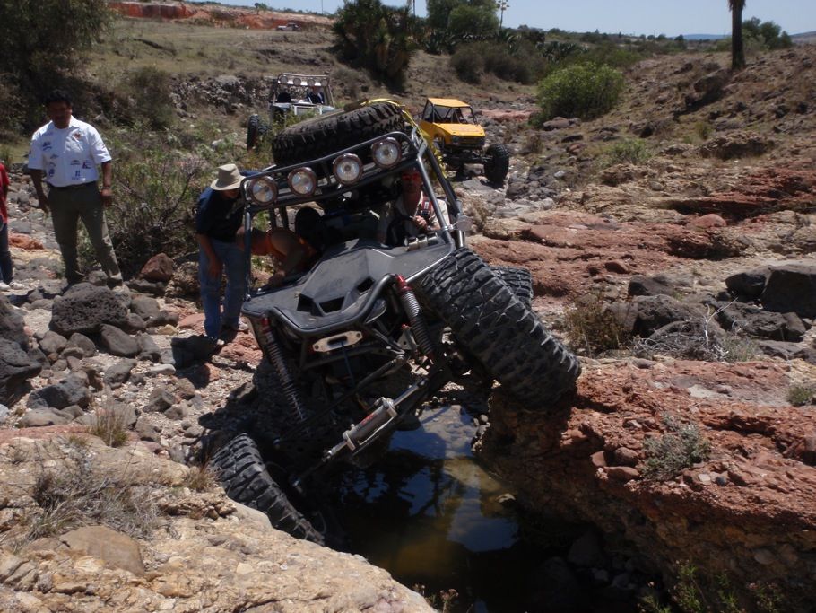

Few pics from a recent trip... you may have seen a few others in the Salvador thread of the same trip. Thought you might enjoy.
The owner is contemplating on selling it (as he feels it's just too nice to beat on it). If you've been thinking about having a new rig built, you might think about how cool it would be to run next years KOH with the A/C running:D.. This rig has the same suspension geometry as Scooby's rig that placed 3rd in the LCQ with a flat tire. Without the flat, I have no doubts he would have posted the fastest time there. I'll have more news about the sale of this rig released soon.
