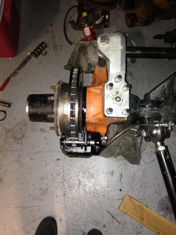

Chevy kit shown - Ford has 5 holes for spindle and a spacer.

Well I guess I am the guinea pig for the ball joint front ends. I have a 92' Ford d60 that I purchased a kit for and it seems to fit. We have just test fit it, as work is being done to my rig. We did however have to purchase some grade 8 bolts and locknuts as my stock spindle studs were not long enough to fit the bracket and spacer and spindle. Not sure if someone in the past installed shorter studs just know mine wasn't long enough and from checking with part suppliers, supposedly the spindle studs for a King Pin and the ball joint axles are the same for Fords so I didn't order any new spindle studs just purchased bolts and locknuts and tack weld the hex head of the bolt to the back of the knuckle. Not sure that is even necessary. Just thought I would post to let you guys know who have a Ball joint front end that the kit seems to fit fine. Should be able to post up on function within the next 2 weeks. axle rebuilding and gearing and swapping going on along with new 4 link kit, and additional stretch.
