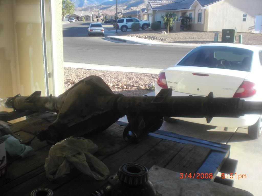

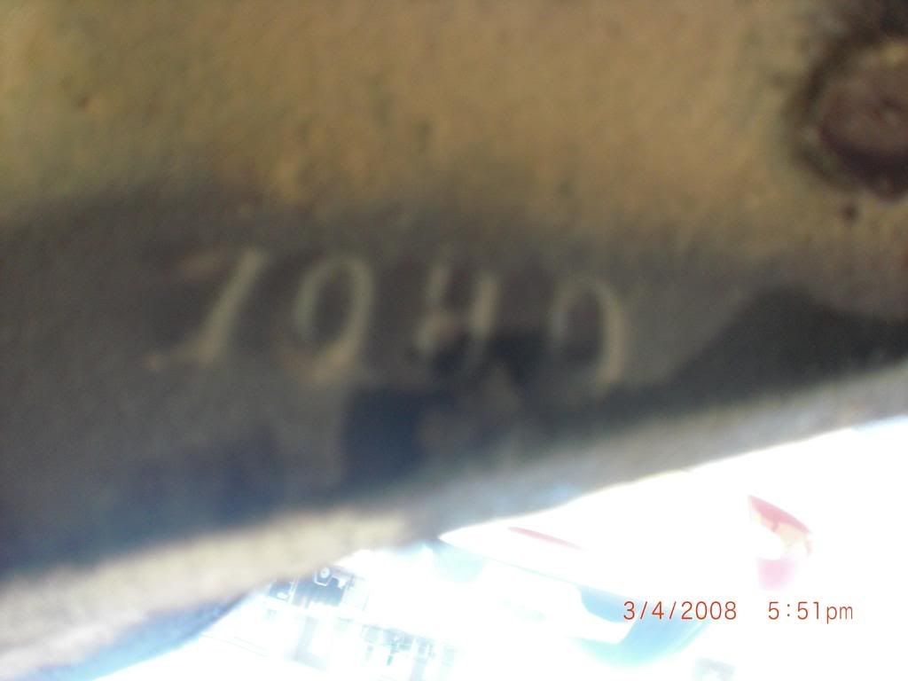

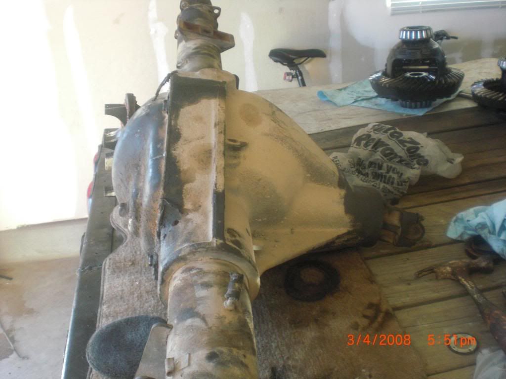

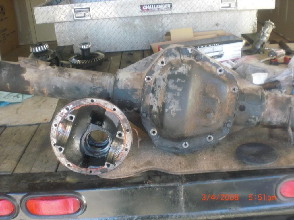

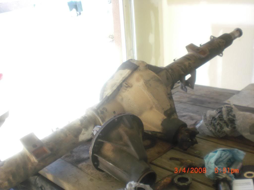

well i know im the new guy on here but that dose'nt mean i cannot be useful with the teck and such im building a dana 70 front on the cheap mostly ebay parts and junkyards stuff and a few things from members of pirates and such i bought this stuff over the course of 7 months so the outa pocket was'st bad at all just 100 every payday or so my parts list goes as follows
Dana 35 spline 70-HD $100
from U-pull Tucson
stock inners from pirates $100
35 spline outers Ebay $120
Dana 60 outer knuckles $150
with tube off Ebay
stock outer dana 60
knuckles with all the
bolts and goodies ebay $100
Dana 60 spildles ebay $50
brand new set of Dana $100
60 hubs and rotors
off ebay
bearings for front hubs $Free
still need a couple more
parts but just little shit like seals and stuff might narow the long side if its too wide but here are the pics i got of all the stuff befor i clean it cut a perfectly good low mileage dana 70hd apart and weld some shit my axle shafts are on the way so i cant put it together yet put will prolly by this weekend its all going under my big green 79 yota for now im gonna keep the 410 in the front and run yes a toyota rear axle till i get a dana 80 or another 70hd and dont tell me the shits to big less ground clearance bla bla bla i know ive reserched it all now its go time

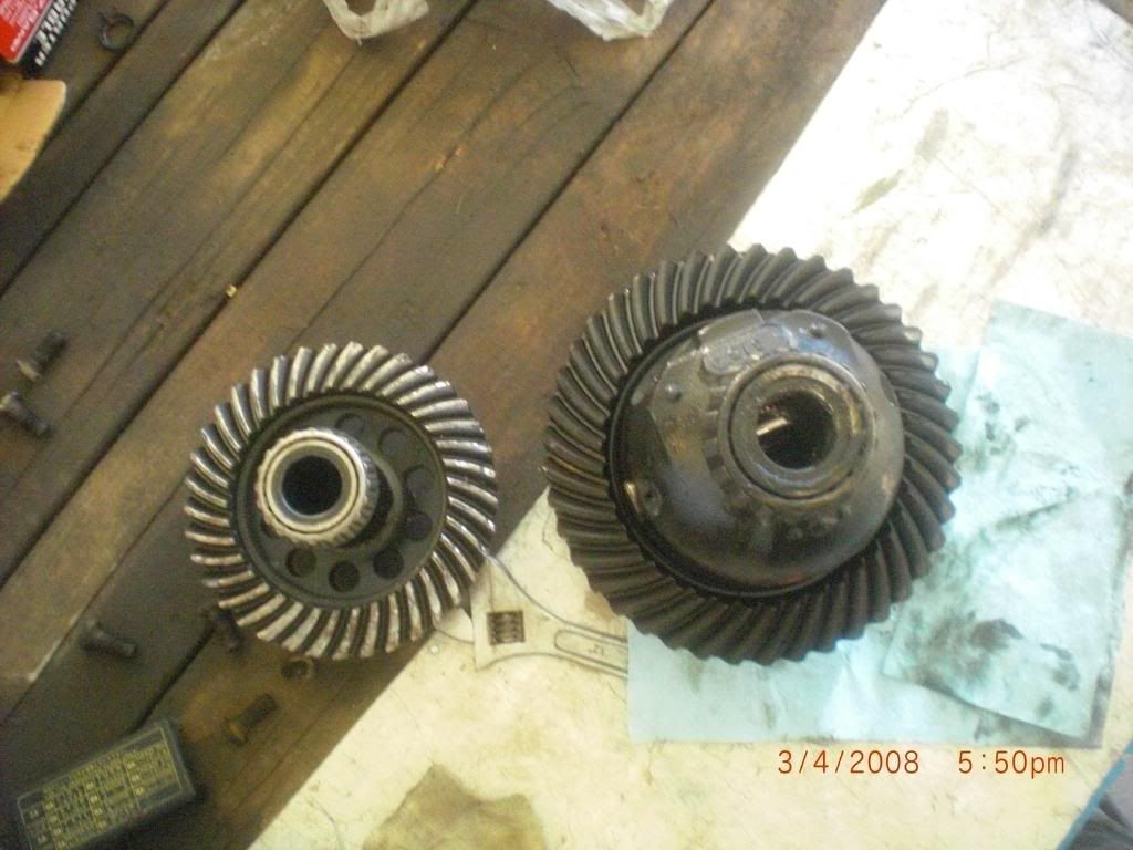

dana 70 compared to a toyota 8inch carrier
random picks when i got the 70 home
more comparing toyota to the 70

That d70 ring gear really makes the yota stuff look weak :eek:

Question for the OP. IIRC the D60 diff cover is the same as the D70, so is the housing clearance the same or less? I could only imagine less. Any chance on clearancing?
1,669 Posts
The covers aren't the same but the 60 cover will fit the front of the 70 and can be clearanced to a 60 through cutting the pumpkin to basically the same lines as the 60 cover. It is a lot of cutting though (read - start with a portaband before you ever even look at your grinder)

ya kaptain ive broke so many ring and pinions and axle shaft ive even broke a long and im steping up from 39s to 42s plus i just moved to arizona and i need to step my game up
C'mon I expected more from you Kaptain!
My take is he will retube the axle and run D60 outers to make a FRONT axle from the rear axle. :smokin:
BTW a buddy in Sealy, TX is doing the same with a D80 Center section as he keep destroying 60 R&P's on his big heavy chevy.
MaXXis85 ill have pics and explain exactly how its all gonna happen when i get home from work just bear with me and you'll understand but the jist of it is the outer dieamiter of the dana 60 tubes i have are the same inner diamiter of the dana 70hd 4 inch tubes so im gonna sleeve them together and turn my two 1/2 inch thick axle tubes into one peace 1 inch thick shes gonna be heavy and it will be a nice big rock magnet
