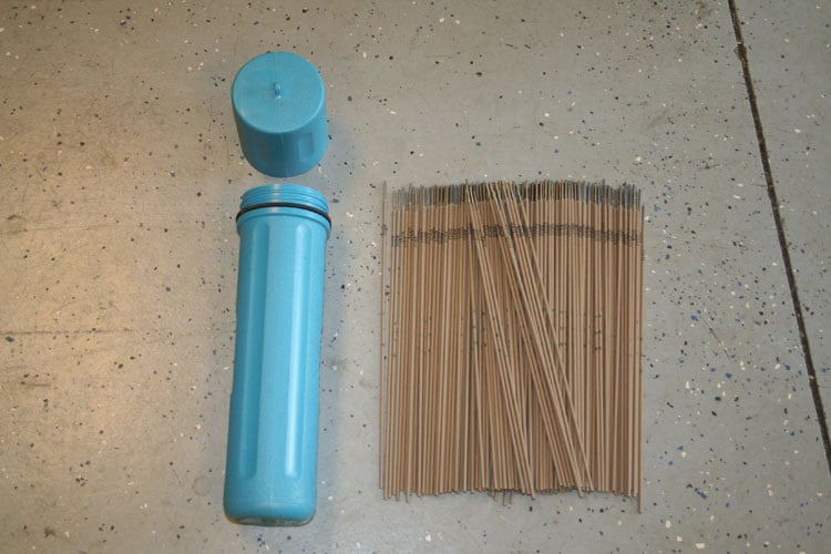

I purchased all the welding stuff from our local welding supply shop. It cost about $200 for the wire, rod, rod holder, ect.

3/32" rod 6011 and holder:
The welder is not strong enough to burn 1/8" rod, so you must use 3/32".

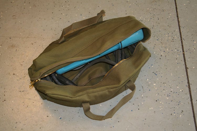

Purchased this bag from Youngs Army Navy for $9.
