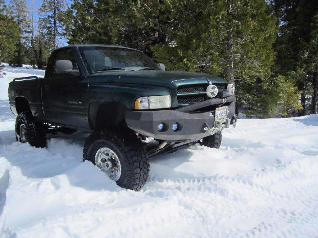

I drive a 1999 Dodge Ram. It has a 318 5.2L v8 with an air raid intake and flow master exhaust. The trany is a nv3500 5 speed transmission to an np241 t-case. It has a 3in body lift and a 5in suspension lift. Alien patrol bumper housing a smitty built 10,000 pound winch. It sits on Dana 60s with 5.13 gears and arbs. The front has had the vacuum disconnect removed and a solid shaft installed along with serviceable hubs, bearings, 35 spline outers and warn hubs. It rides on 38.5 14 r17 pro comps. I think i might be forgetting some stuff but that’s a good start.
This leads me to the reason I am posting. I want lower gears for crawling. I have looked around and found a lot of talk about running a Klune V. I want to know if any one here has any real time experience with one. I think that would work the best for me and a straight forward install.

I never saw the black box when I was looking at possible solutions. I am glad I know now, but I have already pulled the trigger on a used klune V. I am surprised no one has any info about this in a Ram or they just don't want to post up?

It seems you have it figured out, but an alternate solution would be to swap in an NV4500 for the much deeper first gear.

Black Box is cheaper, basically giving you a NP241/NP241 doubler. I believe you need to look into getting a SYE kit for that 241 after adding the Klune though, to compensate for additional length and needed slip. That will be your new weak point.
I've considered the 241/241 doublers, the 241/205 doubler, Klune V, Black Box etc etc. But in the end, the Atlas and Stak are probably the best investment. You can add an Atlas to a Klune or Black Box and have a 4 speed, but it's not any cheaper than buying a 4 speed from AA. I also believe the 4 speed Atlas is shorter. I agree that the 4500 probably would have been a better investment in the long run though.

How does the truck do (power wise) with 5.13's and 38's? i'm doing a 1 ton swap on the same truck, my axles have 4.88's and I plan on running 37's.
