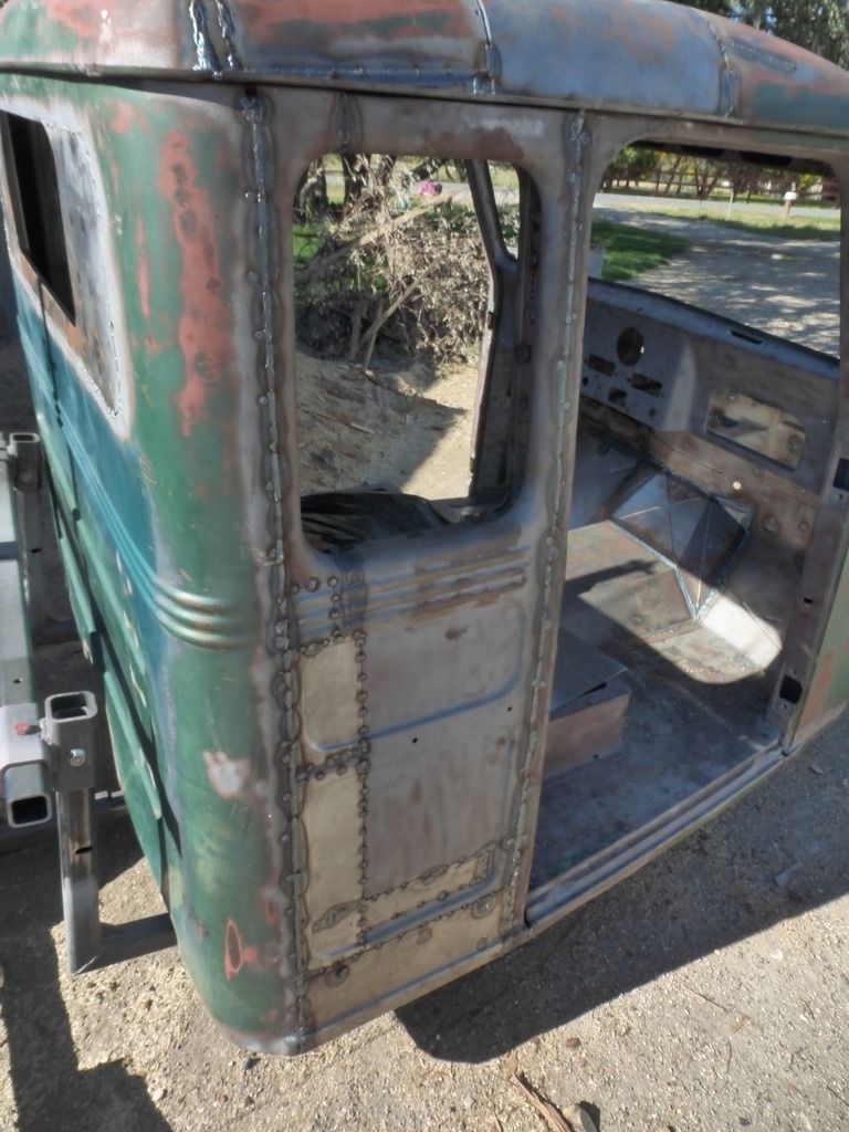

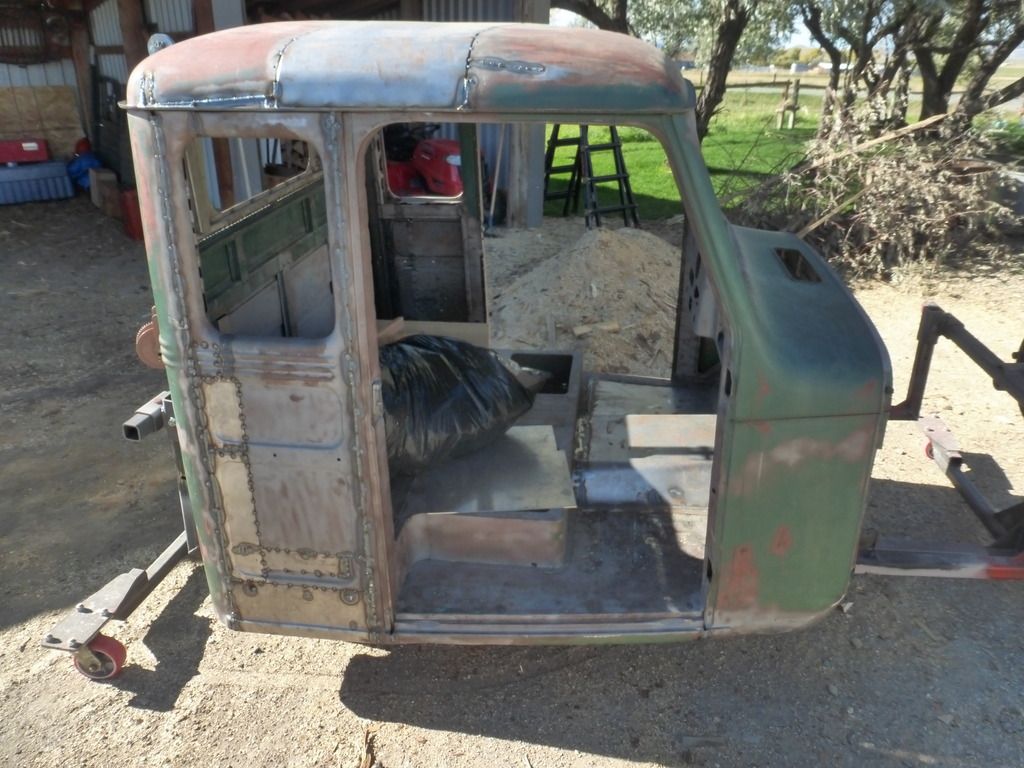

I obviously have a loooong way to go, but I got this far with the cab and now I'm getting the axles and frame ready.
Yeah we're going to need see more of that. :smokin:
Thanks for the kind words. I have a build log on Old Willys Forum under the same username. I lengthened the cab 15", built a window from a wagon I cut up. Now with the 15" + 5" that was behind where I cut, I now have 20" behind the door. It's going onto a shortened suburban frame with a D60, 14bff, 205, 4l80e and a 6.0 lq4. Slow going because I'm on a tight budget but I'll get there.
