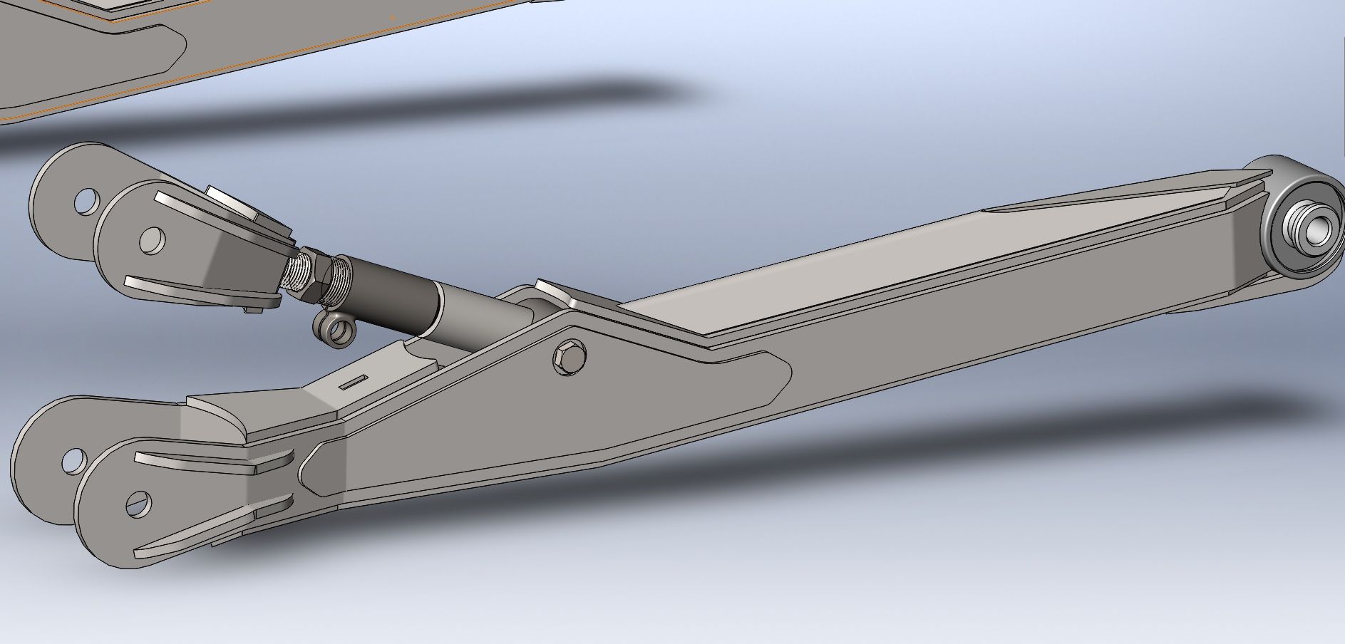

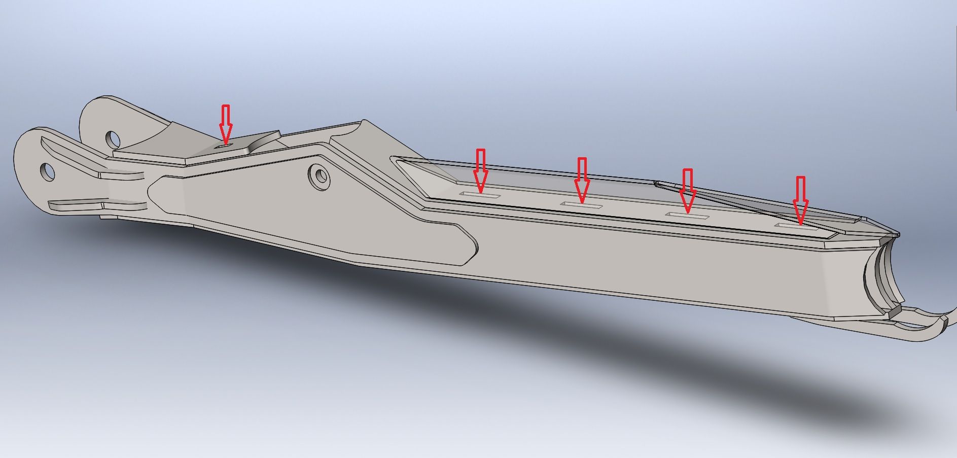

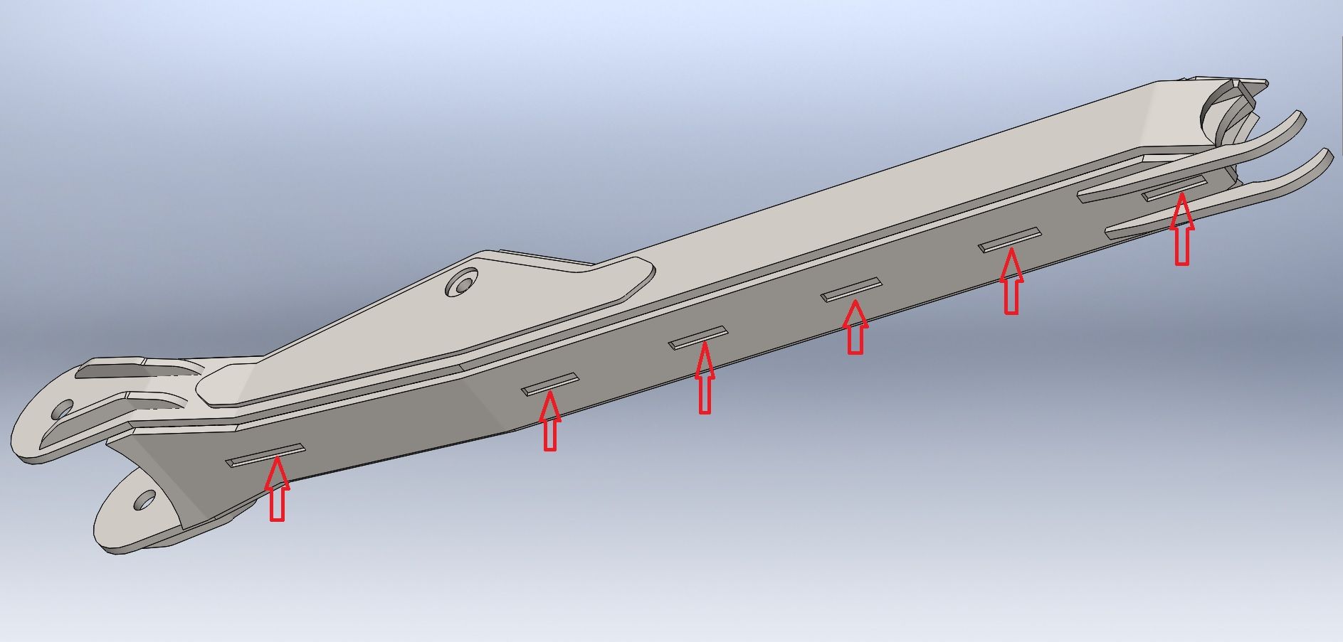

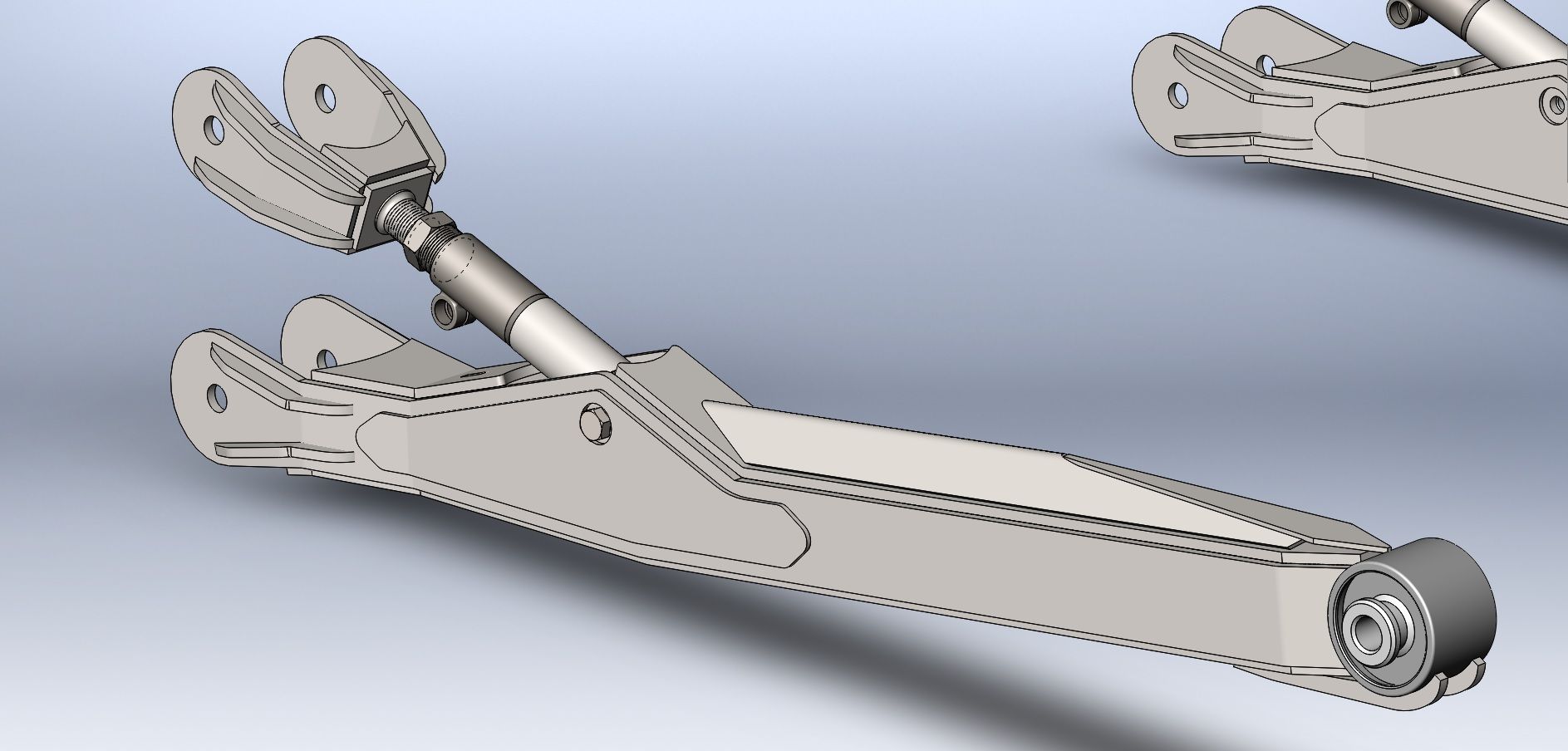

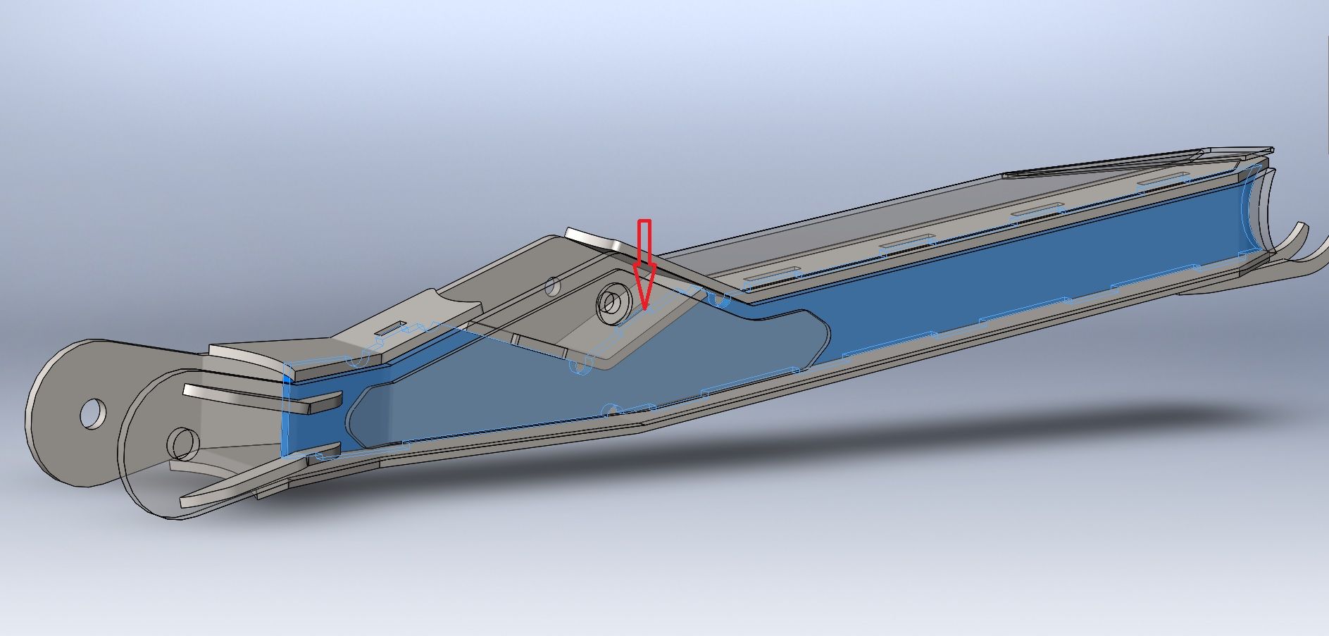

These pics might help. The arrows indicate direct access to the backbone. Just burn that in and you're done.
Also a couple more pics to help anyone that may be watching. Be sure to position grease zerks correctly. The big joint at the end, point the grease zerk down toward the ground. The little fingers will protect it, and it allows for easy greasing when under the truck. The smaller joint for the upper link, position it upward, and as close to the little 3" piece of DOM as you can get it. That way you won't have to worry about hitting it whenever you set caster.
