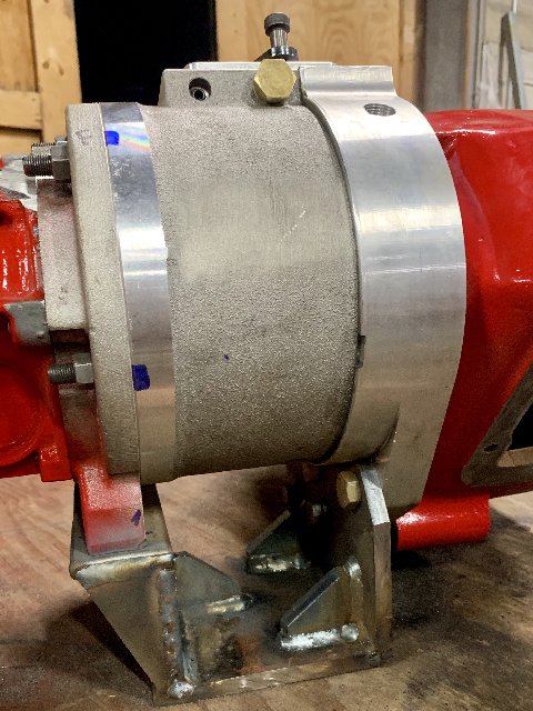

The Magnum arrived safe and sound Monday. I was able to "ohh" and "ahhh" over it after about 15 minutes of cutting out spray foam. Nice job, ORD, she's super sweet :D

Catching up here after a bit of a hiatus. The new drivetrain is awesome and am super stoked to wheel is 2020.
-GM TH400 rebuilt with ATD reverse manual valve body, billet drum and kevlar backed intermediate band. Stock filter & pan for now.
-Stock replacement torque convertor for a K20/K30, stall 1800 - 2200
-ORD Magnum for a GM NP205. Adapted to the TH400 w/an Advance Adapters 1" thick aluminum adapter.
-GM NP205, Figure 8 case. Synchronized front output swapped for 32 spline ORD front ouput, mod'd shift rails, & twin stick. Torn down, cleaned up w/all new new seals. I tapped the holes in case normally caped w/rubber plugs 1/8"NPT. Made a plug for a speedo hole from a few factory parts. Also made a PTO cover w/1" fill.
-Magnum vented into the 205, 205 vented to chassis rear, siamesed with fuel cell vent.
-WFO Toyota - 32 spline NP205 output flanges
-JB Fab triple shifters
-Fan powered cooler stuffed between the rear seat & battery along with a finned cooler below the rear floor panel. Wired to a switch in master switch box. 8AN trans lines.
-Installed a trans temp & fuel pressure combo gauge in the dash.
-Trans and Magnum bolted to a shared mount on ORD supplied bushings.
-Mounted to frame on 1.75" x 0.12" DOM cross member, bushings, and tabs.
-Skid plate from Barnes, 3" drop for a YJ which fits the taper of the frame great.
Clearancing the TH400 case to clear the Advance Adapter hardware. There's no mention of this in the instructions for the adatper or Magnum.
