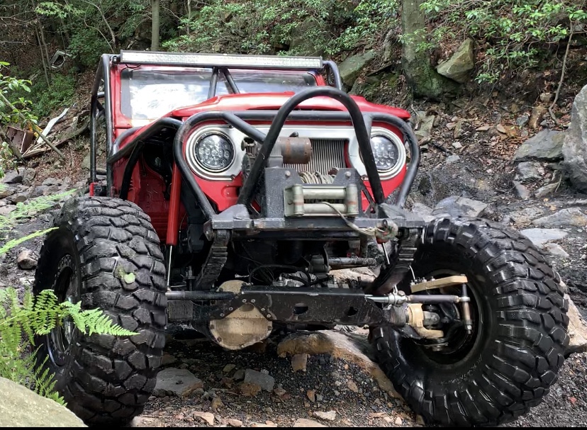

Update!
-14 bolt swap is done and the test drive went great. Maybe my expectations weren't realistic but I was expecting to feel more of a a difference on the street going from 4.10s to 5.13s.
Going from a welded carrier to the Grizzly is awesome though. The Cruiser handles way better and doesn't drag tires around every turn. Also, the brakes seem fine so I don't think I'll have so swap master cylinders which is a relief.
-Started swapping the front w/a new Artec dual ended ram mount which I rotated up about 2" from before, DIY4X's D60 shock mount/knuckle gusset kit and perch shims, and ORD's spring perch studs. Once I'm all welded out, I'll slap some paint on the housing and sling it back in for good.
-Received Total Metal Innovations' 14 bolt shave kit for the 4Runner's C&C 14 bolt which seems pretty decent out of the box. We'll see how installation goes.
