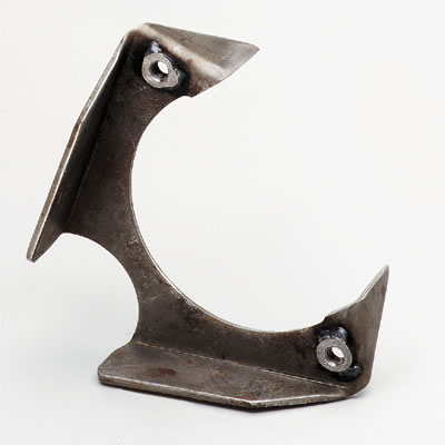

You can order Howe weld on caliper brackets from Summit racing.
http://www.summitracing.com/
Part # HRE-340, $25.39
do those fit the calipers mentioned above? if not, then what kind / is there enough material/room on them to modify for the calipers mentioned?
i don't have a plasma or a torch, so cutting it out with a grinder or sawzall would be loads of fun.. thanks
The Howe mounts are 7.040" mounting bolt to mounting bolt. They work with '74 blazer calipers. Should work with most any pickup or fullsize car from the 70's. I'm not a GM guy so I'm not sure of exact years or models with that spacing.
