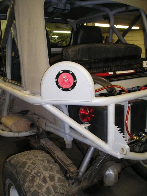

Biggest thing you have to worry about is the top of the tank sinking. Here is what I did to the Mother-N-Law's jeep's tank. It's just one of those cheep poly ones that they had sitting around. It sunk horably and was getting water in there every time it rained.
Are there any disadvantages of the plastic circle track tanks mentioned above as opposed to others? Mine will not be in a location where it is susceptible to damage.
Biggest thing is the sinking of the top...
They don't have a realy good sump. They are designed for drag racing where you know where the fuel is going to be (at the back of the tank).
Make sure you put in a FATS breather system. I have knowtised most roll over valves don't work very well on their side. In the one above I used the FATS system, a check valve, and a fuel filter as an air filter for the breather.
They also don't allow those cells in most "fast" racing. You have to use a hard sided cell with a seperate flexable bladder. They are $$$$$
what exactly causes they sinking? And what type of cell can resist the sinking? How do you go about hooking up a site tube for your fuel level? Also i tried searching for the FATS breather system but couldnt find anything, where do you get that?
mine is sinking because the hold down brackets are to tight and the tank has expanded enough to not sit properly in the tray we made for it.
Other then that my 16g rci works fine. With these tanks allways figure that your going to lose a gallon or 2 due to it not getting to the pick up if your on an angle. Ive had to unbolt the cell once recently to get off the trail because i ran 3 days of wheeling and didnt fill up :p
