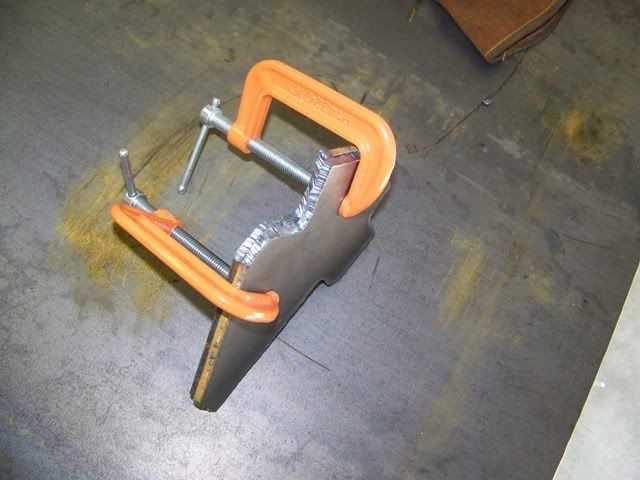

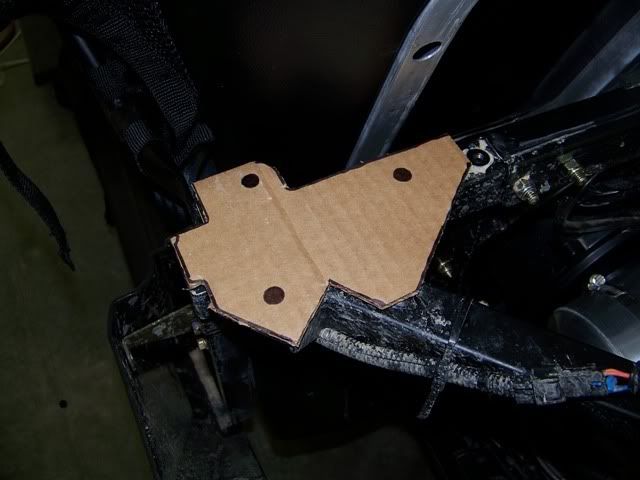

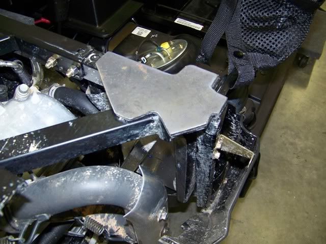

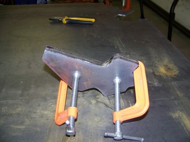

My inspiration to build this cage is the fact the stock one is a death trap. To start, the stock mounting pads for the stock roll cage are pathetic at best. I am beefing both front and rear up with some 3/16" steel plate. The rears will be held in place with four grade 8 bolts per corner. The fronts will be welded down.
