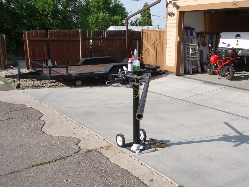

When I buillt my new house I had the concrete guys put a 12x12 footer in the drive way that is perfectly level. Welded some wheels to the tube bender. No need for hydro. I just through a 12' piece of tube on the handle or bigger and walk the bend. When I am done I just put a 12x12 peice of wood between the anchors. Sucks when Im drinkin beer and plowing with the atv and not paying attention.

I like the idea, but I would have had them smooth it out or something.. that's one hell of a tripping hazard if the bender isn't there.

nice idea. I cemented a piece of reciever tubing in the ground that is level. I put my bender on another piece (male end) of reciver tube. Wheel it out to tube in cement, put it in, bend, pull it out. I put a flat plate on another piece of tube and put that in the reciever when not in use so it covers the the hole.

Just paint that 12" x 12" yellow so you see it before you trip over it -on the days it's not covered in snow that is. :D

Hi-lifts bring the suck, I can't imagine trying to fabricate with one :eek: For not much more effort and the price of a good hi-lift you can just go hydraulic. Cheap power ram for benders
No contest the bends are smoother and more consistant than the ratchet method not to mention you can quickly roll the bender out wherever you want, bend and then roll it back into a corner. Hardest part was collecting the bolts and material, you need to make a clamp for the air/oil cylinder (exhaust tubing) and a few sleeves. The cylinders can be had from Harbor Freight and have been as low as $69 before coupons. I actually think I have seen a kit for sale that lets you mount one of these cylinders to a model 3. I get about 80 degrees with one shot before having to index the pin in the die.
