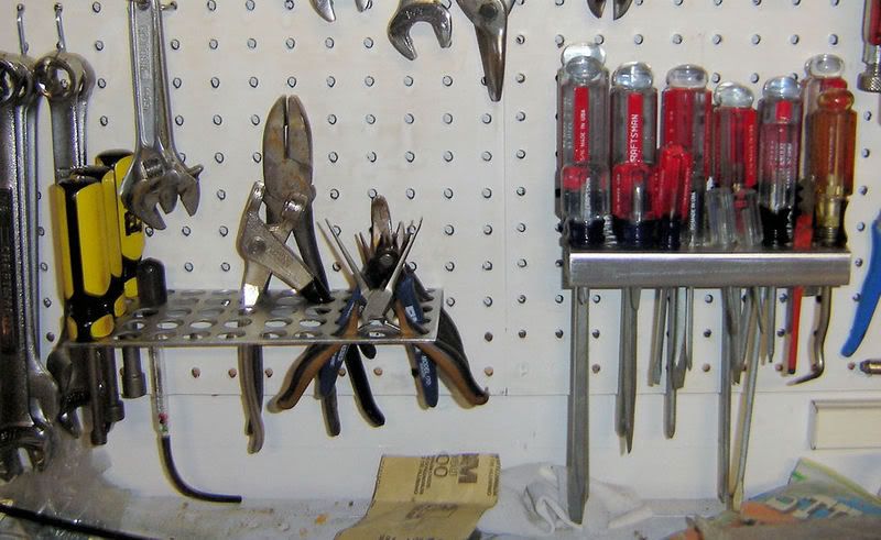

I've been looking for some good screwdriver and plier racks, and I haven't found any I like at all, even on the net. So...I did a little work and came up with these:
12mm aluminum test tube rack (used for screw drivers).
http://www.christianbook.com/Christian/Books/product?item_no=735607&netp_id=366647&event=ESRCN&item_code=WW Hey, the christian bookstore was the cheapest, shut up.:flipoff2:
and 17mm aluminum test tube rack (used for pliers, nutdrivers, etc.)
http://www.christianbook.com/Christian/Books/product?item_no=735606&netp_id=366646&event=ESRCN&item_code=WW
For the 12mm screwdriver rack, I just cut the flat aluminum bottom plate off (leave the flange so you can screw it to the wall), and left the two layers with holes together. This helps the screwdrivers sit straight.
For the 17mm plier rack, I cut the bottom plate off, and cut the two pieces with holes (leaving a flange on each for screwing). The two layers together interfere with putting pliers in, plus this makes two racks out of one.

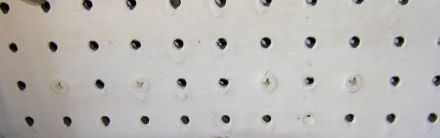

I then screwed drywall augers into the pegboard, they seem to hold quite well.
I drilled holes in the flange that was left on the racks to match up with the drywall augers, and installed.
It holds about 20-25 screwdrivers depending on handle thickness. I didn't mic them, but they appear to be .042 aluminum, although I don't think they're 6063 t6, as they're a little soft. They're plenty strong for this application, though.
I'll update when I get more of them (liked them enough to order more), and my aluminum pegboard gets shipped and installed.
