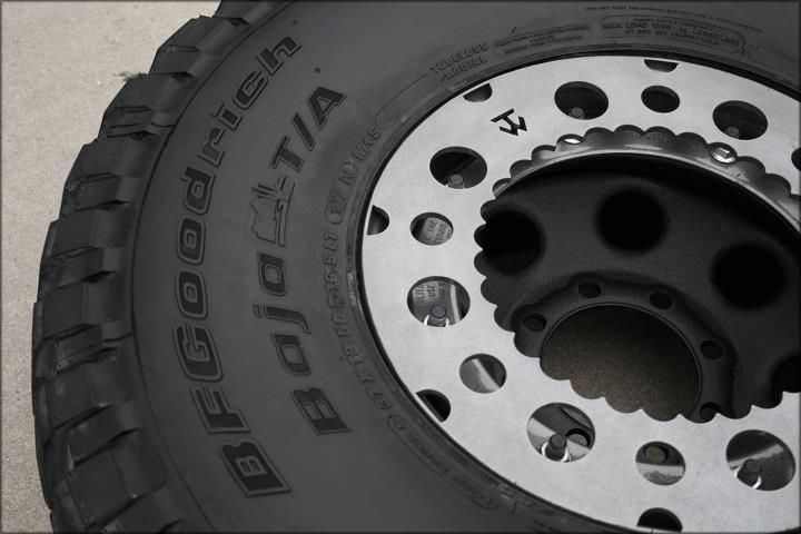

Old center that had been cutout on the left. Ring with the center cut out on the right.
It is unreal how clean it cuts them. And how perfect. If you look at the pics below you will see 3 tabs that are in there stock. Those are so you can not mess up aligning it. We cut just far enough out to keep those there.
· Owner TWF
7,493 Posts
After this process the wheel is sandblasted and preped for powder coat.

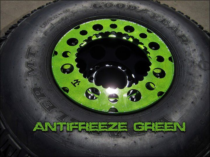

I just wanted to share what can be done
with about 8$ worth of paint and this will
let me show you what a 8 bolt ring looks like.
This is what the wheels start out looking like
This is the paint I used.
This is with the 8 bolt rings off before paint
Before on right after on left
Rings after paint
Painted rings on painted wheels
This picture shows what they look like
mounted on 42's as well as what the runflats
look like. They are easy to split because
they are a 2pc. wheel. I used a 5 gal. bucket
to mount my 42's.
Put your runflat in your tire first.
There are 4 bolts in total to put them together.
Then slide the main rim over the bucket.
Drop the tire over it and bolt up the outer ring. Easy:D
