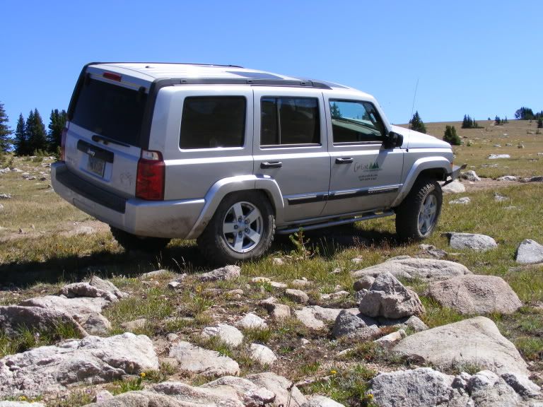

ha ha ha
my commander has more flex then that! :flipoff2:
bebe, we are winning the land battle in northern wyoming!!! thanks for your suggestions!

ha ha ha
Dood, I'm running 35's with no lift. If I had my stock 33's on, then we could compare :D
I hope it works for you. I'm a PM away if you need more help :D
