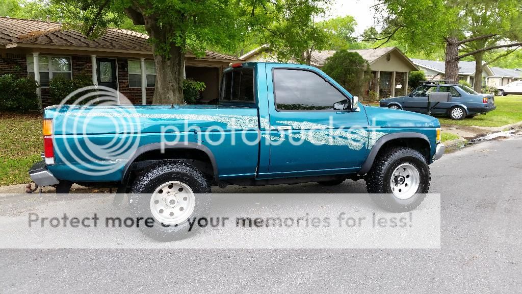

hey guys I bought this truck about a week ago in really crapy condition and Ive been working on it a lot fixing all the dumb s*** the previous owner did to it.
there a problem with my front hubs or axles don't know witch one it is take a look at the video and let me know what it is. will be making build thread soon!!!

I never managed to break a CV at the splines, let alone both at the same time.
I'm betting the clip on the end of the shaft(s) popped off and the shaft slid out enough to not be making contact with the splines any more.
Take out the 6 bolts that hold the hub cover in place and take a pic of what you see in there.
You have at least one torn boot, so you're going to need to do a CV job any way.
Might as well do the ball joints while you're in there. And might as well replace the tie rod ends while you're doing the ball joints. And might as well replace the centerlink when you're doing the tie rod ends.
Welcome to the world of the D21. :flipoff2:
