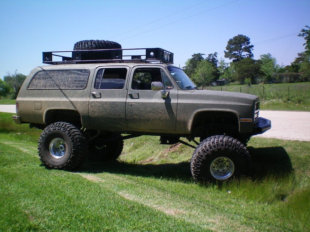

I was wondering if anyone sells a custom e-brake set-up. I did some swapping and ended up with this suburban on 46"s. Whoever built it built custom rear caliper brackets and used mid 80's chevy 3/4 ton front calipers. The thing stops great, but has to have an e-brake to pass inspection.

In your state does the E-brake have to be attached directly to the rotating mass...EX, the rotor itself? Or can you get away with a transfer case parking break where the a small rotor and caliper are attached to the output shaft of the t-case?
974 Posts
In TX you can run a driveline\tcase brake. Since it is an 89, should have a 241 tcase; you would have to get the slip yoke eliminator before you could do the driveline brake. But then its still going to have involve some fab work, as I know off no driveline brake for the 241. Might be able to get the one for a np205 from High Angle Drive and mod it to fit.

pop one on the diff. that makes life much simpler!

You can use a line lock or hydro lock for the rear line.
I never thought about a line lock. Thats an awesome idea.
Around here you have to have a working e-brake. I thought about driveline brakes, but not sure how strong the drivetrain is and may upgrade.

I've been looking at this, and still have a couple months til inspection is due. I'm gonna try a LT1 camaro rear caliper, they have the e-brake cable hardware attatched.

NP241 Driveline Brake
I have an NP241 with a Slip Yoke Eliminator from JB conversions. I got my driveline E brake from Jesse at High Angle Driveline. Works great except for the driveline slop due to the locker. Might roll a few inches.

Avoid caddy calipers, they suck. In Oregon you have to have a mechanical parking brake. I wouldnt run a line lock for an e-brake, pusing on all the parts in the brake system all the time to hold the rig is asking for a failure when you put it under load. I have transfer case brakes on my Toyotas, works great, my Chevy is getting a custom built setup for a t-case brake.

I ruled the line lock out. As far as the calipers go, it only has to work for inspection.
14 Posts
It's the 76-78 caddy el dorado calipers you want and they will bolt right up without any fab work to what you already have.
You could install the caddy calipers for inspection time, then just swap out the chevy calipers when it's done and run them the other 11.99 months of the year.
