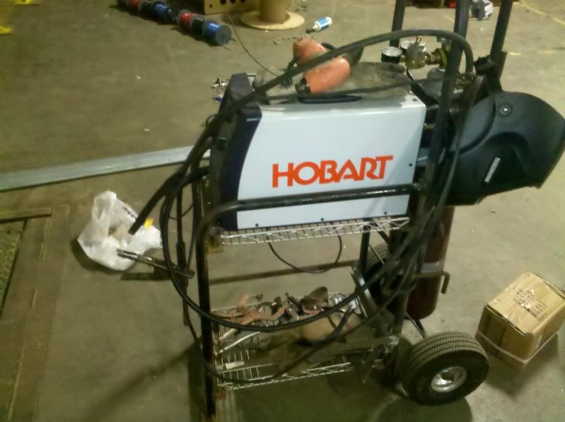

I got tired of dragging my cart around the yard to work on shit so I grabbed the moving dolly and some scrap pipe and shelf and built this in about an hour. Much better. Pretty sweet too because when you set it down it's not on any wheels and won't roll off. The hooks on the back hold the 50 ft extension cord as well.
