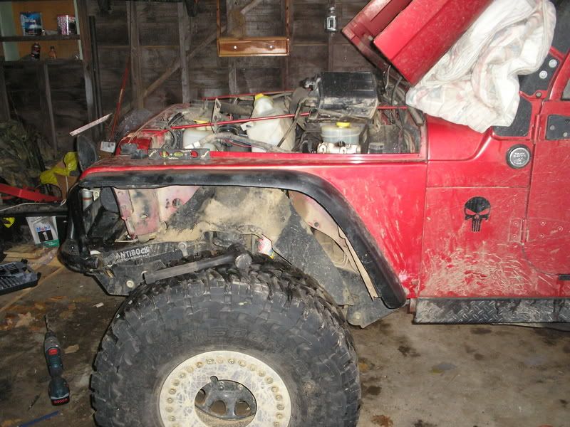

So I got bored today & decided to dive into this. Ive been contemplating it for awhile & broke out the wrenches today. Theres parts of this Im not 100% on, but figure I'll figure it out as it comes. I think Im gonna drop it down a couple of inches after its all buttoned up.
I started by popping off the fender

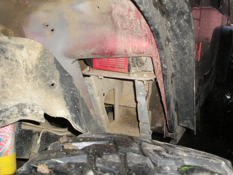

I then drilled new holes in the fender 3' lower. I had to cut out the rear, which ddint turn out as well as I'd hoped. Im gonna clean it up some, then cover it. You can see my cheapo compressor peeking out.

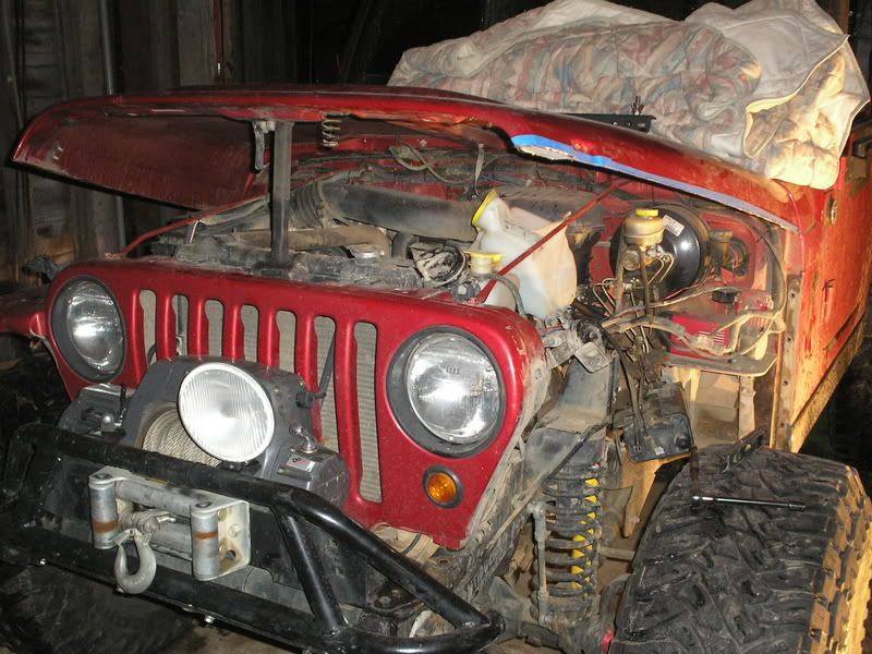

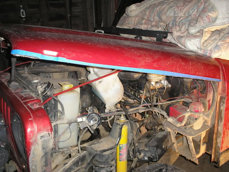

Then I taped & cutted the hood right along the body line
Here it is closed, I still need to 'finess' the fender a little closer to the body.

i did this with my yj also, no camera so i cant post any pics. its actually really easy. all it involved for me, was cutting 3" off either side of the hood, and re-drilling all the original mounting holes 3" lower. i scribed a line down either side of the radiator support on the inside of the fenders, and cut on the lines so i can still mount the fenders to the radiator support. i beat the front of the fenders to match the contour around the headlights, and i had to trim a bit of the battery box bracket off. all in all about 2-3 hours and a great look, and i have an extra 3" of room to flex on either side.

Cool :smokin: I like how you matched it with the upper body line. More pics! How are you going to finish the raw edge of the hood? Reweld the seam, or just door trim molding? It seems like it would be more rigid if you reweld the seam.

I may use an epoxy . . . Yep, door trim on the exposed edge. Gonna bump the fender up another 1/4 or so, so it matches the body line better, prolly at the same time I do my motor swap.

kind of a bad shot to show the fenders, but you can see them anyway. i removed the supports under the fender so they flap a bit when i run over bumps, but im going to replace them in the spring hopefully. they really do the trick though. ive got a 4" lift with 33's and before the mod, i would flex into the fenders...not anymore.

The passengers side was all in all a PITA, fenders bent & wont line up. Then I trimmed the hood too much, :rolleyes:
