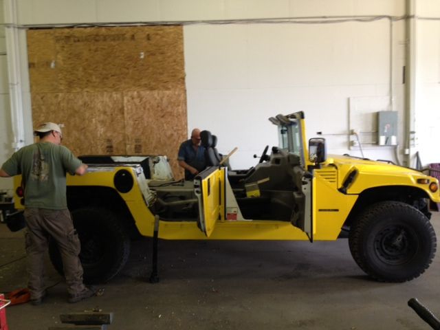

Disassembly time

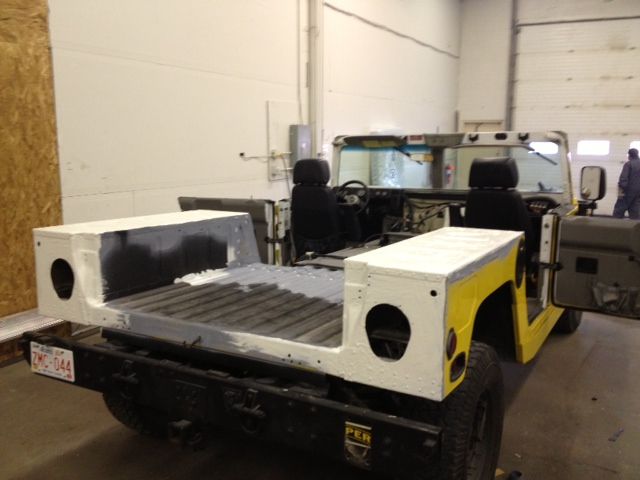

Torn down almost and readied for the new top. Body sealed wherever the new top covered with a thick layer of rv roof coating and then tar

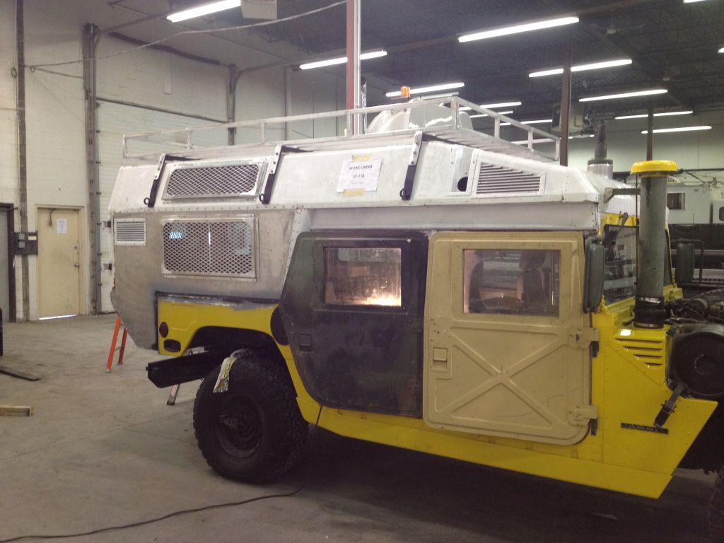

Mating time! what a pain in the ass!!!! The top is a modified M996 ambulance body. Modified to be completely open inside and 4 doors.

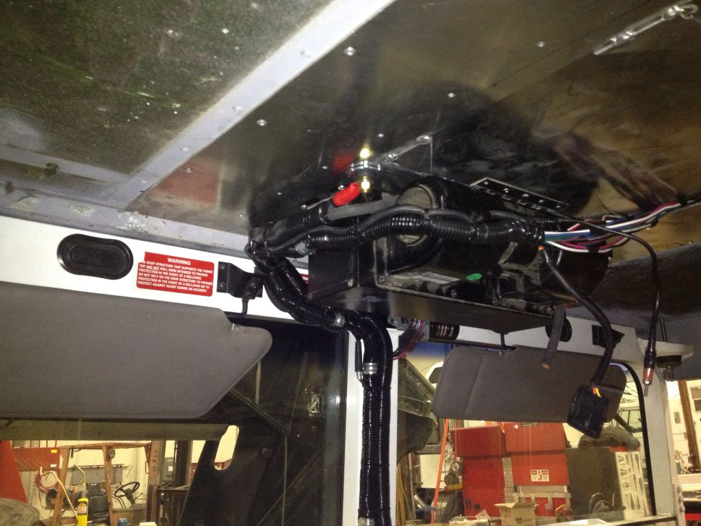

Over head glycol heater installed along with the wiring that I wanted transferred to the upper enclosure

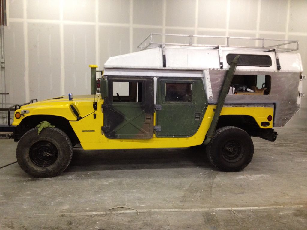

New old doors installed lol

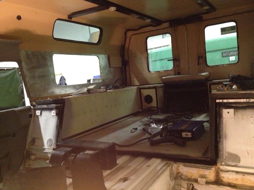

View from the rear doors looking in

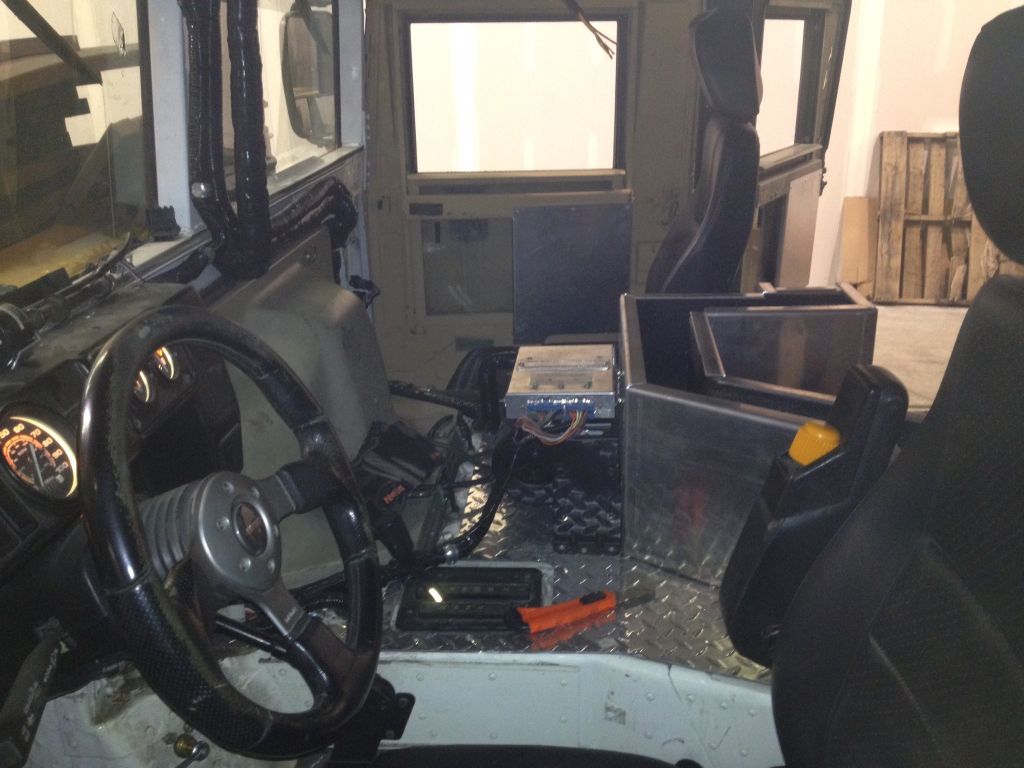

Interior shot. had to decipher what wire did what?!?
First H1 to have a glove box in the standard location lol

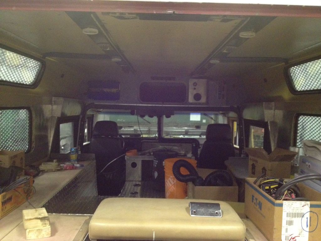

Cladding the interior
Almost completed the hvac system
Upper enclosure

View from the rear after paint
Left side view
