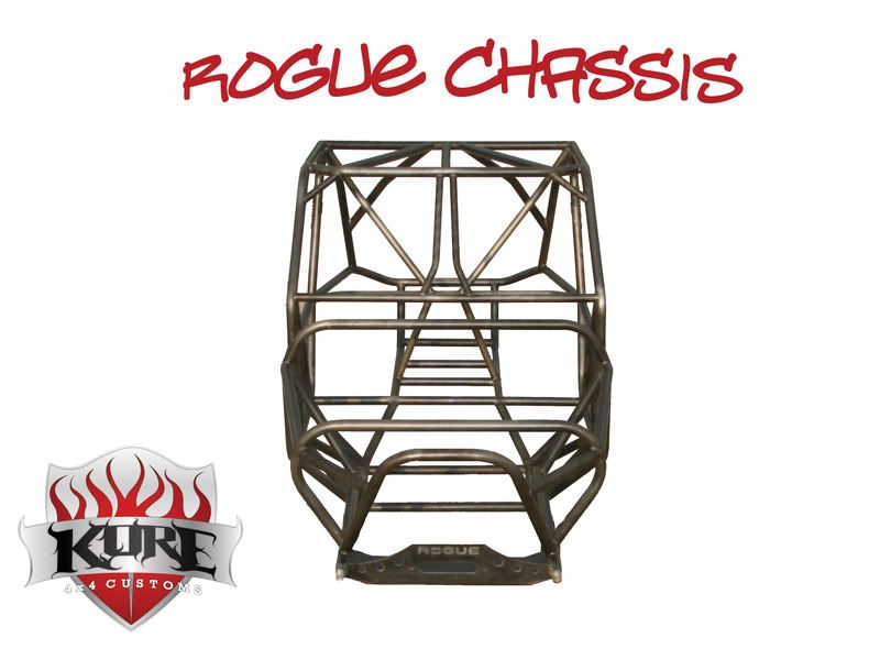

Introducing our New Production Chassis Line.....
The 2 Seater Rogue Chassis & our 4 Seater dubbed the Rogue Quattro
The Rogue chassis line is fabricated from of 1.75" x .120" DOM tubing with 1.25" DOM tube gussets to add strength in key areas. The Rogue Chassis is set up to use a FJ cruiser hood and grill.
A couple of features about our chassis':
- Each one comes with a built in winch plate & front stinger, what you see is what you get.
- Our Chassis has a subframe built in as a part of the chassis. No need to add that later. Just start mounting your drivetrain!
- Built in tow-points come standard on the front of our chassis.
- We have the exterior skins available to purchase seperately for our chassis. If you damage one & need a replacement, we can cut another on our CNC plasma table to make your rig look brand new again.
- Both of our chassis are 54" wide and are designed to use a FJ hood & grill combo.
- We have an entire line of brackets designed to be used on our chassis making setup a breeze. We also have certain locations built into our chassis for placement of these brackets.
- The boatsides on our chassis have two tubes on front & back that we place strategically for mounting the upper control arms to. They are angled to point the upper arms from the out side of the chassis towards the center of the axles.
- The front and rear tubes in our 'subframe' are 1.75" x .250" wall DOM. These are the mounting points for the lower control arms. On the front we suggest going with a slightly triangulated lower to clear the tires & on the rear, we suggest going with a traditional double triangulated setup.
Rogue Quattro Specs:
- Wheelbase can be setup from 110" to 130"
- Designed to use any combination of drivetrain
- The Rogue Quattro can accomodate 4 adult passengers with comfort and still have extra room for storage
- Priced @ $4850.00
Front Winch Plate
- CNC Cut & then formed on a Press Brake
Also included with the chassis are two front tow point inserts. Machined from 2" steel round bar they allow for a solid tow point for the front of the chassis.
2 Seater Rogue Chassis Specs:
- Wheelbase can be setup from 105" to 120"
- Designed to run any combination of drivetrain
- Accomodates 2 Passengers with room for storage in the rear
- Priced @ $3750.00
Turnkey Buggies & Rollers Available. Contact the shop for more details & pricing.
