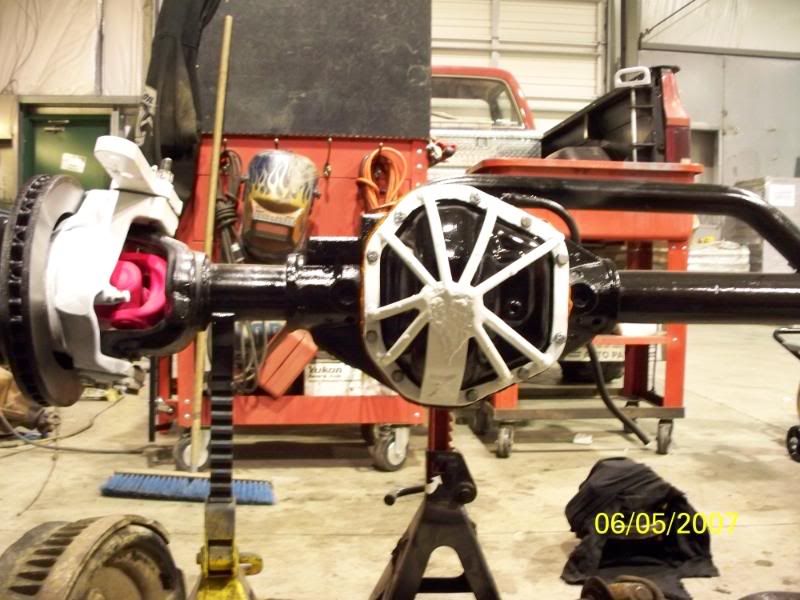

60front full hi-steer, custom diff guard
14ff rear detroit no spin
my own version of a doubler:flipoff2:
52's up front all hangers relocated

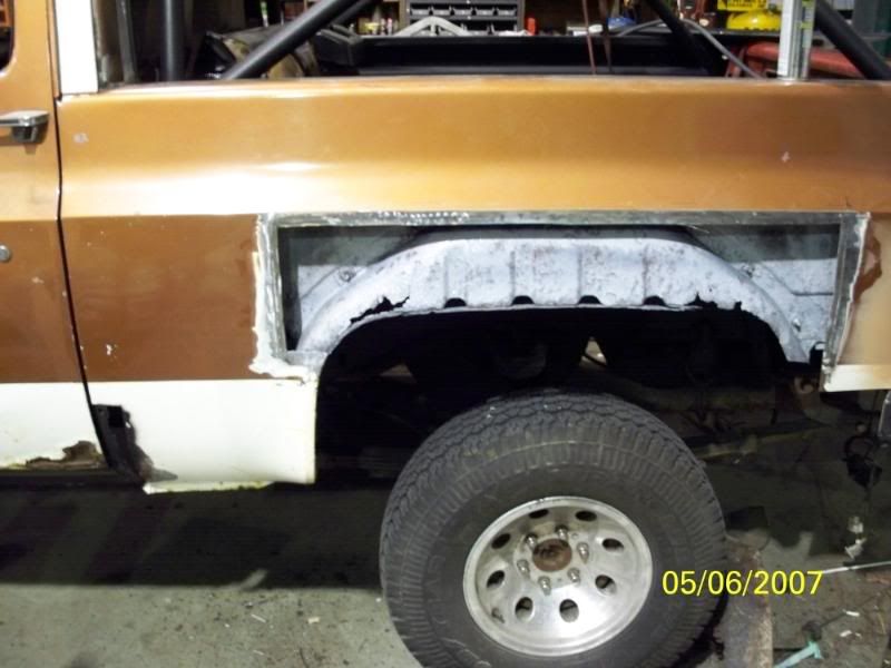

Fresh panels are nice:D
No crossmembers installed on the panels, so I built a sub frame out of a couple sizes of square and rectangle tube, 1/8th wall, and spot welded the floor down.
Had to fix a couple body mount holes, so I put in poly body mounts while I was in there.

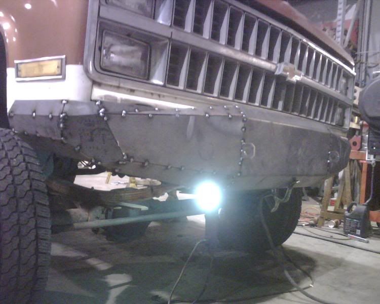

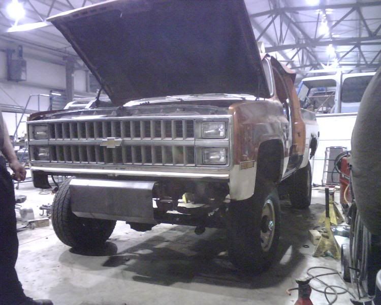

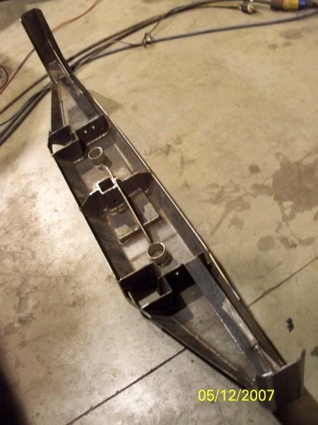

The mounts go about 12" along the frame, and through the plate to function as tow hooks.

And off the truck for welding and gusseting and winch mount
12,251 Posts

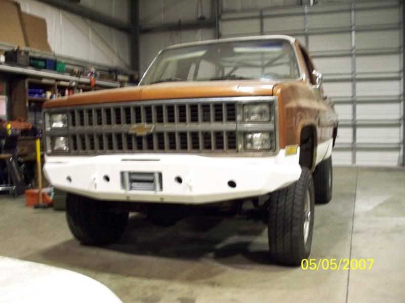

Discussion Starter · #9 ·

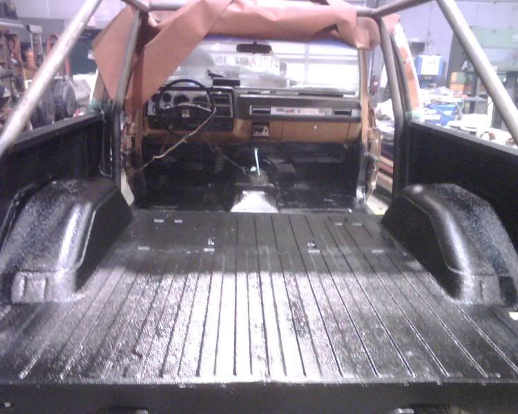

Rockerguard the interior,.......
And refit the bumper.......

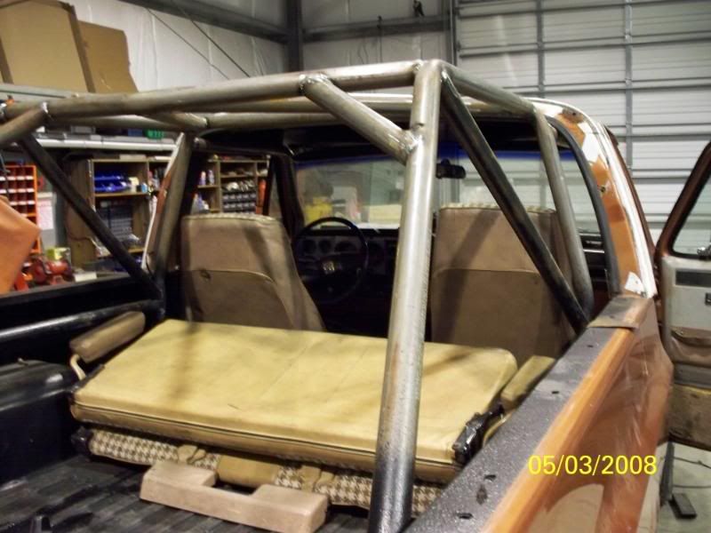

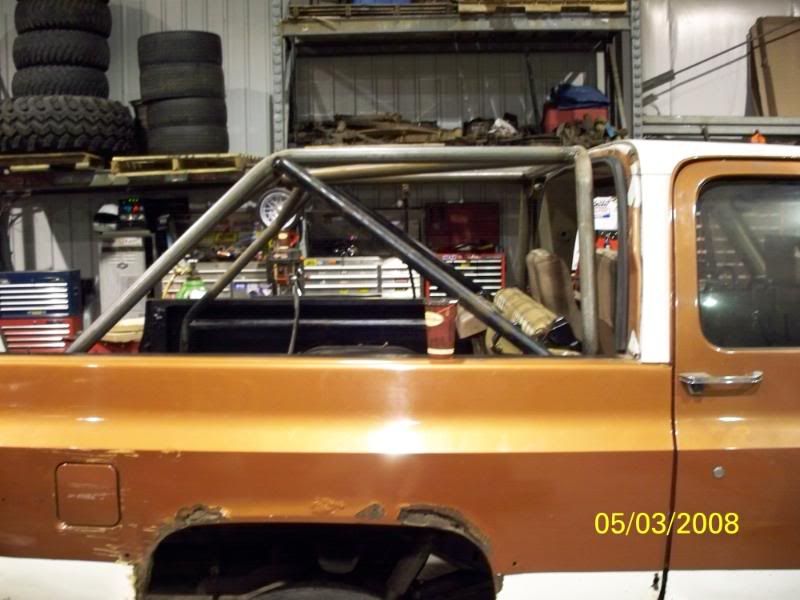

Discussion Starter · #11 ·
More...........It's out of my way getting in and out and the e-brake pedal is clear.
Cage is nearly invisible with the top on, super tight to the roof.

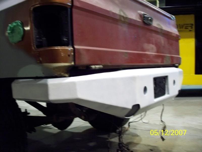

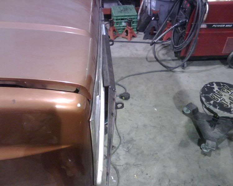

Started patching fenders, and building a matching rear bumper........
Hidden hitch with a flip up plate, cutouts for the exhuast to run through(I have square stainless tips when I get around to it.....) and holes for reverse fog lights.

Bumper back on and general overall......
Used a gm licence plate bracket(the flip kind) to cover the hitch.

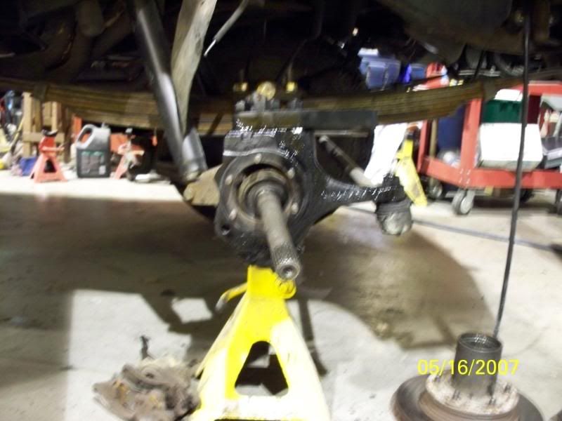

Unfortunetly, I decided that dune jumping was a good idea 15 minutes after I got there, so she came home in front wheel drive because of the only spare I didn't bring........A spare rear driveshaft.
I broke 2 more rear shafts on the street before I discovered the when I barber polked the rear shaft, it also fubared the np208s output shaft..........
Upgrades came quicker than I had hoped.

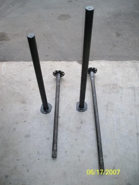

I'm working on storage for all the spare parts, (front and rear shafts, driveshafts etc.....)
and came up with this........Tubes for each, bolt throught the rear bumper and keep the spares clean and dry.
