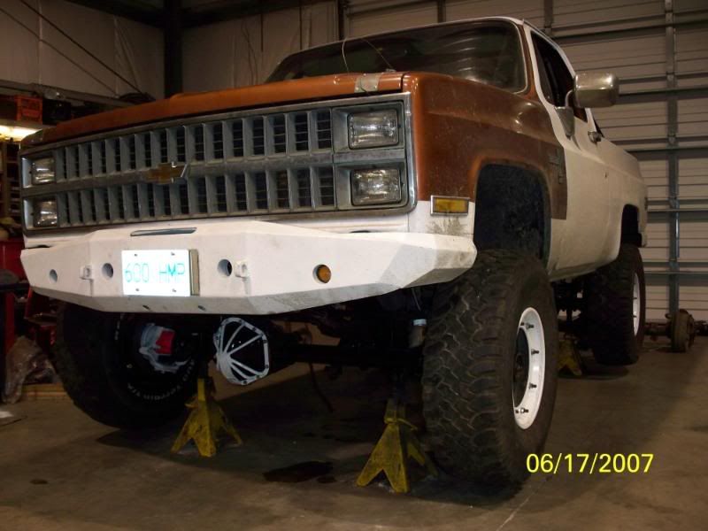

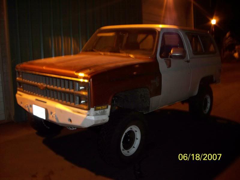

And how it rolled out at 3am, to drive to work at 7.......
I'm currently cleaning up my "doubler":grinpimp: from my other truck, which is going in ASAP, and just need to pick new tires.........Then it's into the woods.....

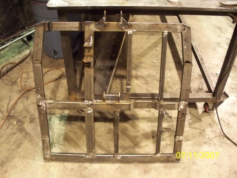

is there any reason besides foot room that you tied the front roll bar tubes into the pan where you did?
good to see someone renovating old steel, too. this is the way a build thread should be presented.
Thanks.
The reason other than foot room for putting the down tube there, is that the rear pads are allready drilled on the corners, have to do the front, but when I do, all 6 points are getting tied into the frame with bushings on the end. Up front that is the easiest place to do that.
The sliders are getting welded to the new rockers, and will tie into the cage through those pads as well, to prevent them from flexing up, so I wanted the mounts easily accessable, and in a spot easy to tie into the frame(away from body mounts).

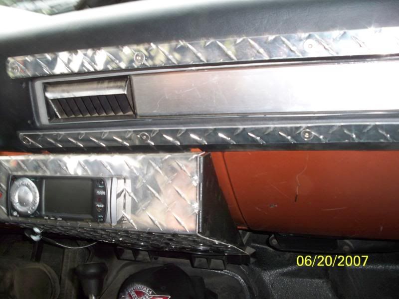

Relocated the deck, and got a DVD player with screen.......There's the bling:grinpimp:
It's got extra inputs, so I'm going to wire in some axle cameras front and rear.....
The stock location will get a stainless plate with in cab winch controls, and light switches.
Checkerplate and rockerguarded door panels....

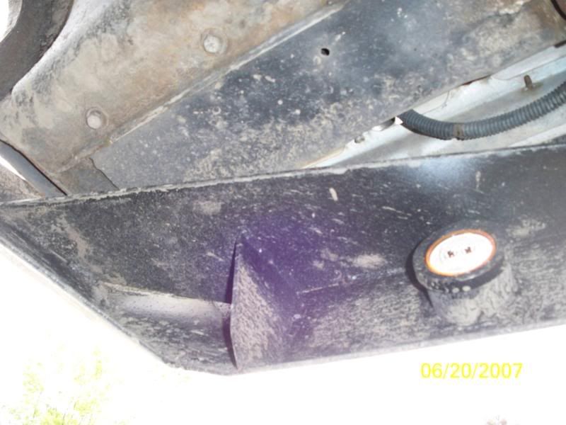

Here's the underside of the front bumper, you can see the marker light and grommet in the tube, and the gusset running to the outer edge it's also got vertical ribs down from the gusset.
You can see the gusset from the top as well.
2

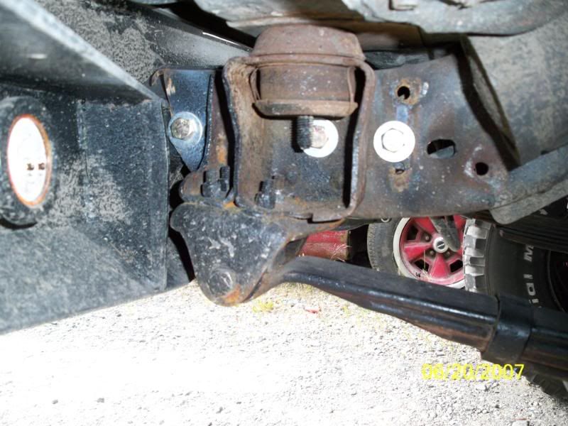

Here's the spring hangers, front is standard 52" spring swap, relocate using factory holes/hangers, been written up a dozen times.
You can see the factory shackle hanger rearward and lower, and the 7" eye-eye shackles.
The forward rear spring hanger, is the factory one moved forward, Found a bolt hole to line them up side to side, and they are welded and bolted. Same story for the rear shackle hangers, they're factory front somethings I found, and the boomerangs where hanging around from a buddies truck.

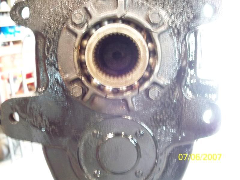

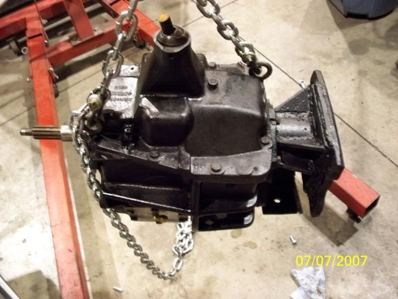

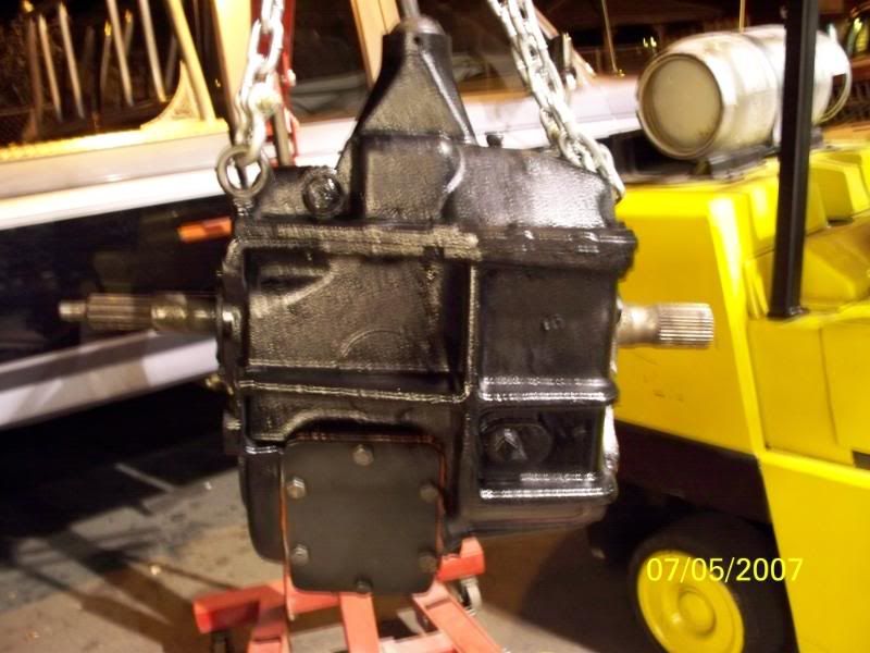

Built Pto covers out of 3/16 for all 5 locations, will be used as additional trans mounts, as well as croosover ports/sight tubes/fill plug in the t-case.
I got sick of luggin these around so I found some 3/8 coarse eye bolts threaded them to the top, and this way when they're ready to go in, they can be installed with a picker through the floor, or a snatch block off the cage.
The crossover and site tubes are pipe fittings, with compression ends, so the hose unthreads, crimped on some clear hose so everything is removable. Other that that pics speak for themselves.
I'm building the shifters for the trans and twin sticks tomorrow, should be installing the day after.

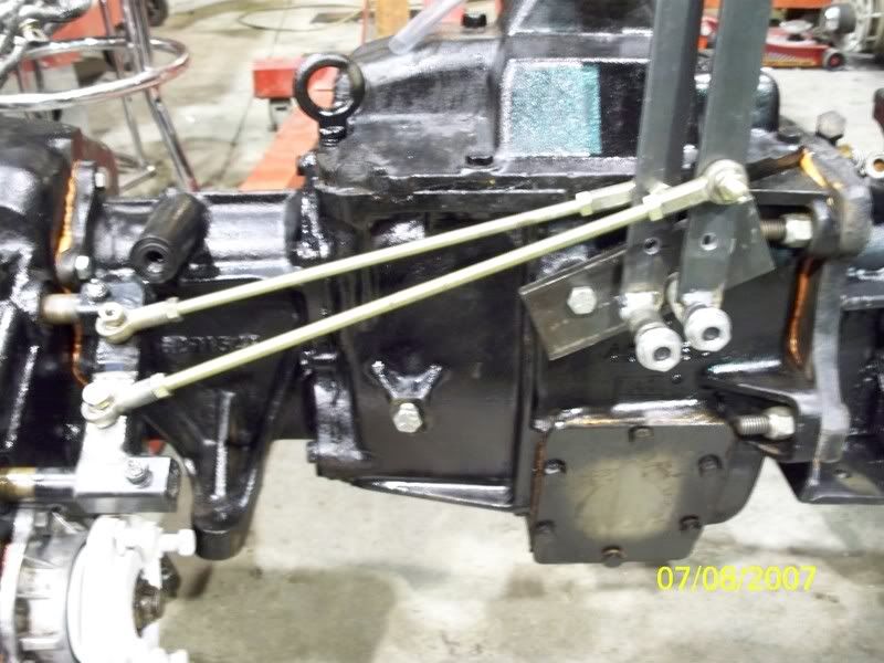

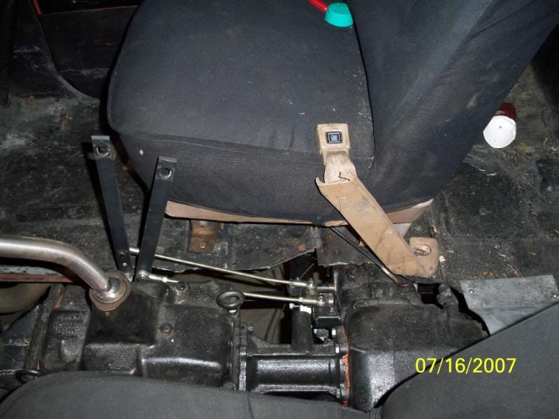

Speaking of, got the shifters pretty much in, just have to paint/tighten and add my breaker bar handles(been in every truck I built)
Plan is to throw all this in tomorrow.

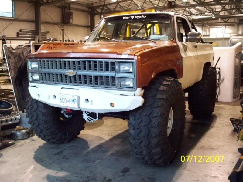

Got the trannies done, and decided last minute that we needed a big bad truck for advertising the local tough truck competition........Mine got voted and the 35's just weren't gonna cut it. So, whats the logical thing to do?:smokin:
I'll let the pics talk.......

So I got a few installed pics, if anyone wants a specific pic let me know and I'll grab it.
Nearly perfect smooth belly, the belly pan was flush to the frame, but I had to drop it and inch for the rear shaft. Pics pretty much show the rest, I'm working on a remote shifter from on here, and borrowing the high angle 1480 idea from someone.......on to pics.
Belly skid/crossmember out of truck, trans/t-case have 4 poly bushing mounts(end of trans, end of trans, pto on 2nd trans, and side of 205) I still have to chain down the pto on the 205.
Installed pics tell the story.
