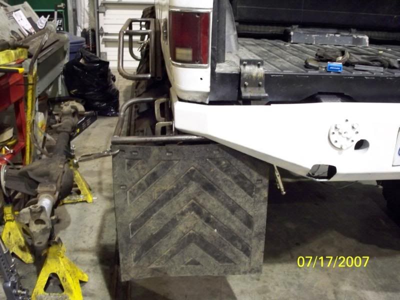

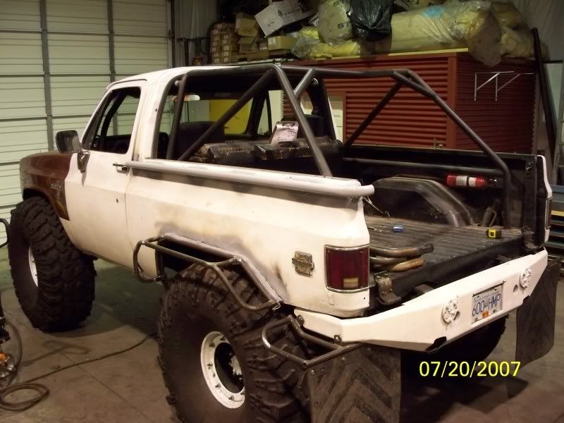

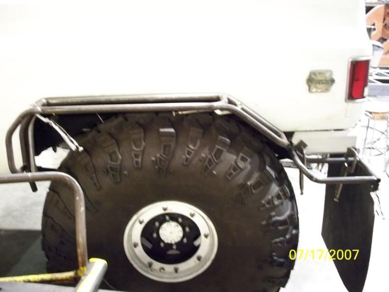

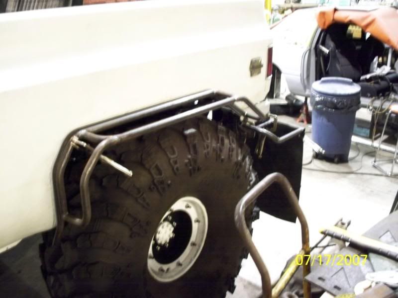

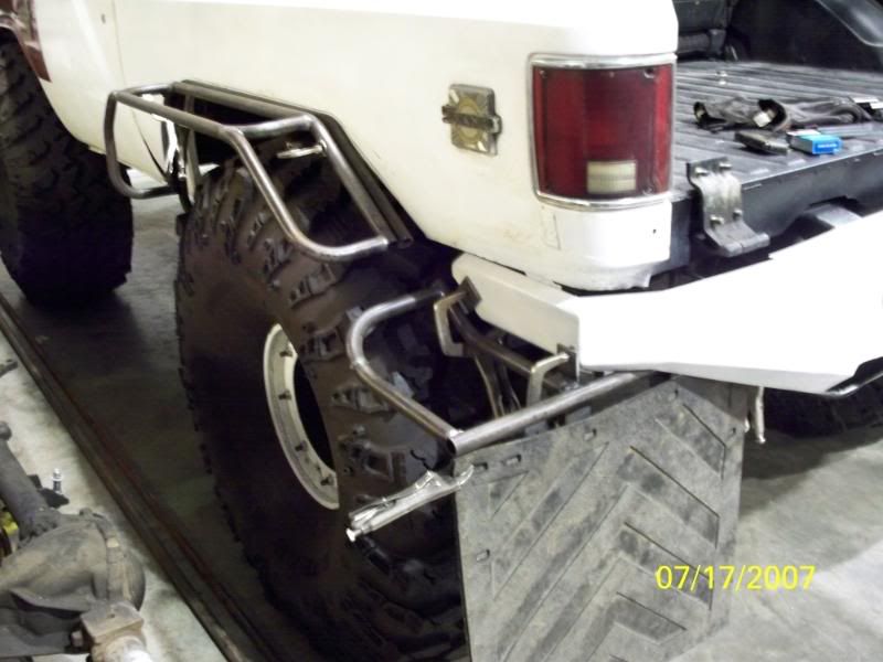

Started on the tube flares and mudflaps, still need to be sheeted, but they will be removable, the bracketry will brace the bodywork.
6
Got some more pics, first of are the flares and flap hangers on the floor, then the dr. side welded in, cut out to the shape of the inner tube, then welded the length. I'll brace them back to the body later. Next is with the flare clipped on, then how the removable works.:smokin:
4
Fender flares and mudflaps are on, just need to be sheeted.
We have a test for customers shit.......It's called the "Carl Test". Carl climbs onto whatever we're building and bounces. If it moves seperate from the truck it's not strong enough. Figured on my truck everything has to pass, so we tested it.......For referance, that's three hundred and, well, .....................We'll say 300lbs. Mud flaps and flares are good to go:smokin: and they still only take about 10 seconds apiece to remove.

1. LOVE the rear bumper and spare shaft storage setup.
2. I never thought mudflaps could be cool, but you surprised me.
3. I thoroughly approve of the "Carl Test"
Thanks
We like the carl test too:laughing:......I thoroughly abuse my junk, so if it won't stand up to Carl, I may as well not run it, and if it's leaving our shop, I like to be content that I would be willing to run it myself.:D

Got something else for ya'll that I haven't seen on a chevy yet........Through the body rub rails. Tie directly into the cage, and are fishplated to the body in and out. I'll let the pics explain the rest.
I've put those on all my trucks, so I've got a little practice, but I'd say about an hour........Kinda one of my trademarks.
I'd rather heavy and indestructable as possible on this one. I tend to break shit.......

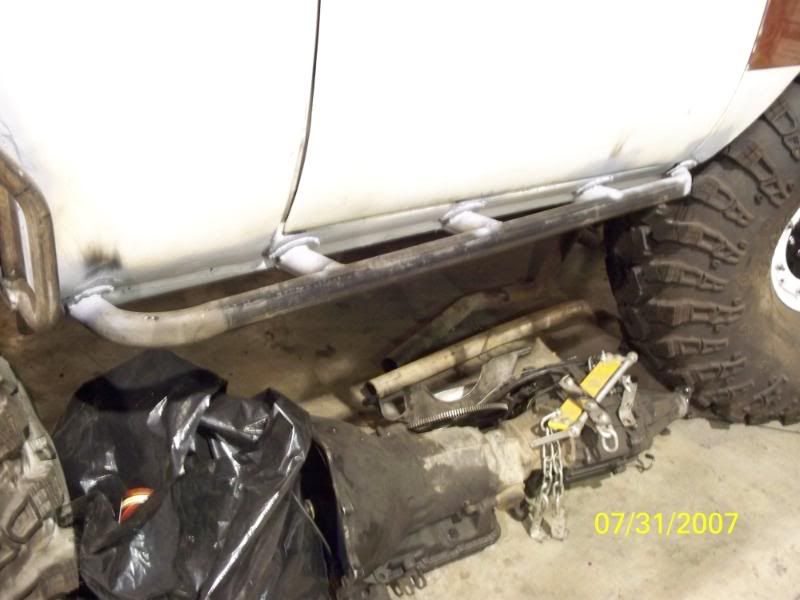

Got a couple mostly finished pics of the rub bars, the very front and rear braces are just plated to the body and the middle 4 go to the cage.

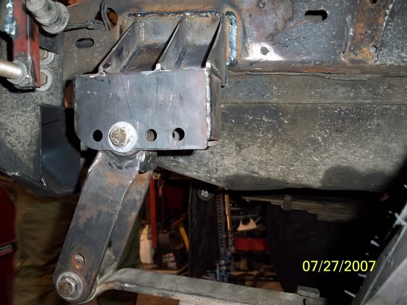

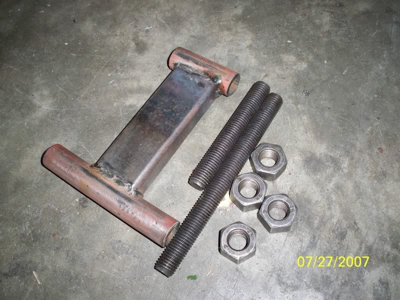

Other pics are of my almost finished shackle flip, I've had the shackles for a while, I built them and had them on my s10, and the hangers have 4 locations so I can tune the rear suspension depending on what tires I have on at the time, or how I want it to ride. I reworking the front and rear hangers right now, fixing the rear pinion angle and getting a little more driveshaft, about 2 more inches for the 49's. Once that's done I'm building some adjustable bumpstops, 1 location for the 49's and 1 or 2 more for other tire sizes.
I've also got a real trick tailgate going together........I haven't seen one like it, so I'm gonna call it an original. I'll snap pics of that in the next couple days.
3
Got my shackle flip brackets in and welded, and made a set of shims to correct the pinion angle. Welded the shims to the perches, and slapped on a truss in prep the the anti-wrap.

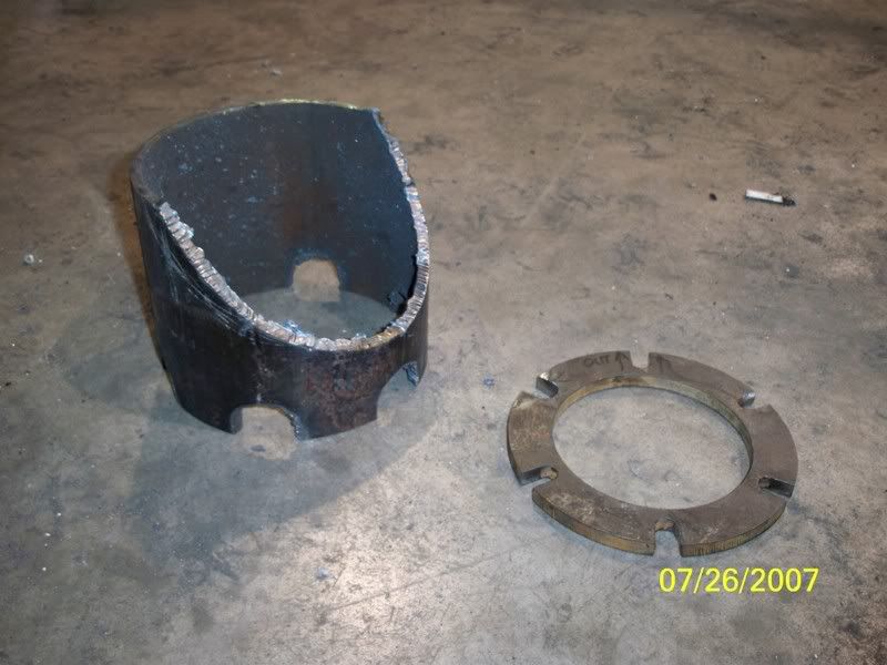

Built this while I was at it tonight, I have a major history of broken driveshafts, between this and the anti-wrap that's going together, I'm hoping to break the habit.

Tied the truss into the pinion guard today, to try to keep the tubes intact with the chunk, and finished a bunch of other welding. Shit should start moving really quick here again.
My antiwrap is actually going to tie into the tubes, truss, and pinion guard, from both sides. My pinion guard will take it, especially since it's got a 3/8" flange, the pipe is * I believe 6" sch40. The tubes and truss would likely hold it, but I've got it worked out so that the antiwrap will lie directly under the driveshaft and only lose minimal ground clearance, but only forward and up of the guard. It's got to be beefy to stand up to the 49's/400:1/250-300hp. Tires will go down to 42's or so, but I break a lot of driveshafts, Essentially, I'll have a 1-link on leaves. Should have pics of it soon.

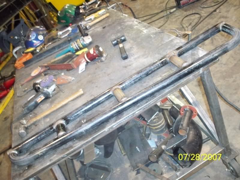

Started into the sliders, built on the bench, welded directly to the rockers, and fishplated for a little strength. Next up is how they tie into the cage through the floor and to the frame.
5
Sliders all welded up.

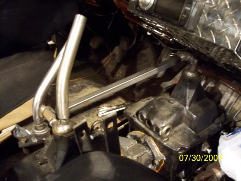

Got to screwing with the front trans shifter, it's a touch to sloppy to get reverse, but just needs some fine tuning.;)
