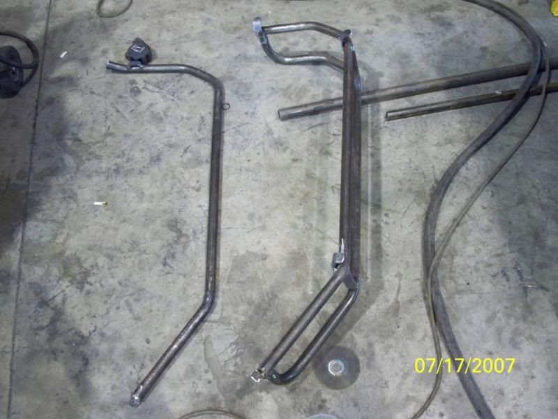

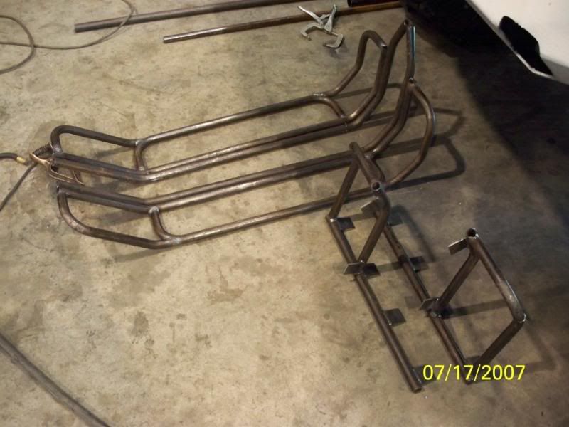

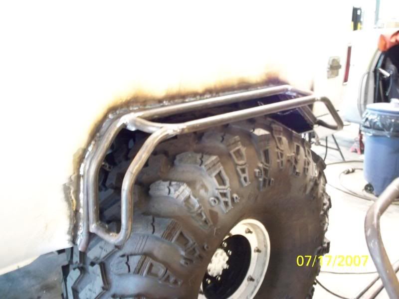

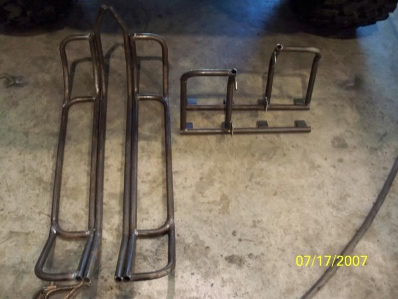

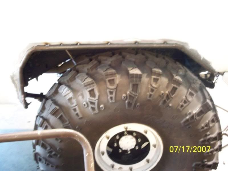

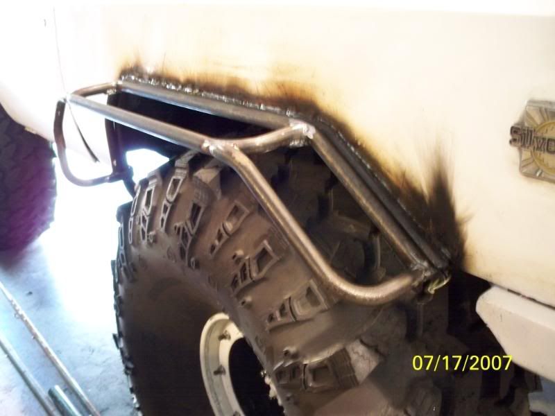

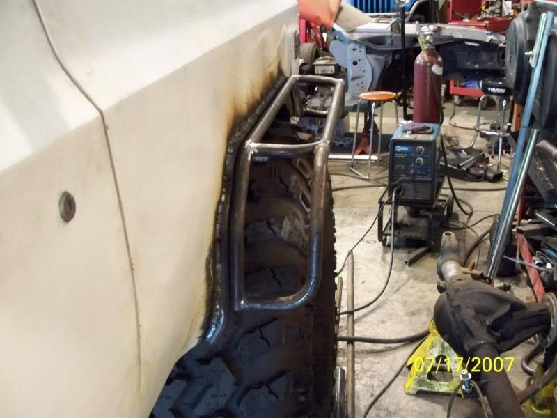

Got some more pics, first of are the flares and flap hangers on the floor, then the dr. side welded in, cut out to the shape of the inner tube, then welded the length. I'll brace them back to the body later. Next is with the flare clipped on, then how the removable works.:smokin:
6
Fender flares and mudflaps are on, just need to be sheeted.

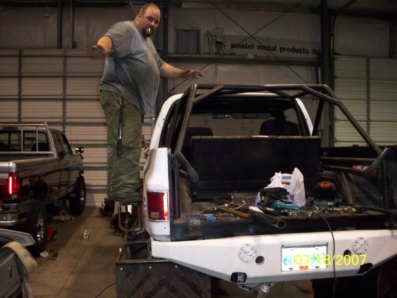

We have a test for customers shit.......It's called the "Carl Test". Carl climbs onto whatever we're building and bounces. If it moves seperate from the truck it's not strong enough. Figured on my truck everything has to pass, so we tested it.......For referance, that's three hundred and, well, .....................We'll say 300lbs. Mud flaps and flares are good to go:smokin: and they still only take about 10 seconds apiece to remove.
4

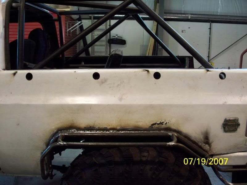

Got something else for ya'll that I haven't seen on a chevy yet........Through the body rub rails. Tie directly into the cage, and are fishplated to the body in and out. I'll let the pics explain the rest.
8
That is definitely a killer idea, Looks good man, keep it up.
NICE WORK MAN!! I DIGG THE FRONT AND REAR BUMPERS IM STARTIN ON MINE SOON BUT IM AIMING AT SOMETHIN MORE BASIC. 3'' tube steel deer masher:mr-t: with room to stand on, bla bla. anyway NICE WORK, HOW LONG DID IT TAKE TO FAB THE D60 guard? PRETTY SLICK!
I've put those on all my trucks, so I've got a little practice, but I'd say about an hour........Kinda one of my trademarks.
