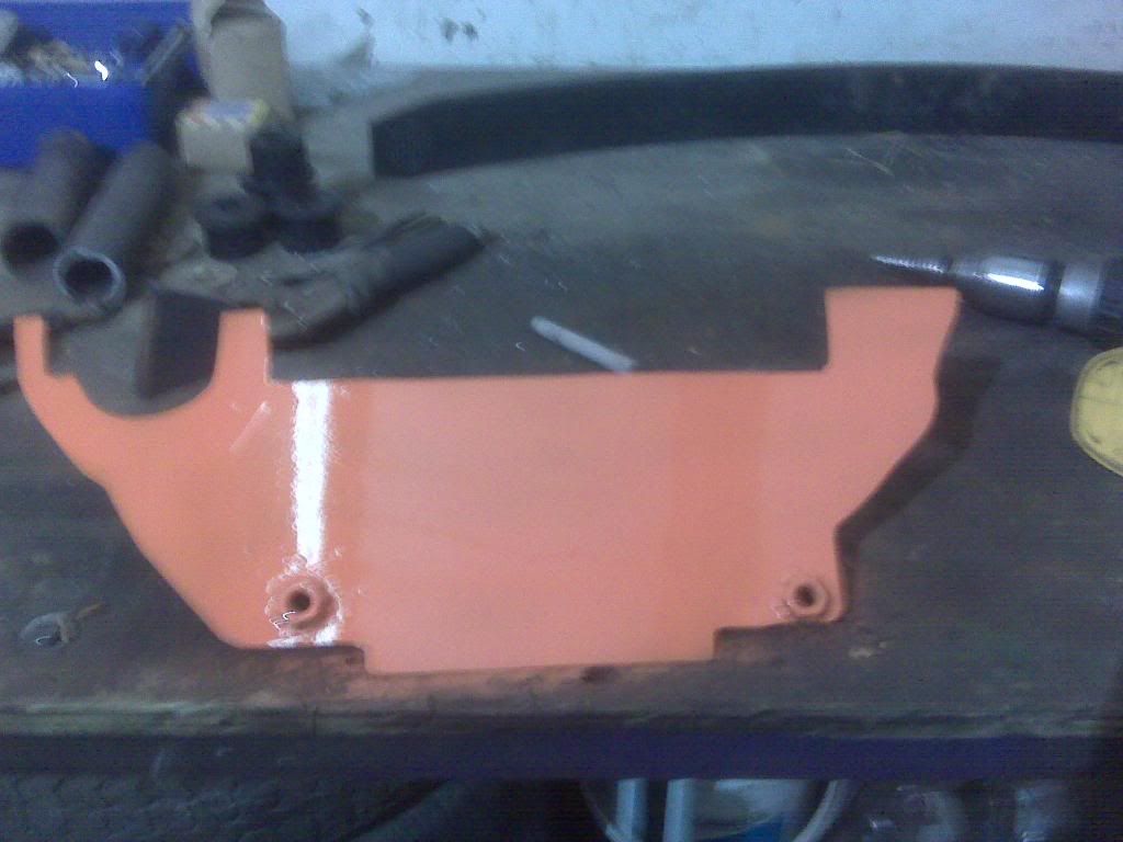

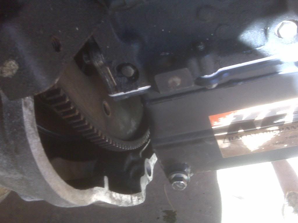

I picked up Kevko pan to help with the oiling issues on my 6.0. The problem is the factory pan is cast to fit the bottom of the tranny. when the Kevko pan is installed it leaves the front of the transmission exposed. I made a plate to cover the area. I think it will work fine. I was curious if there is a better way to overcome this problem?
Pan installed
Fabbed up cover. Attaches with two original bolts and pins behind starter on passenger side and tabs on other side.
