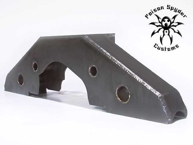

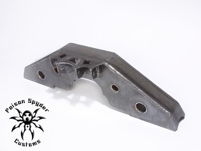

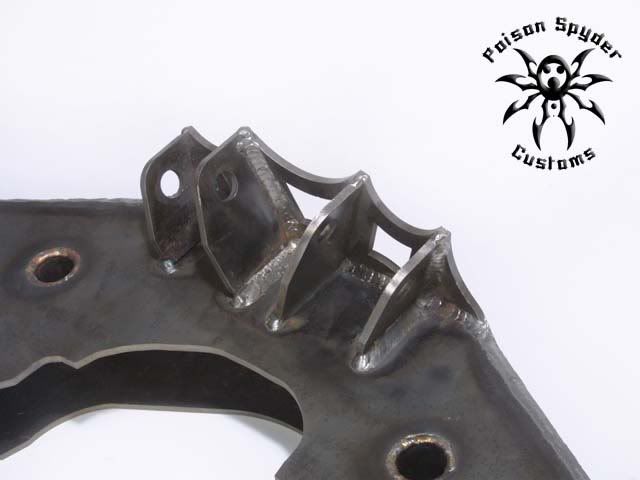

My neighbor has some mad fab skillz. He is gonna help me long arm my 04 Rubicon. What I want to do is use my exsisting Johnny Joints from my Currie Short arm kit and a mixture of Poly Performance and Poison Spyder parts.
To start I want to cut and sleeve my exsisting control arms and make them long arms. Then I want to use Polys' control arm mounts at the frame and Poison Spyders truss on the rear diff. I plan on using my coils and shocks I'm runnin now. In the future when I have more funds I'll push the rear end back, move the gas tank, and add coilovers.
Any input?
Thanks
DJ
1,879 Posts
Check out some of sniperfabs brackets and their rear truss.
Mr. DJ
20,843 Posts
nice stuff, didn't find a truss for a 44 though.
plus, i don't think i want my diff cover to be part of the truss.
Mr. DJ
20,843 Posts
Probably should clarifi I know BFH knows what I have, but. 04 Rubi runnin stock 44 axles with 5:13's Alloy USA and CTM in the front, and 33 splinned Superiors' being turned by a Detriot in the rear. I have a Nth belly pan and Tom Woods in the back. See sig under BUY MY JUNK for greater detail....
I've reforced my lower control arms. Should I even consider keeping them?
