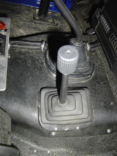

So I broke an axle on Saturday. It sheared off flush with the birfield. after I fished the stub out of the birfield I was trying to figure out whatI wanted to do with the broken piece. Then I realized I hadnt put a shifter knob on my t-case shifter yet. Bingo, broken axle on Saturday, shifter knob on Tuesday :p

help a rookie out and please give me the run down on how you got the inner snap ring off that or how you got the stub out ?
1,291 Posts
If an axle shaft is broken up by the birf, you can spin out the inner cage and pull the balls out of the race.. Then tap the shaft out backwards not having to remove the snap ring. It's all actually in the FSM cause my description sucks.. You also sometimes have to do this if you have an inner that's torqued the splines and then won't come out of the birf. If you have a birf that's attached to an inner shaft and a piece of scedule 40 pipe in a vice you are normally golden on seperating the 2.. Watch your toes tho..
you got it ;)

You can barely make them out, but they're on both shifters. HURTS like hell to nail your elbow on one!
