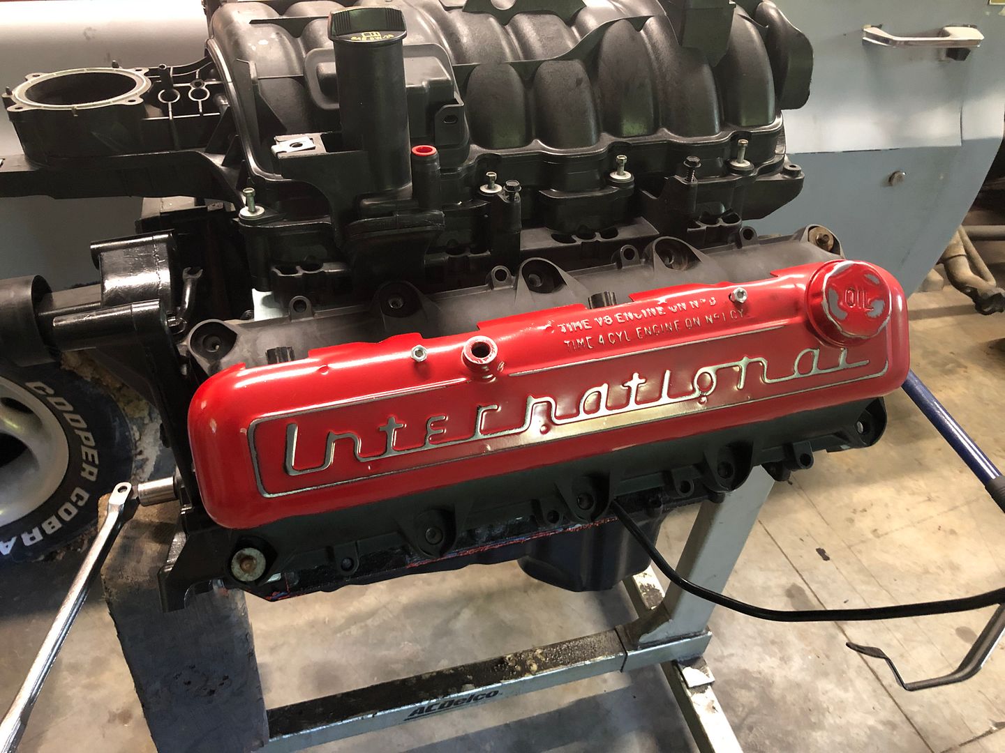

ARP head studs went in, heads on, and chromoly pushrods in. I decided to use the stock valve covers as coil covers to get a little old school look to the engine bay. I sandblasted them after trimming things, primed/painted them, then took sandpaper over the script to bring out the bare metal. I wiped them down and used 3 coats of clear.

Man I'm digging the coil covers!! Might have to be in the to do list for me!! :smokin::smokin:
