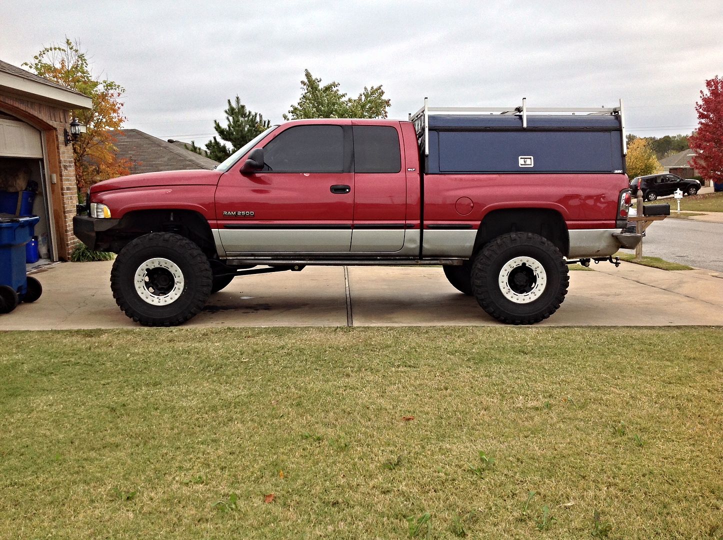

When I first got the truck, it definitely looked pretty rough. Had some oil leaks, and a big trans leak. Here's a pic:
Can't see it from this angle, but the passenger fender was caved in pretty good as well.
First thing that I did was cut the rear exo off and remove the topper. Not a fan of the mid-top or high-top shells. Then fixed the big transmission leak. It ended up being a torn shift tower gasket. Filled it back up with the Mopar liquid gold, and it hasn't leaked since.

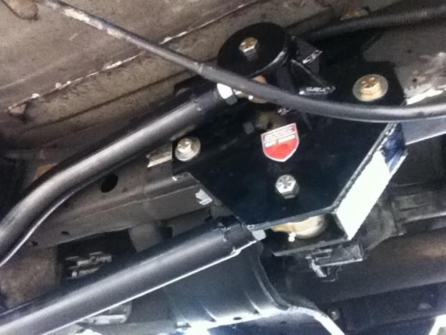

My setup isn't typical by any means, and I believe it's one of a kind at this point. However, after some trial and error during my install, I would say that it's now a ready-to-order combo and would make a LOT of 2nd gen guys happy.

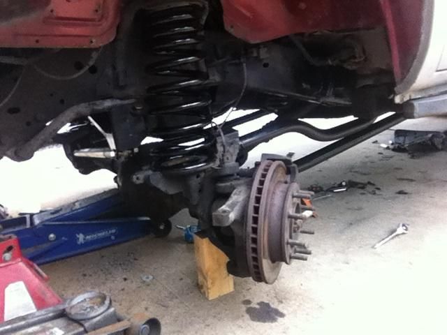

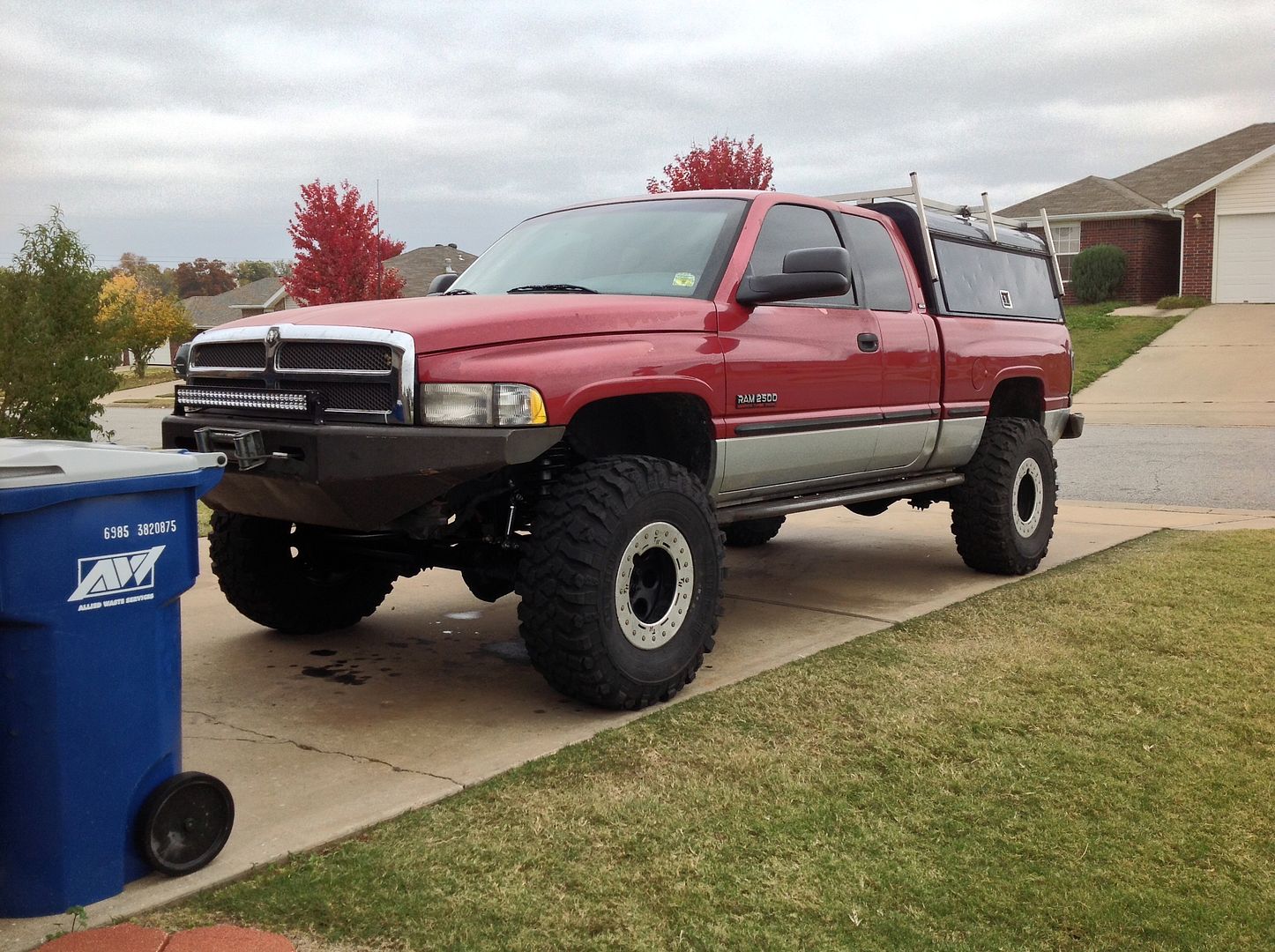

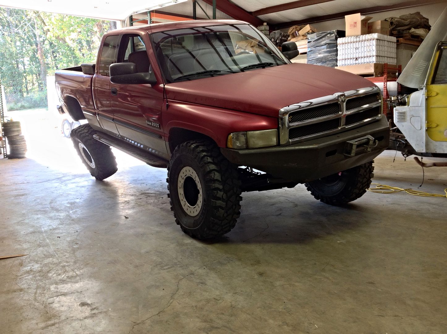

Here's what I ended up with:

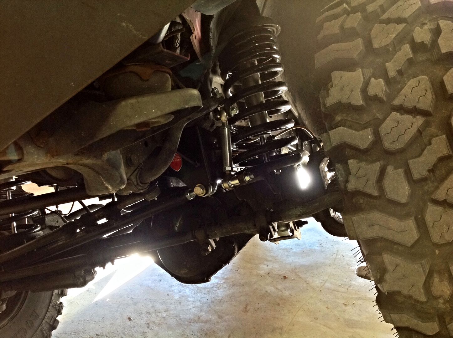

Full D.O.R. Long Arm Setup
2" x 0.25" DOM Control Arms - Bent for body mount AND tire clearance
2.5" Progressive Coil Springs
Drop Trackbar typically used on 6-7" lifts
Drop Pitman Arm
Front axle pushed 1.75" forward
Swaybar Links
Shackle Flip - Factory block removed - Nets 1.5" rear lift overall
U-Bolt Flip
Fox Shocks all around
The install requires cutting off all of the old control arm mounts on the frame, trimming some of the floor pan (lower skin, doesn't protrude into cabin), modifying a couple body mounts, cutting off old shackle mounts...ect.
So why spend all of that time/money for the same lift height as you get from the typical "leveling kit"?? :flipoff2:
Performance. This is the best driving truck that I have ever been in. From cruising around town, to interstate driving, to pounding dirt roads, to catching some air while ripping across a field at 70+mph.
No issues putting all the power down on any terrain.

The drop trackbar and drop pitman arm make for near perfectly level steering angles, which gets combined with the 98-99 HD steering parts. It's impressive, as there is ZERO bump steer/wondering with this setup. Just what I was hoping for.

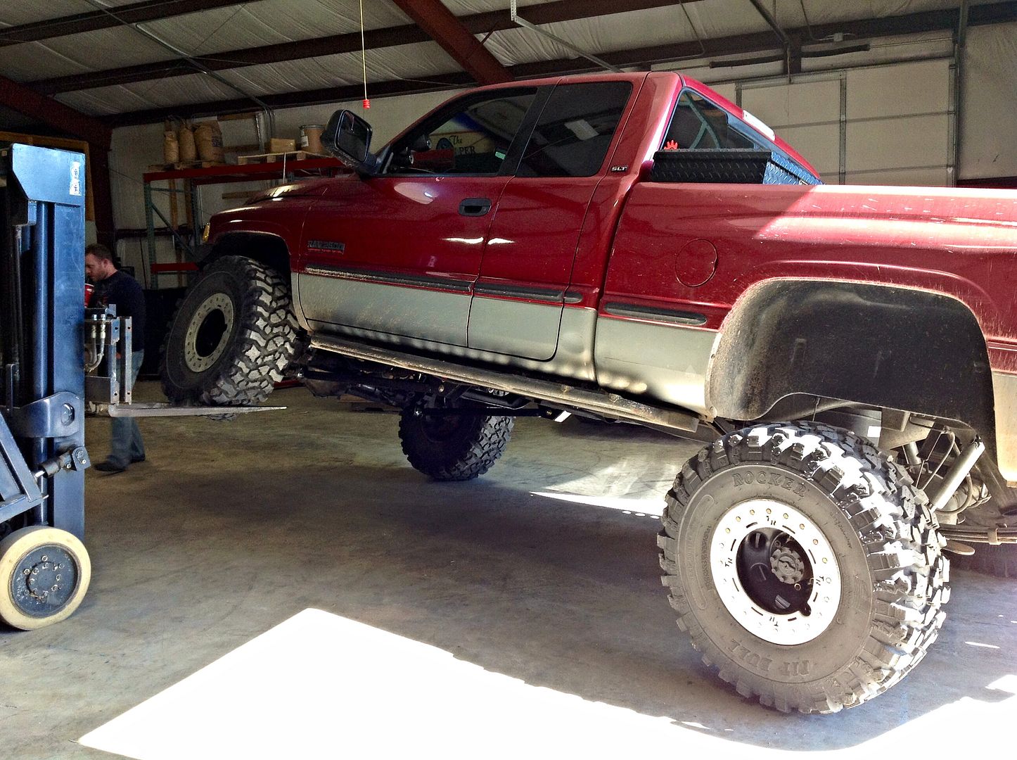

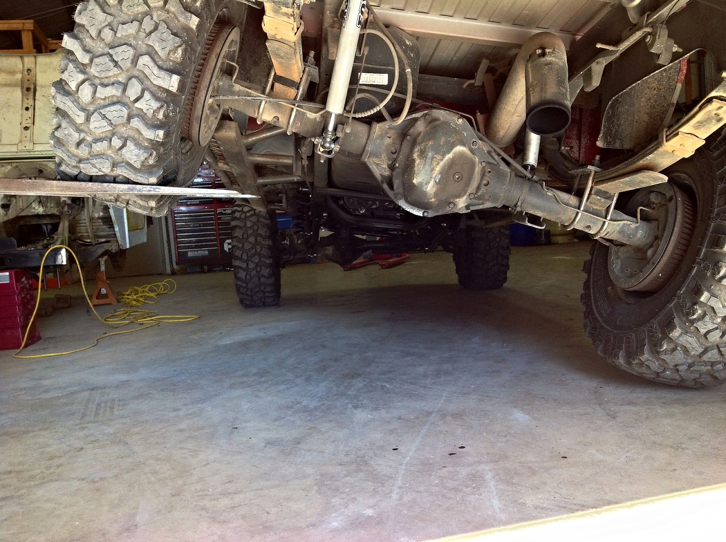

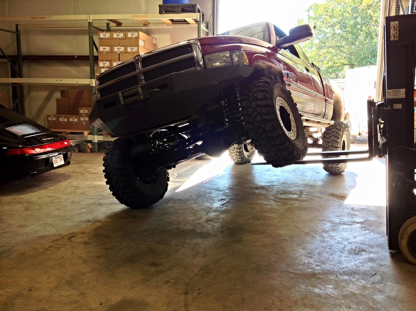

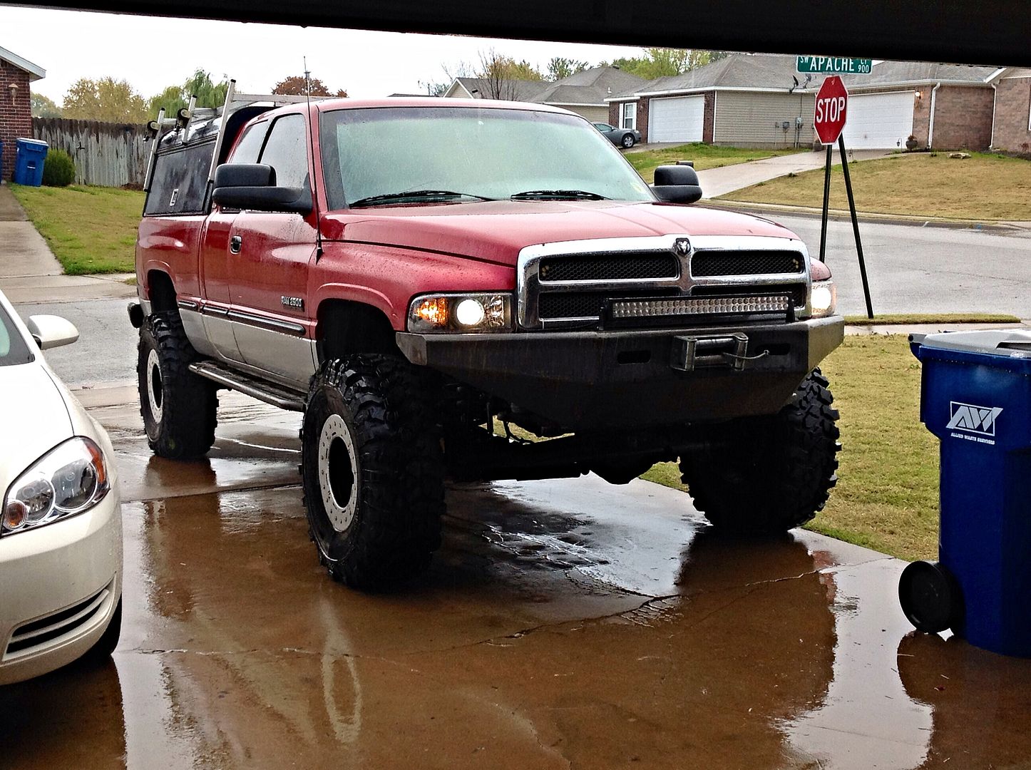

Drove it around for a few days to get everything settled in, and then put it on the forklift to check for clearances. Everything clears great. If I wanted/needed more front flex, I could always disconnect the sway bar, but it will be attached 99% of the time.
The rear shackle flip works great. Allows the springs to work "easier", and smooths out the ride. I've towed with it, and have noticed no issues with sagging. What I did notice, was a big improvement with axle wrap! Removing that big ol factory lift block helped a LOT. Taking off with a 10k lb trailer is nice and smooth now.

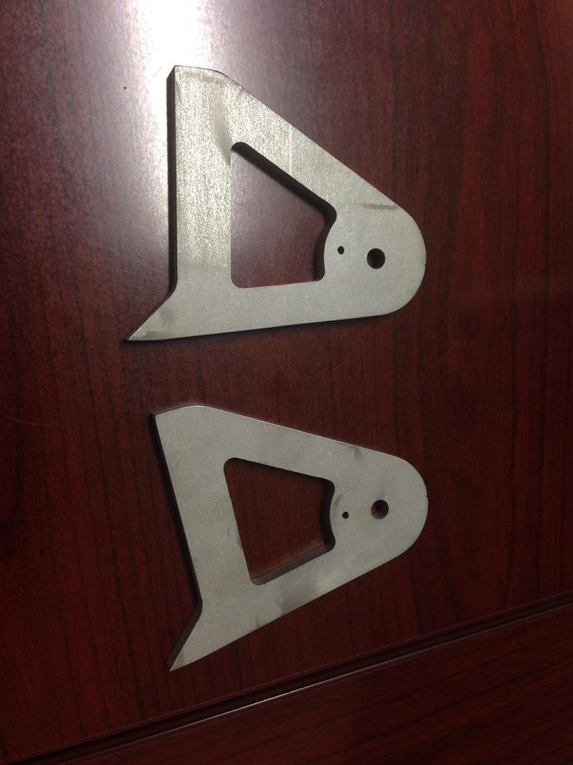

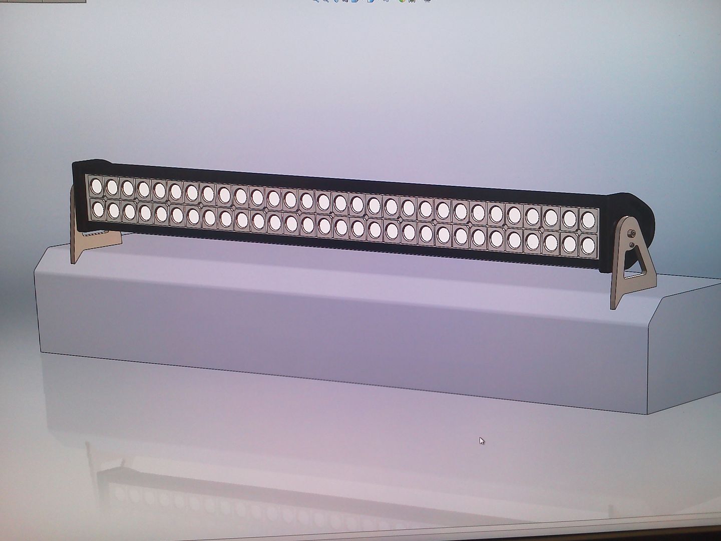

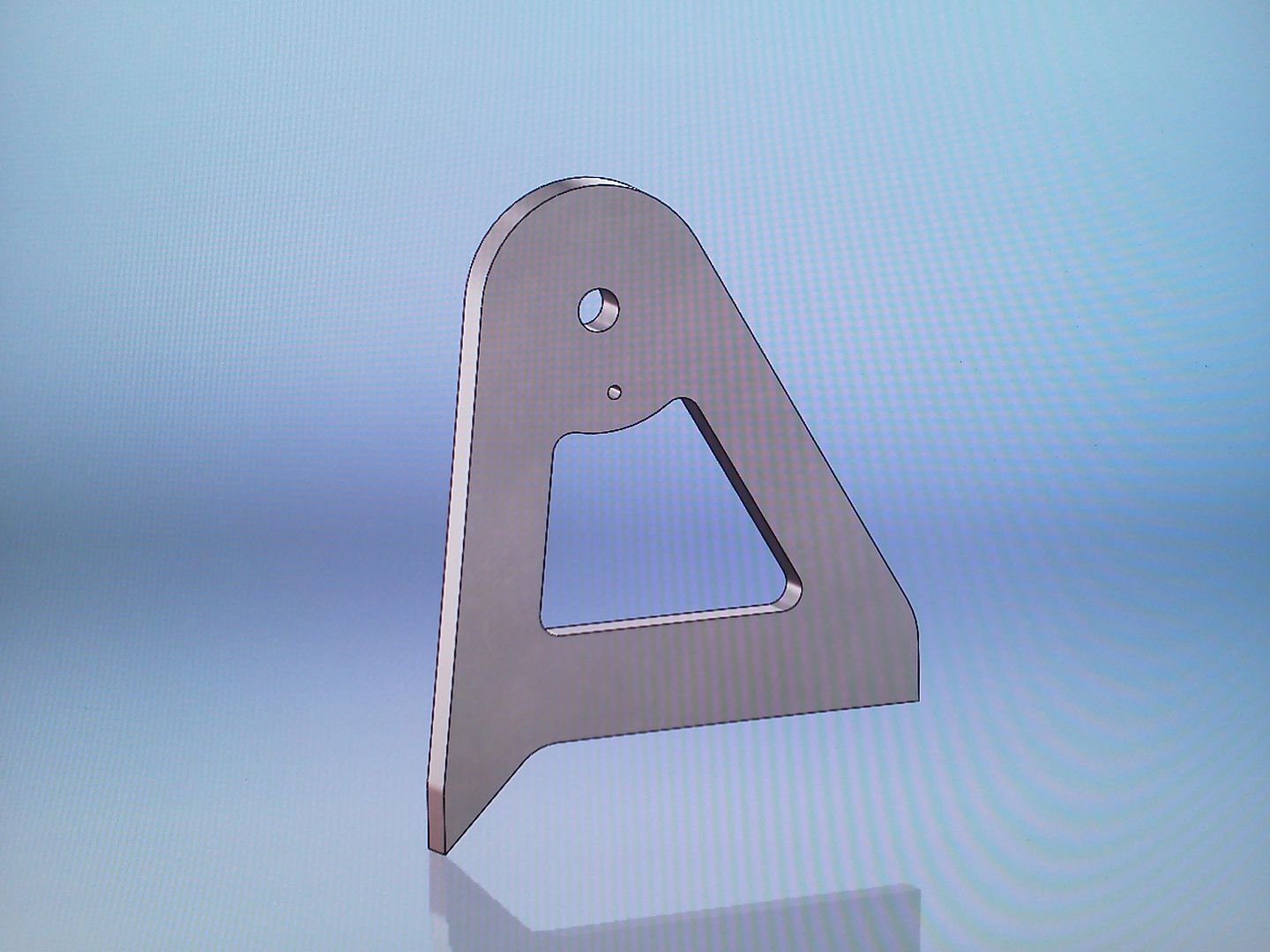

Picked up a 32" LED Bar for the front bumper.
Not crazy about the mounts that they come with, so I drew up some new mounts that will weld to the bumper and position the light bar a bit farther forward than I could get it with the included mounts.
The bar itself is ridiculous though. TONS of light from this thing.
Cut out on the waterjet:

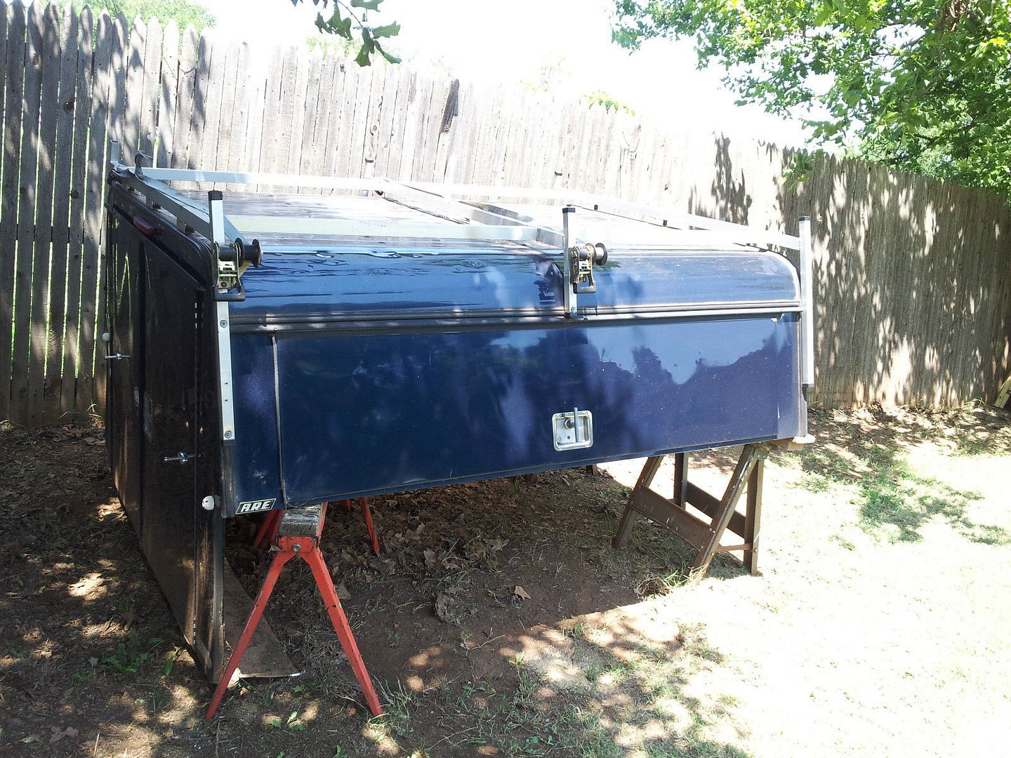

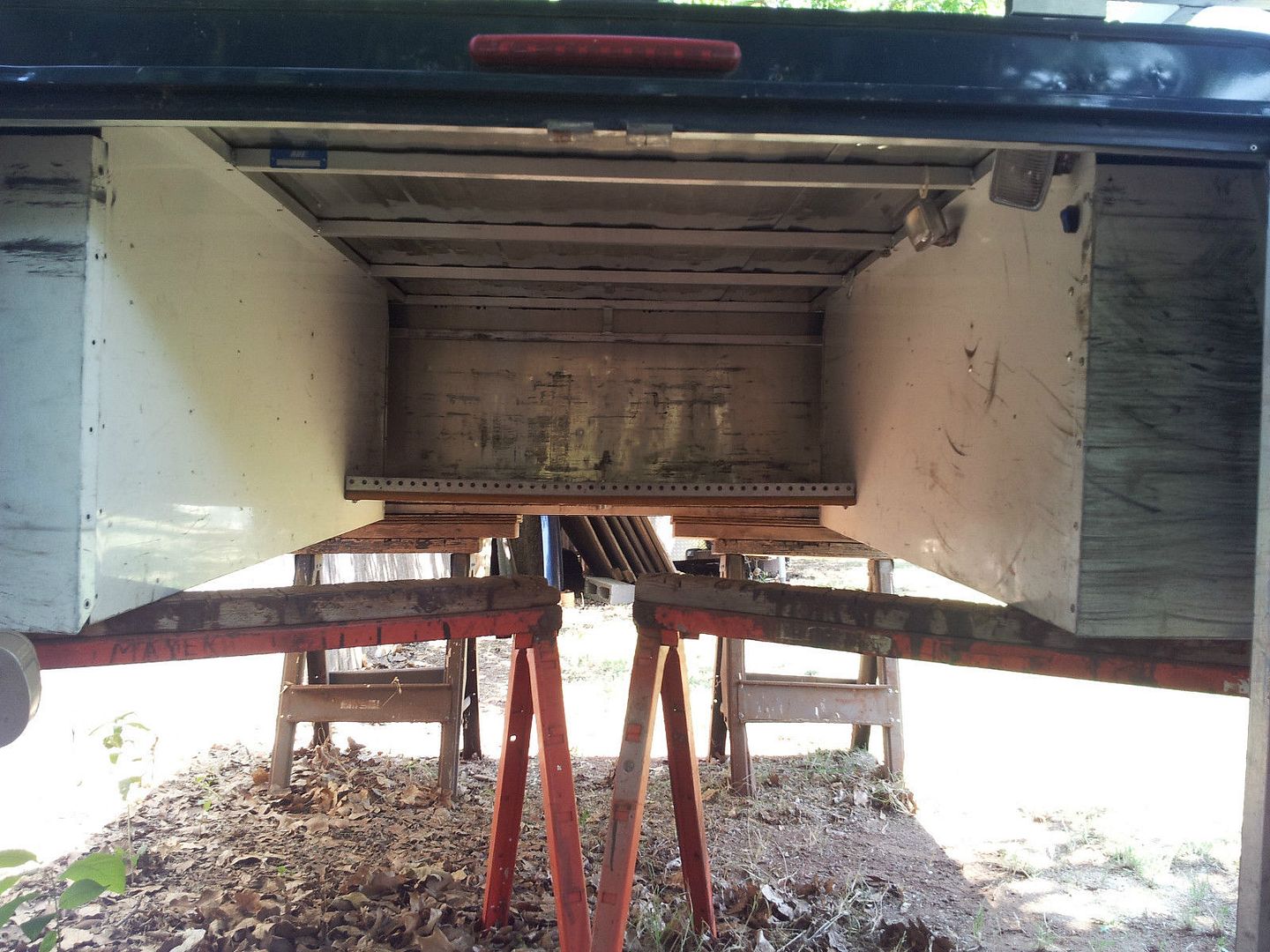

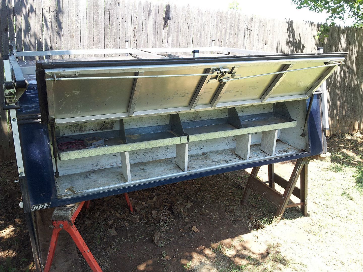

Also found a good deal on an ARE DCU Topper (Tool Shell). These are really hard to find around here for a short bed, but I lucked out and found one on ebay that was within driving distance. It was also made for a short-bed ram, so that was good. It had, however, been through a hail storm or two, and the color doesn't match.
I plan to bedline the entire topper with some Al's in Black. That will cover up the little hail dings and make it look a lot better!
1,301 Posts

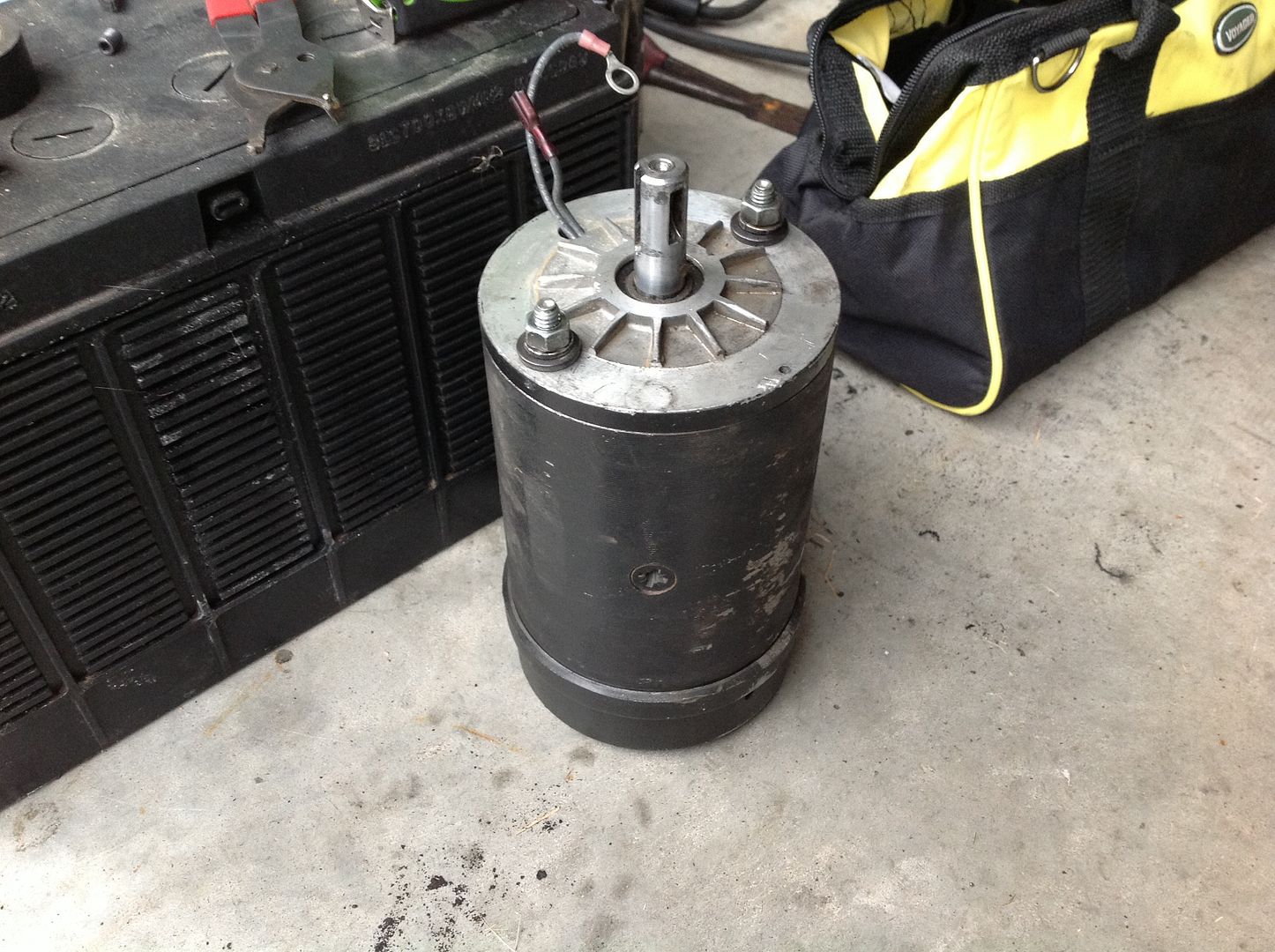

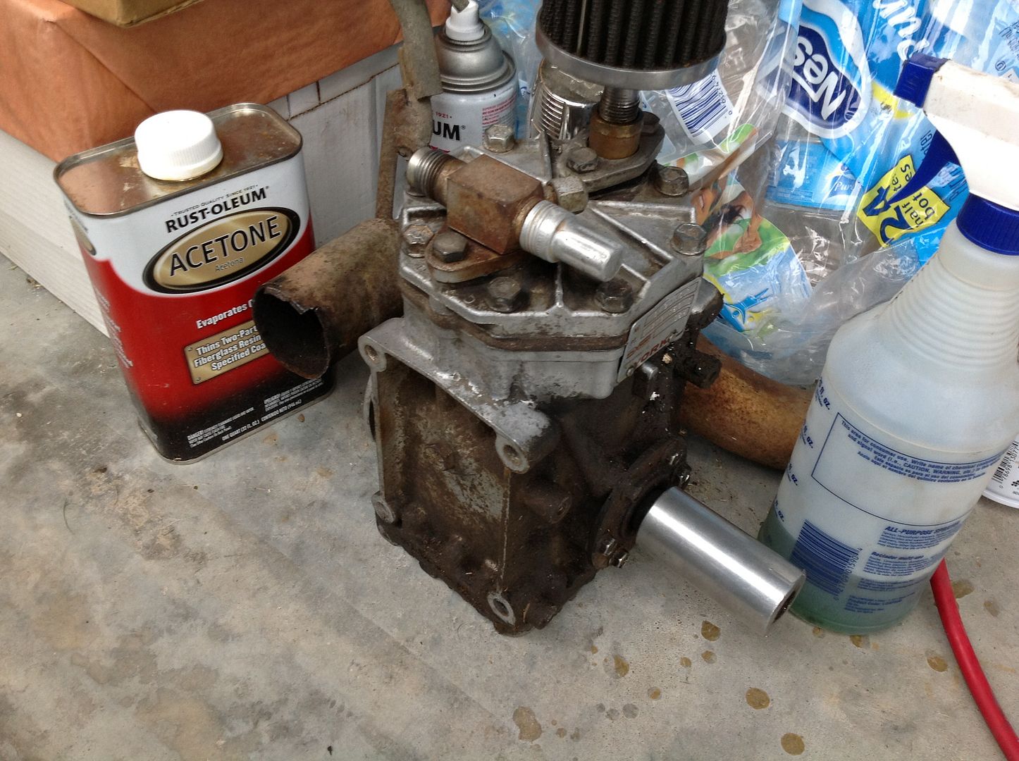

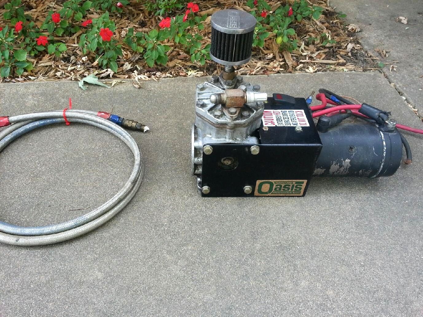

I've got pretty big plans for the topper. I intend to have a nice on-board air system, air hose reel, power inverter, extension cord reel, extra battery...ect. Also building a new roof rack for the shell that will have a bunch of features as well.

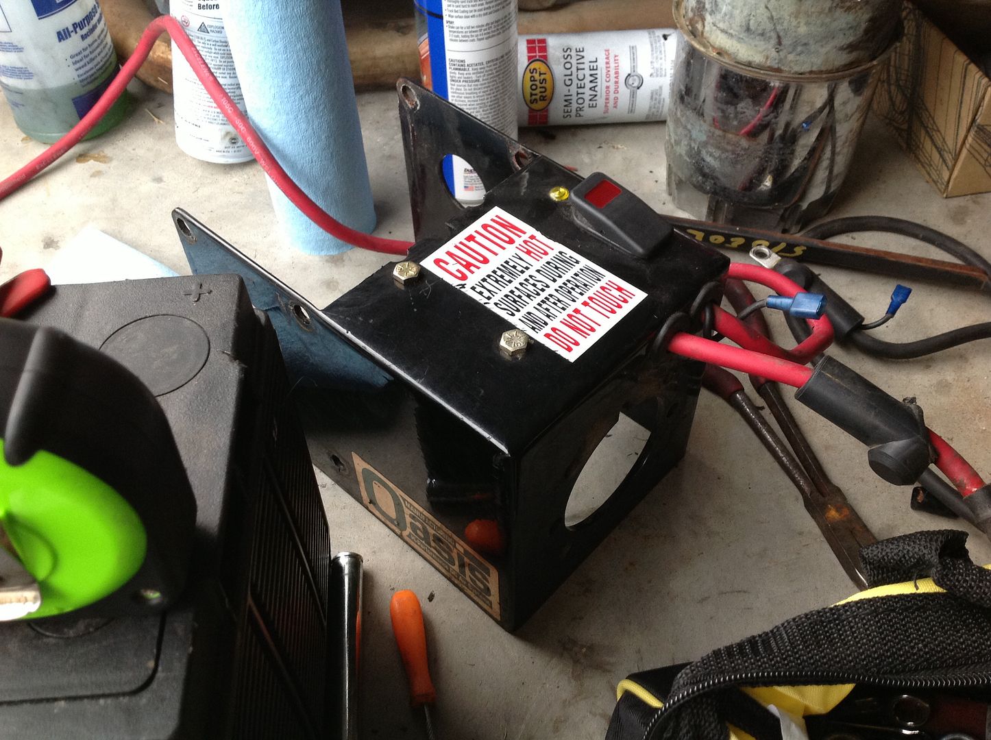

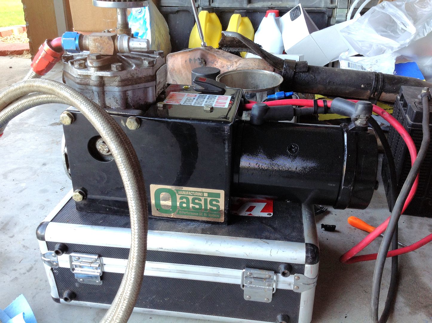

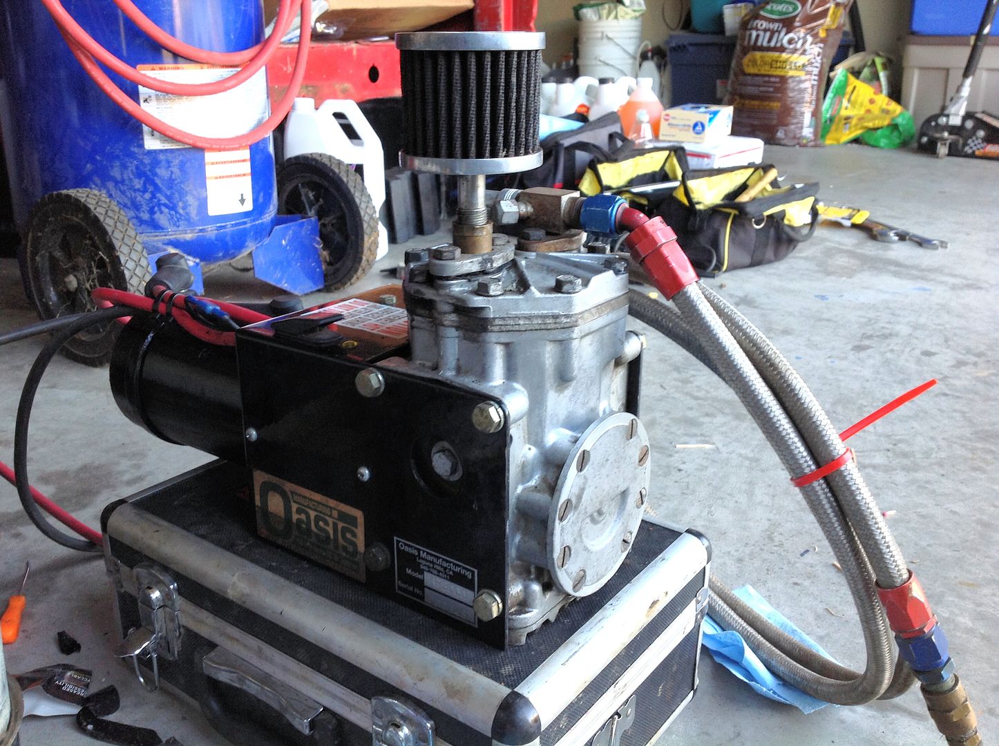

Picked up a used Oasis Compressor off craigslist. Turns out that the brushes in the motor were shot, so I had a local electric motor shop completely rebuild it for me. Put it all back together, and the compressor works great!
:flipoff2:
Before:
After a rebuild:

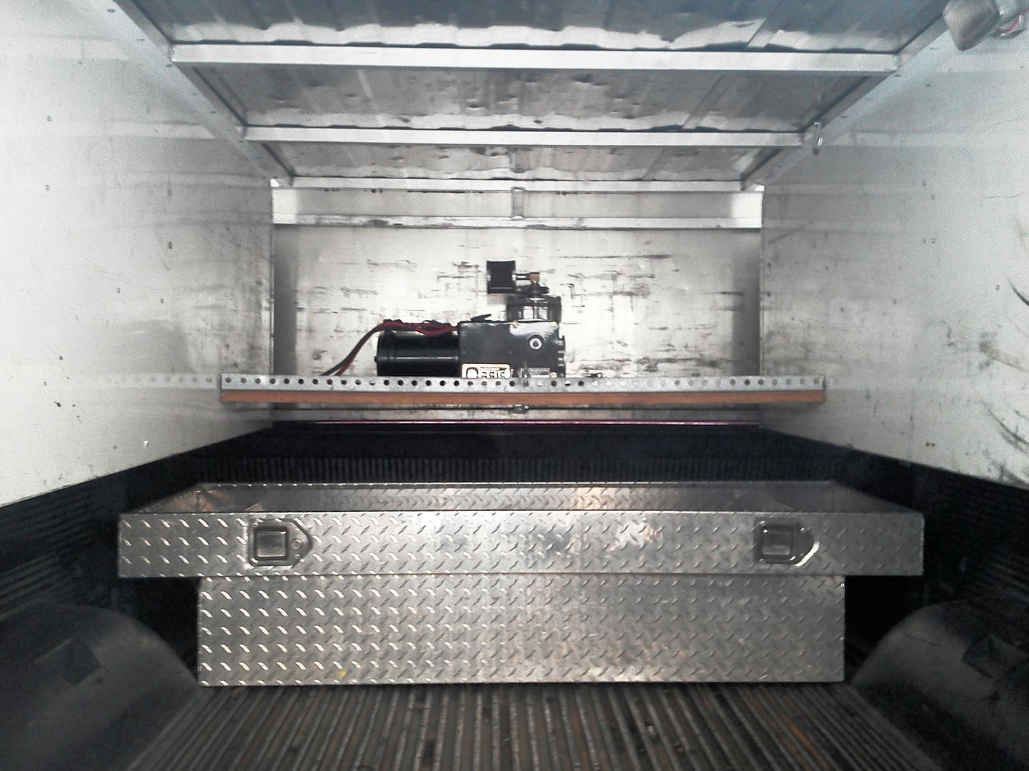

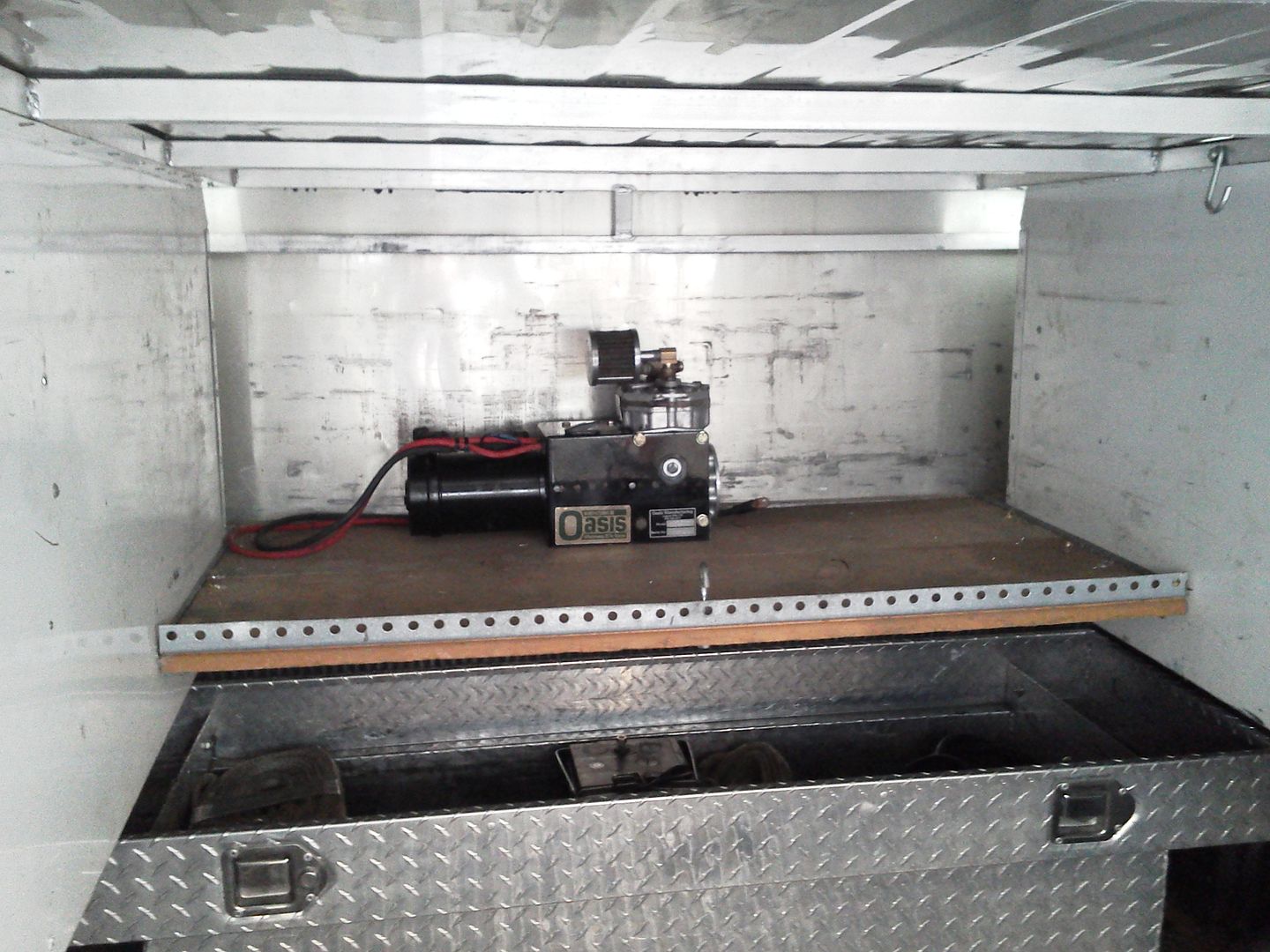

The guy who owned the ARE Topper had added an interior shelf at the front. I had thought about removing, but it's really solid, and will work well with what I have planned.
The compressor is going somewhere in this area, along with a custom built air tank and air hose reel (More on that stuff tomorrow).

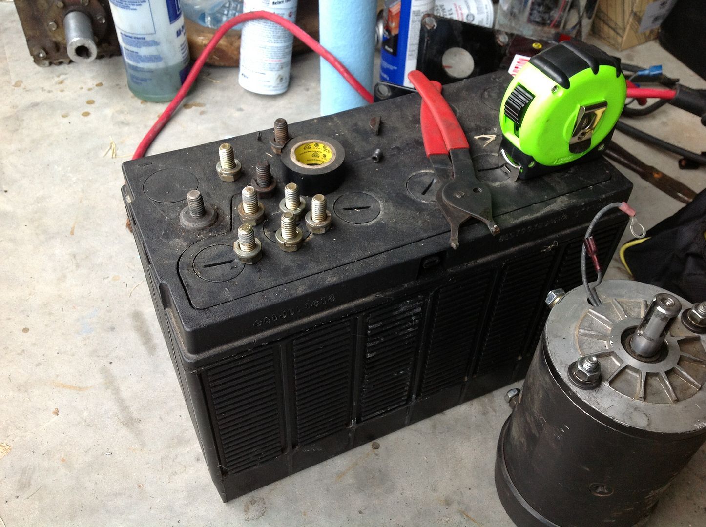

I also traded my black tool box for a smaller box (made for a S10 I think) that fits perfectly in front of my wheel wells. I just removed the lid so that I could still access the gear with that shelf in place.
I keep the heavy stuff in the tool box:
Chains
Shackles
Bottle Jacks
Winch Extension Cables...ect
I've also mounted an extra battery inside there.

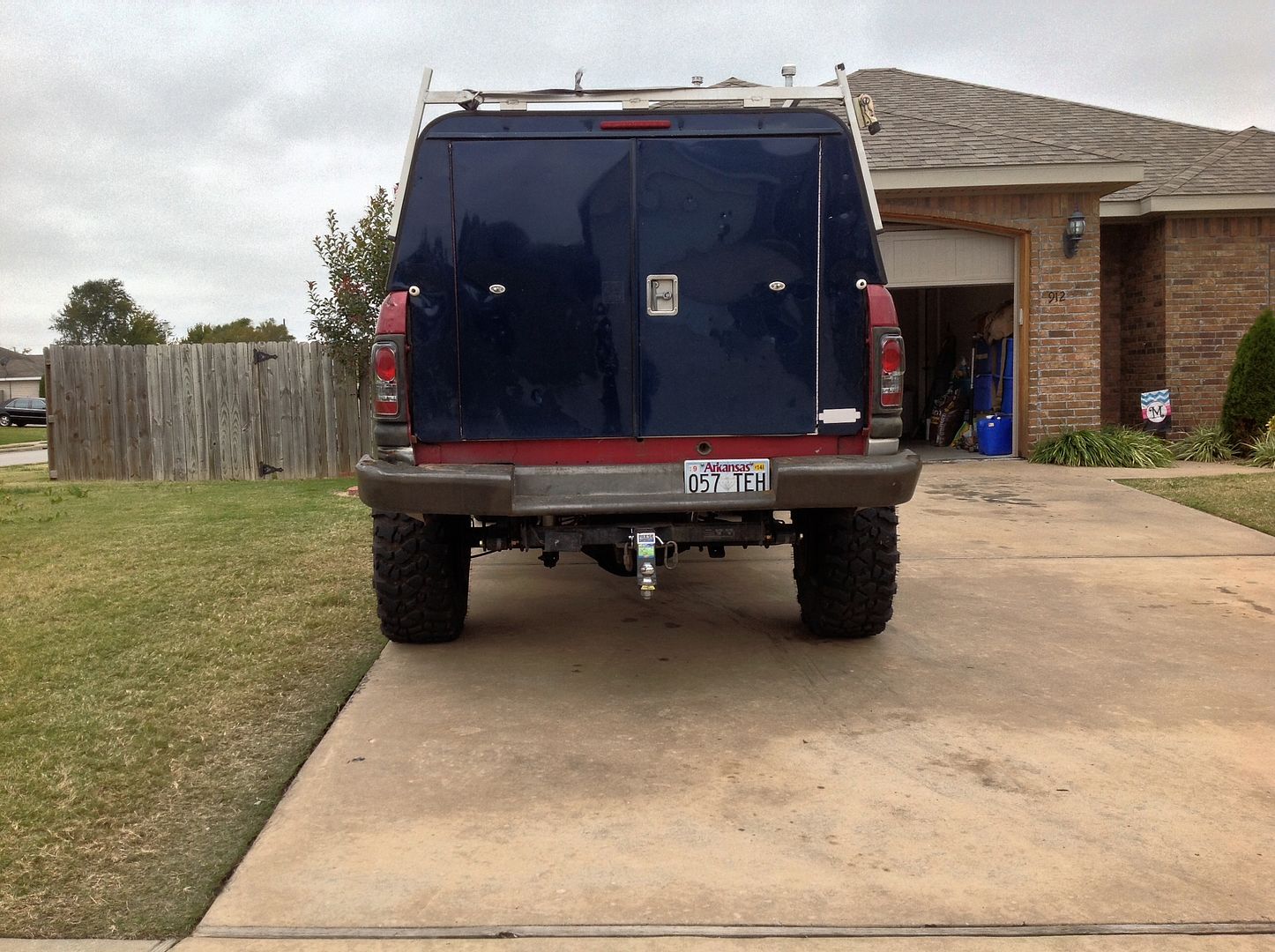

Here it is with the shell on the truck. Going to pull it off soon to bedline it, and install my new bed.

How much bump travel do you have up front?
Sent from AutoGuide.com App
There's a solid 4" of up travel there, maybe a bit more. Doesn't sound like a lot, but it's very progressive. I've marked the shocks to see how much travel I actually use, and I've only seen 2.5-3" used. The shocks are a perfect match for the springs, and they firm up tight when you hit big bumps, but are never harsh or jarring. Hard to explain, but they work well.
