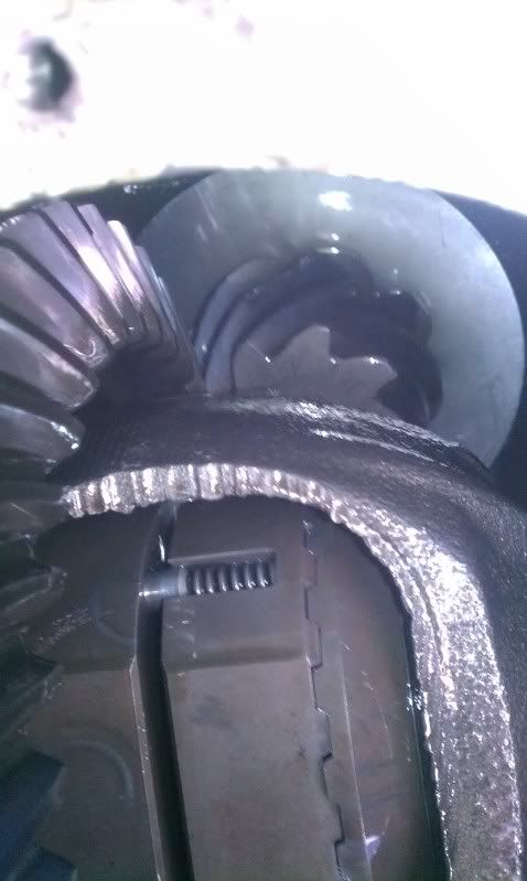

I had been going back and forth for a while on axles. I already had a 10.25, and a KP 60. I ended up selling the 60 here undecided on what to do.
So when the pinion broke it was time. I found a BJ 60 on craigslist for 300$ so I went and snagged it.
I pulled it apart and got to work

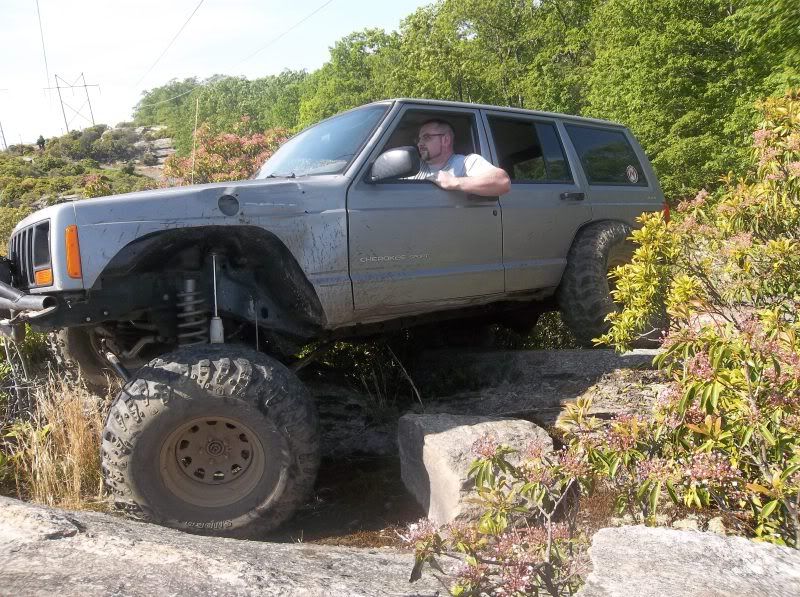

This past Sunday I got to take it out on its maiden voyage.

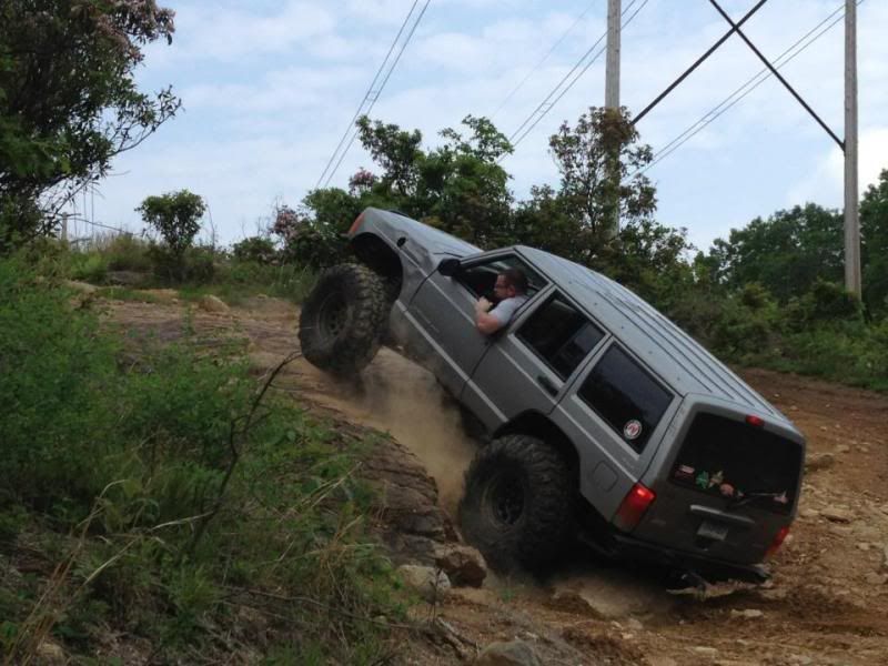

Got to wheel a bit today. Did some awesome lines. Waiting on a few pics still but heres what I got off of my camera.
1,514 Posts
Discussion Starter · #20 ·
couple more to do this spot more justice. Even this doesnt do it. The rocks were all covered in moss. Once the back tires hit the rock the back end slid over and almost smashed out the window, dented right behind it, put a good one in the hatch too.
