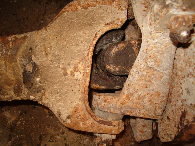

Well, here we go... I talked about this on here a few weeks ago, just wanted to say I am making progress. I started the other day. I have the D50 TTB apart and verified that the D60 shafts do indeed fit inside...
It is pretty close to the inner knuckle, but I have about .25".
clearance between the lower BJ and the yoke, about .25"
Clearance between the upper BJ and yoke, about .75"

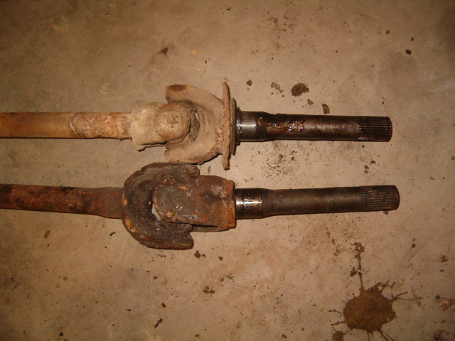

Dana 50 shaft top, D60 shaft bottom. It is hard to tell in the picture, but the D60 stub is about 3/8" longer as I suspected, this is due to the D50 haveing cast caliper mounts, and the D60 has a removeable plate caliper mount. I will probably just cut them down as the splin length is the same. If I end up taking the snap ring grove, I will have it remachined into the shaft...

Made a little more progress today, there have been a few snags, but this is going to work. Here are some more pictures...
I had to cut the knuckle for a little bit more joint clearance, once I had the knuckle on the tube, and the d60 shaft in it, it bound on the inner knuckle, and was going to be bad when turning...
So I cut it for clearance, and then plated it with 3/8th inch steel to get the strength I lost back.
New modified plated knuckle on the diff and axle shaft in place...
Front close up view, I put the rolled edge back on the inner knuckle, again for strength. Had to grind the 3/8ths a bit on the bottom because of contact w/ the outer knuckle. I should not have plated it so far forward...
Back close up view, I have to take it apart again and grind a little bit of the inner knucles lower half of the opening. The factory roled edge was at an angle, and my replacement piece was not. The reason it was at an angle... The shaft yoke binds when turned all of the way right.

So basically you are taking some junk and making a D60 front axle. Pretty cool ideal. I hope it's worth the time.
As for the snap ring groove, just take a thin cutting disc and make your own. I've done that several times on used shafts.

I'm glad your doing it and posting pics, I daydream about this everytime I see a row of F250s at a junkyard. I think this would be a badass solution for a trail truck, but I'm interested to see how it works on the street. I think that you would have camber issues "flattening out" a ttb. Arent ttb trucks supposed to sit with the axleshafts unparralell to the ground? You could probably set the camber with shims behind the spindle, but with the offset of the balljoints, I think that the camber (caster too?) would change dramatically through the steering arc.

With stock components at stock ride hieght, the twin arms sit very close to, or parrallell to the ground. The top ball joint does have a castor/camber cam though and it can be adjusted up to 2*, so it should not be a problem. One thing to keep in mind is that most of the F250's had D44's, not the D50's. This TTB came out of an early '80's F350. The D50 spindles, rotors, hubs, and lockouts are all identical to the stock 30 spline D60 stuff.
As for the D61, everything from a D60 will swap, but it is not supposed to. The only difference between the D60 and D61 are pinion offset in relation to the ring gear. That is how mine ended up with shelled gear, the PO put D60 gears and case in a D61... Side gears and spiders are all the same, and you can get a spacer ring to run D60 gears in a D61 case. Optimally, you would build this w/ a D70 as it is already 35 spline. When I first started this, i thought I did have a D70 due to the extra center section webbing, and the larger tubes. It wasn't 'till I had it apart and found 30 spline axles and I started running BOM's to figgure out how the thing possibly got this F-ed up. I will have to take pics of the R&P, they were more tore up than any other axle I have ever seen, every tooth was sheered and a 2lb pile of razor sharp scraps came out of the pig...

5,490 Posts
What is the length of the overall yoke-joint-yoke section? Is it greater on the D60 shaft assembly?
I'm curious if the D60 u-joint will be inline with the balljoint steering axis.
