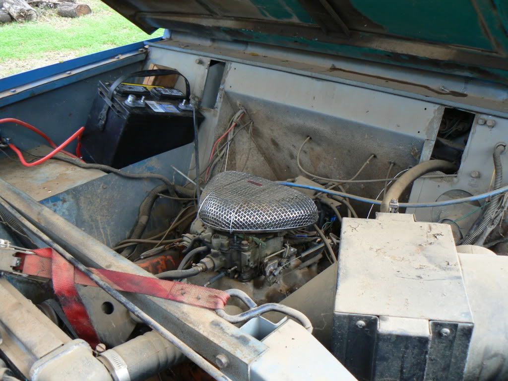

I am a new member but i have been lurking on this board for years but now i finally have a project. It is a 62 Scout that already had a sbc 350, with a sm420, & dana 18. It has a 4" body lift so the motor will clear. I was told that it sat for about 3 years. I bought it in February and since then i have been hard at work. Here are some pictures from when i bought it.

Since I got it home i have spent a lot of time under the hood getting the motor running better, changing all fluids, going through the brakes, upgraded to stainless brake lines, extended shock towers, custom radiator support, electric fans. Took it camping in July, here are a few pictures.
And here it is now how it sits. I installed a set of 33" BFG Mud Terrains, a set of flowmasters, and painted it olive drab. I am currently gathering parts for power steering.

The person who did the body lift used solid aluminum blocks that are not pictured. What you see in the picture is support for the inner fender. It will be replaced.

What the hell is with that body lift?

Carry on then. So far, so good, but...ummm..might want to get better at your welding skillz :D
I had a friend do the welding for me. They might not be pretty but they are strong. A lot of the problem with welding is that my house has old wiring and the breaker keeps popping making it a pain!

Nice starting point. Are you planning on running the 52" springs up front? I'm running chevy 47" up front and 52"s out back. I'd watch the 52"s up front, you will be running into obstackles before the tire can climb them. Even on 38's I still have my spring hitting before the tire can climb. The 350 will fit without the body lift, you might have to notch out the drivers fire wall a little bit though. Nice start though.

Even with factory manifolds I had to notch a bit for clearance. You don't need much.

Are you using a dryer plug? You should run a dedicated plug rated for your welder not a dryer. Are you going to keep the stock column? If not.. dibs :p

Feel free to check mine out for ideas on the steering etc.. I have no body lift and fit my V8 just fine, some cutting involved though.

No, it was a 110v welder, and its not mine. Part of the problem. Are you referring to the stock steering column? If so then no, i am installing a tilt wheel from a chevy van that does not have the ignition on the column. Stop by anytime Brandon, i am working on it this weekend.
Regarding the body lift, look i know it looks horrible and it makes the center of gravity worse, thats how it was when i bought it. It will have to stay for a while because i dont have a welder to do all the firewall notching, and i plan on taking the body off the frame in the future anyway, and i can fix it then. I will also have to make new motor and tranny mounts, and lower them down some, they sit too high.
