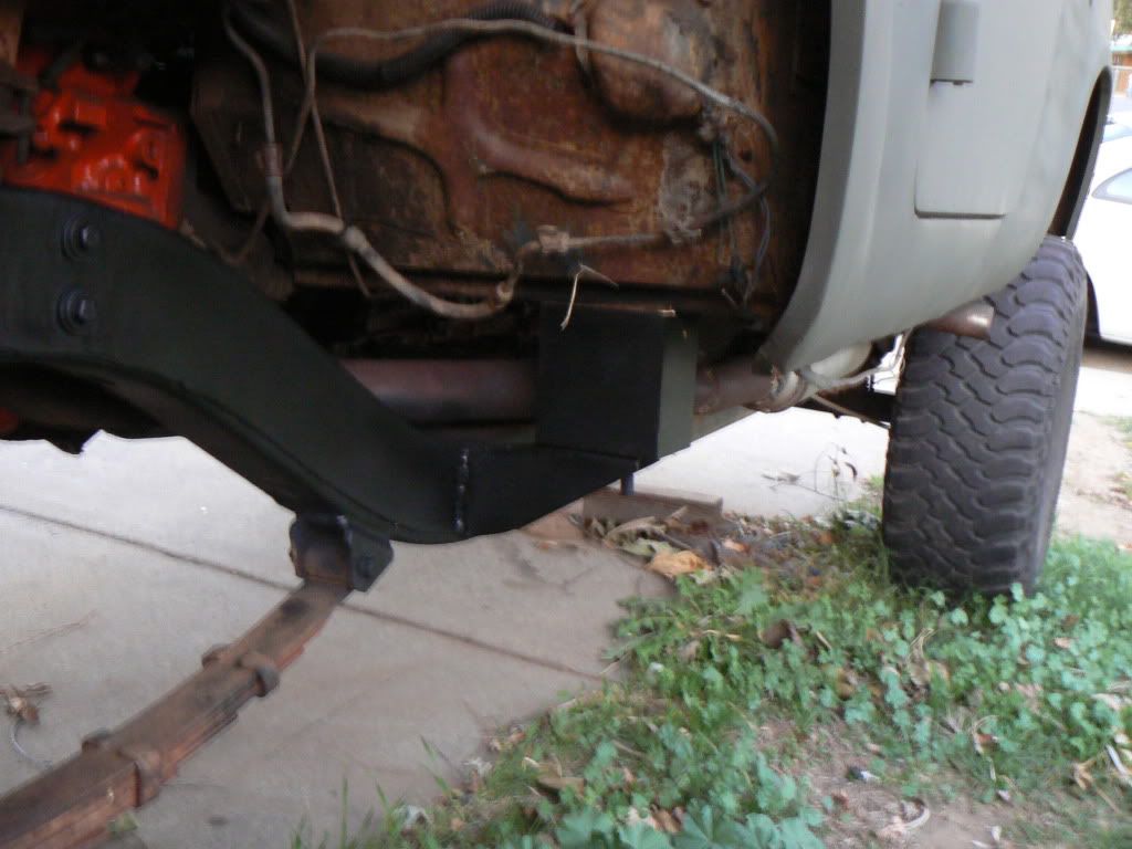

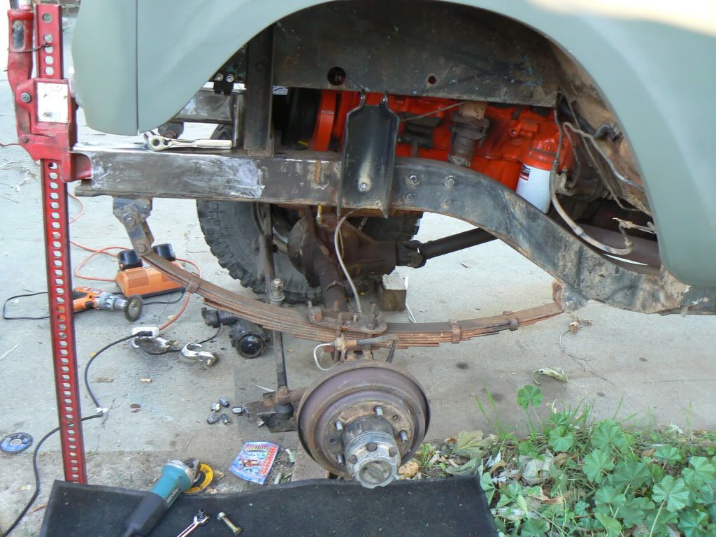

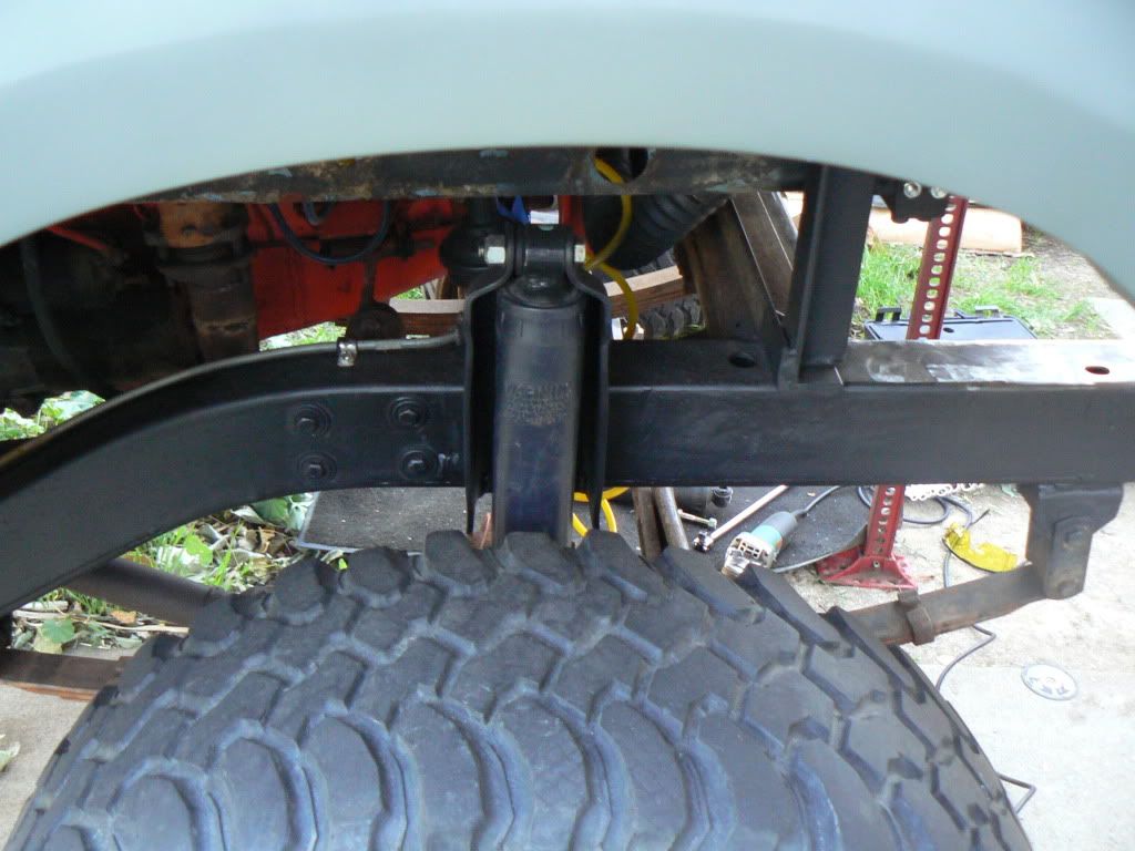

Not too much going on with the build. Still waiting parts from Speedway. UPS lost my package, then UPS had to open an investigation, and now they said they are having speedway re-ship the u-joints.I also spent quite a while stripping the paint from the inside of the top (sorry no pics of that). I cut off the factory steering box mount, then cleaned up the front frame with a flap disk and wire wheel. Took the shocks off each side when painting so i could put in some longer bolts. Here are some pics.
