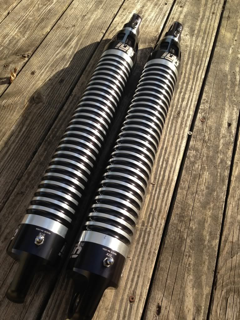

Got my ORI's today. Took 10 weeks and few days to get them but they're here. These are 18" stroke STX's and there going in the back of the truck. Can't wait to wheel with these on, hopefully will feel much more stable on the side hills.
hopefully you have better luck with your ORIs than i do , my back two are on their third rebuild in 4 years,people that still have them , carry spares.
I know a couple of people that have them and they love them. What was happening to yours?

what they do is the seal leak inside and then start to sag, they become soft and if you are on a side of a hill they will lean really hard to the soft shock.
basically they let all the nitrogen out and collapse and then your stuck,
right now i have a pair getting rebuilt, again, they wont give money back , they wont give me new shocks, they just try to rebuild the old ones, i put them on and they go for a while and then it cost me $45 to send them back and wait for them to figure something out

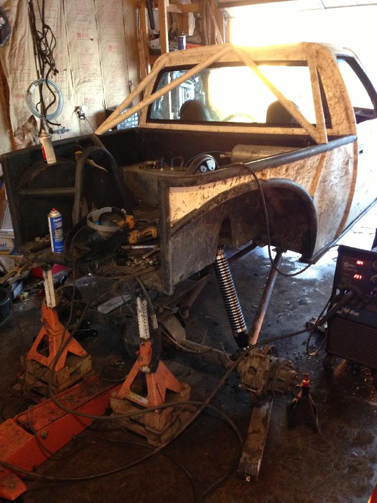

Actually started working on Getting ORI's on. The spacers on the new shocks are wider so I cut off one of the tabs on each side. I got them rewelded and waiting on paint to dry now. Then the fun of tuning begins.
