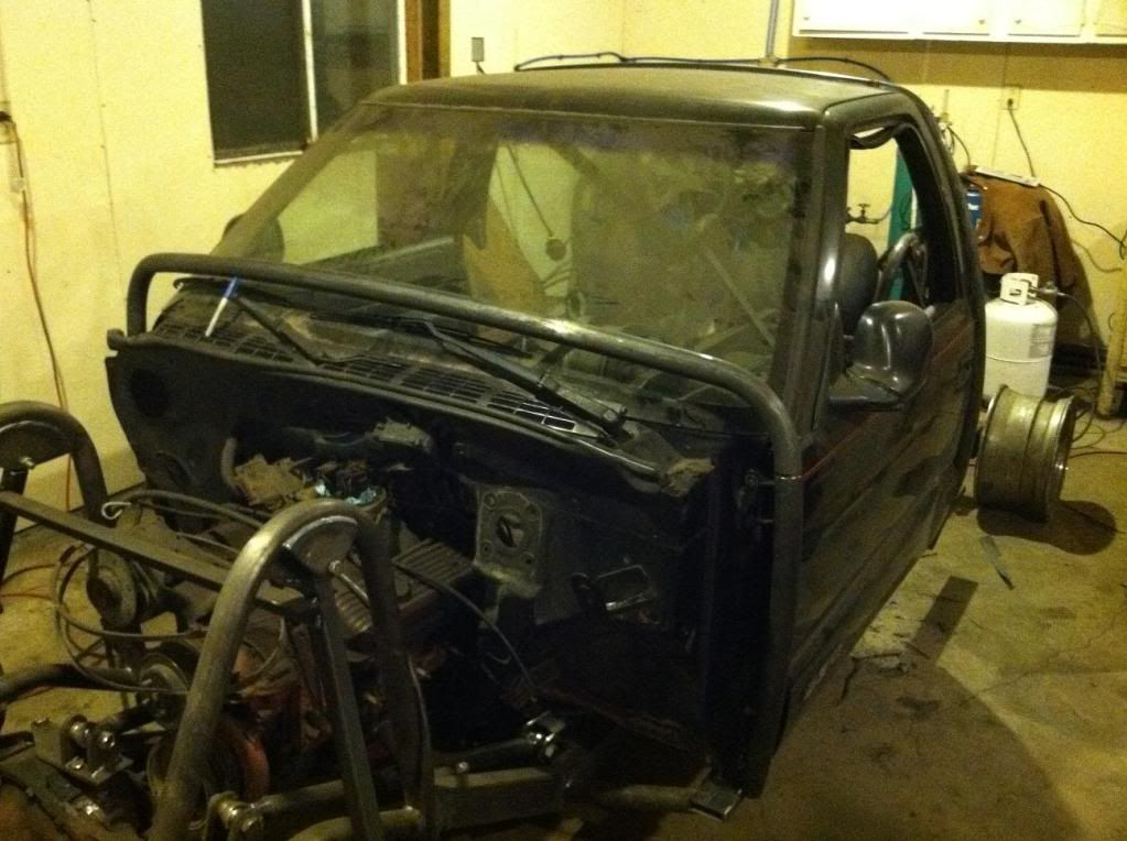

Worked on the truck a little. I think the pieces that I making here are the hardest to make. Didn't make as much progress as I thought I was gonna get this weekend but its some at least. I don't know if I'm gonna change the firewall/lower windshield tube. I'm not really totally happy with it. Let me know what you think.

Looks good so far. I am working on a build like yours. I am doing the same thing with the tube and recessing it into the body. Mine is a 95 extended cab though. Here is a link to my build thread on Great Lakes 4X4. Subscribed!!
http://www.greatlakes4x4.com/showthread.php?t=224359
my windshield tube kills some visibility like that. I plan on moving it in front of firewall and making the Hood hinge off of it next winter when I remodel and link my front.
its a pain in the ass to get the wipers to operate with a tube like that... Im not sure what the solution would be, though.
I had to slightly bend my wiper arm and it just barely clears and the hood hits the bar when open, just can't get it any lower and still keep wipers and factory hood hinge. That why I plan on putting it in front of cab/firewall and cut down hood to fit it.

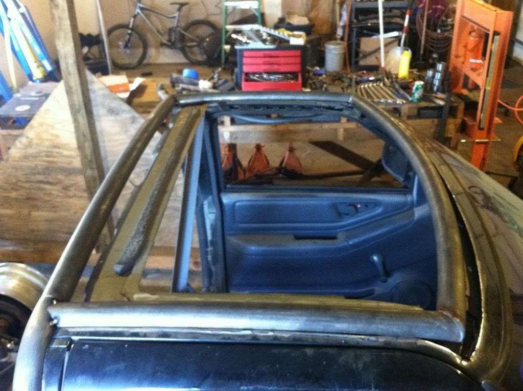

I took the day off working on the truck yesterday but I was back on it today. First order of business was moving the lower windshield bar. I'm a lot happier with the way it looks now. Dont know what exactly Im going to do about the area in front of the doors yet. I'll figure it out. Then the next thing I was gonna do before I ran outta time was the A pillar bars. But I did turn it in to a convertible. Just temporarily until I get those tubes on then I will be putting back in some sheet metal between the voids of the tubes on the top. Pics below

So I was able to work on my truck Friday and made some pieces for the top of the cab here's how it came out.
Then Saturday I went with a friend to the Cliffs Offroad park. It gave more incentive to get my own truck done. Sunday I had all day to work on my truck. Got the A pillars, center windshield bar and rest of the roof done with everything welded in mostly. I will be eventually be filling those gaps in the roof with sheet metal. I'm happy the way it came out.

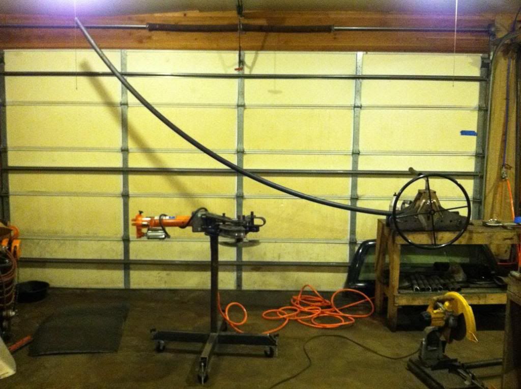

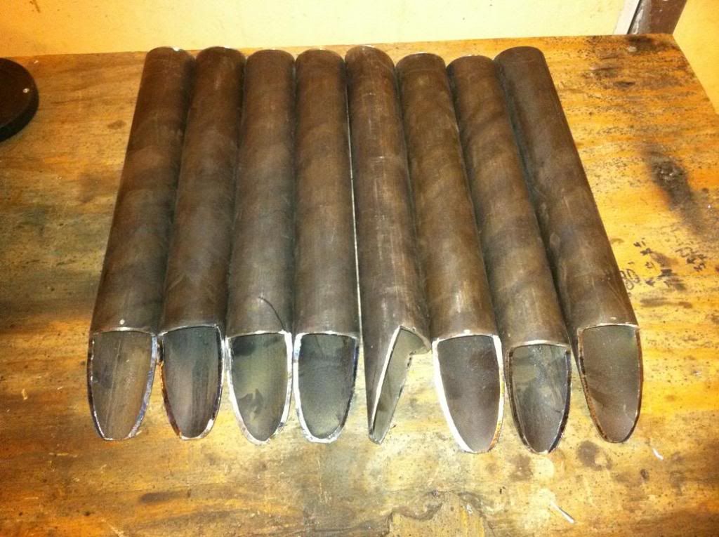

Ordered my tires the other day. 42" pitbull rockers but they're on back order until March. That's alright because it's not like I be done by then. Starting working on the front clip with 12' piece of tube and starting rolling it. The longer pieces I roll the less tube I waste because the bender don't roll 10" of each end. I have gotten real crazy with roll bender. I didn't plan on having this many rolled pieces like this but I like the way it looks. Not going to use any more of the stock body pieces anymore I think besides the grill. I narrowed the grill roughly 5.5". There has not really been a real plan of how I was going to do all this but I like the way it been coming out so I'm just going to keep on keeping on I guess.
