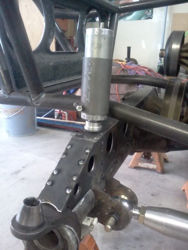

Finally got around to working on the front truss and bracket's. now that I have a 1.5 week break from sports with my boy's. The lower link's where bugging the crap out of me and how they seemed unsupported, so i looked around and found some idea's but none appealed to me . so this is what i came up with. I do wish they where angled but not a big deal. I made some templates and had the drafts man here at work draw them up in CAD then I ask Jesse to cut them out. All in all very happy with the out come
pass. side upper support. i like how it ties into the tube and cast to support the hell out of the tab's
both straight on
Lower side
Then the driver side pretty normal but I notched for the truss
And finally the truss back on...this was a huge pain in the ass to fit it but I got it :cougar:

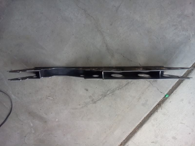

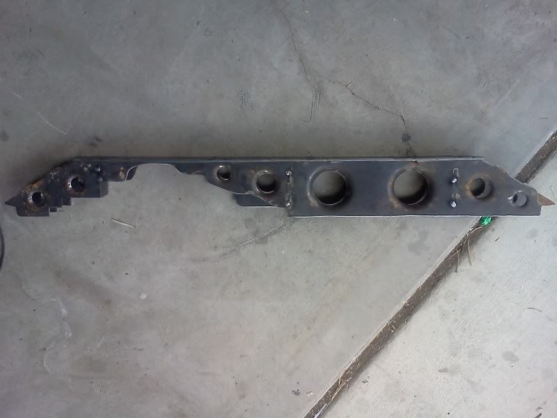

I WANTED A REAR TRUSS THAT WENT FROM FLANG TO FLANG. I COULDNT FIND ONE THAT WAS EXACTLY WHAT I WANTED AND WHEN I DID THE PRICE MADE MY ASS PUCKER. SO I ORDERED UP THE RUFF STUFF TRUSS AND PROMTLY STARTED CUTTING IT UP TO MAKE WHAT I WANT :eek:
AND THE PINION SUPPORT AND SHOVEL...LOL

SHAVING THE 14 BOLT

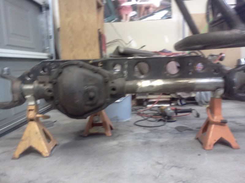

NOW THAT "CLUB" WRESTLING IS OVER I HAVE A LITTLE BIT OF TIME AND I MEAN A LITTLE BIT. I FIRST HAD TO DO A LITTLE CLEANING IN THE GARAGE THEN GOT TO WORK.
GOT THE TRUSS FITTED UP
HAD TO BOLT ON THE DIFF COVER TO SEE HOW MUCH WILL BE TAKEN OFF ;D
SIDE SHOT
