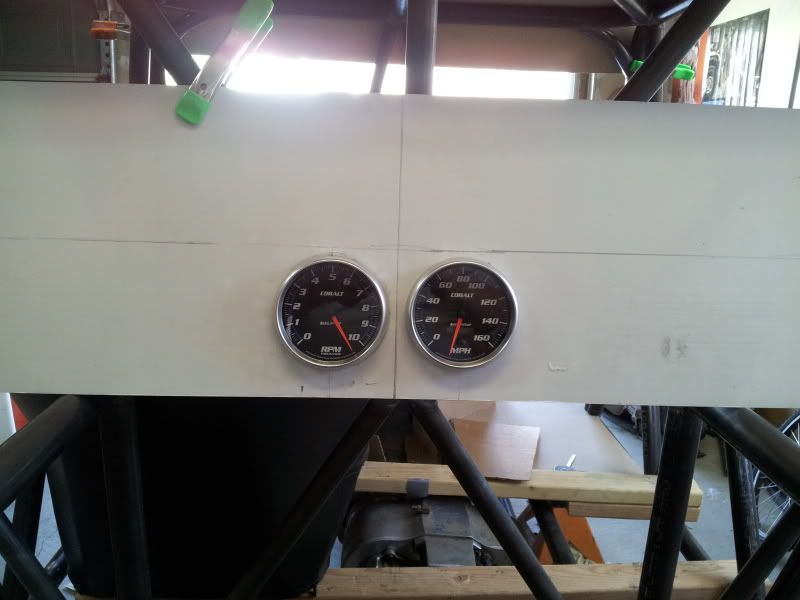

In the back ground you can see the stainless showed up for the dash and center console. I have it all layed out now just need to punch some holes for the small gauges and get it sheered and bent, maybe thursday I can do that if I get time. the main dash is going to look badass in my oppinion ( the only one that matter's ;) ) only issue is that damn 5" tach requires a 4 5/8 hole. cody said he has a punch that will do the 2 5/8 but cant find the 4 5/8 he has so I might get a friend to water jet it so it's clean :Big Grin:

this past weekend i got the holes cut for the 5" monster tack and speedo cut out. this week I hope to get it next door to the sheet metal guy to break it then i can start making progress

quick pic of the dash after getting the holes in it i had to put gauges in to check it out :flipoff2:
