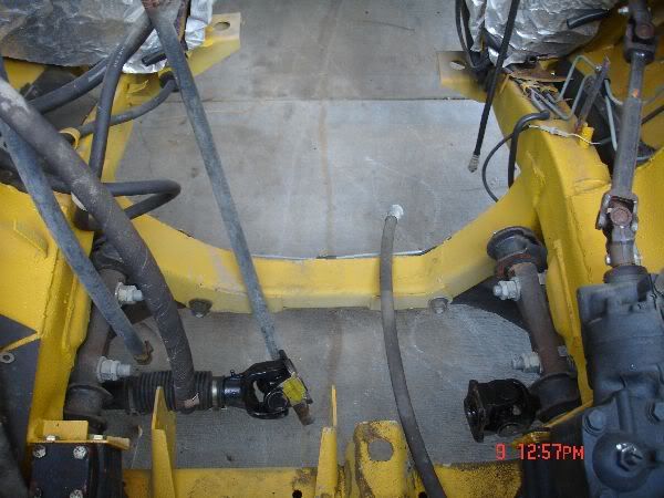

So after dodging getting hit by a truck this morning I went and worked on the ARO some more.
Ran into some problems.
Was test fitting the drive train and found the steering box was hitting the power steering pump not allowing the motor to sit where she needs to. I went and measured the other motor I had in there to see where the bracket put the pump on that one and it is the same distance. So I then took a closer look at each box and how it was mounted. The 244 is an '88 and the 246 is a '02. there have been little revisions I have found between them that have been making more work for me.
But the ARO box in the 246 is a good bit larger then the Ford box in the 244. Plus the ARO box puts a lot of its size in front of the spindle where the Ford's is behind it. I also noticed the Ford box is mounted into the frame with a notch. So I pulled off both boxes to look them over and see how they mount.
The problem.
Ford box VS ARO box. (Ford on right)
I removed the 3rd member from the rear end to find out what gears it had in it. The front diff has 4:12s. Turns out this one has 3:73s in the rear. So I will need to rob the spider gears out of this one and install them in the 244s third member. Pics of that to come.

Now looking how the 2 boxes mount.
246
244
So that is where I am now. :(
I am debating on cutting the notch out of the 244 and welding it into the 246. Or just notching the frame on the 246 and plating it all up myself.
