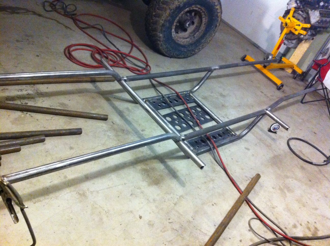

ok so progress from today...about 50% of the tubes precut
the skid plate's cut and dimpled. remember this will have a drop out belly that will allow you to pull a tranny without undoing the links.
and the lower suspension link mounts

spent 2 hours tonight on it and got some progress tonight.
here is the work space...a bit of a down size from what i've built in before.
I scotchbrighted the tubes before bending. got them bent, and notched the ends.
i'm amazed how long shit takes to do when you are trying to be extremly accurate because i'm prebending and notching with no fitting. shit should go faster then i can start to assemble and have something to fit to.

got a couple of hours on it today...
and where it sits now..
i need to set the frame table up. i think after i eat dinner i'll get the mail frame rails and rockers in place.

6,145 Posts
Why are you welding the plate in the subframe? If it's to support the skid plate you're adding very little strength. I built one buggy that didn't allow me pull the pan while the trans was in the car. I will never do that again, especially on something that will be used for racing.

Looks like 1.75" tubing?
2,399 Posts
Discussion Starter · #13 ·
The skid is not done yet. The center will be removable for dripping the tranny...without removing the links.
The center strip of the skid is not welded in yet it's just placed there. I'm waitin on some tbe clamps to finish the drop out skid.
And yes 1.75" tube

1,014 Posts
how deep is the belly ?
looks like there is a bunch of foot room wasted with that tall of a belly .
mine is 7 inches from the bottom of the belly to the bottom of the floor where my feet are(just above the front drive shaft yoke). then the seat is raised up 4 inches for the tcase
2,399 Posts
Discussion Starter · #18 ·
The belly is 10”
Its made for a very deep tranny pan. And a flat floor. I also want room under me for battey, muffler, fuel system etc….
