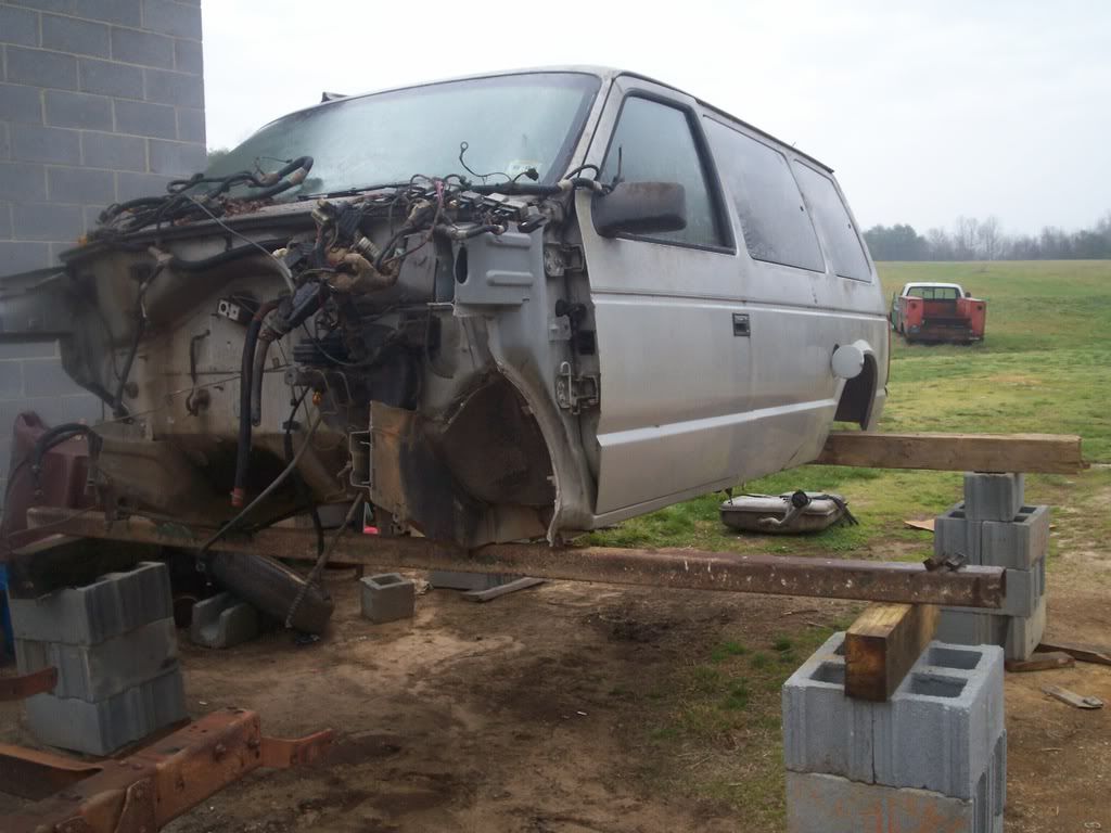

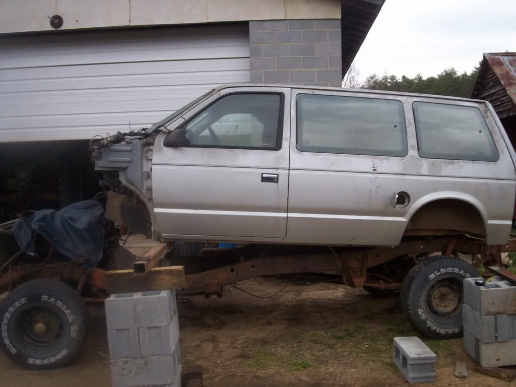

After reading all that ya'll have said and some more research and playing around with what i have available i am got to actually be putting a dodge caravan on my Chevy frame... i have learned through research about the front blocks and how bad they are thank you for stopping me on that. i am going to be fabricating my front fenders and hood while using the van body and radiator cradle.. i have decided on using a 4" suspension lift from rough country and getting making a 3" body lift while welding on some new body mount brackets. and for the tires im looking to run some where between 36s and 42s haven't decided yet. i think im going to build up my front leaf springs some after adding the lift kit. if theres anything i left out please help me out. also any advice on what i have said please help... like i said im new to this and any information helps. Thank you all for your help and advice.

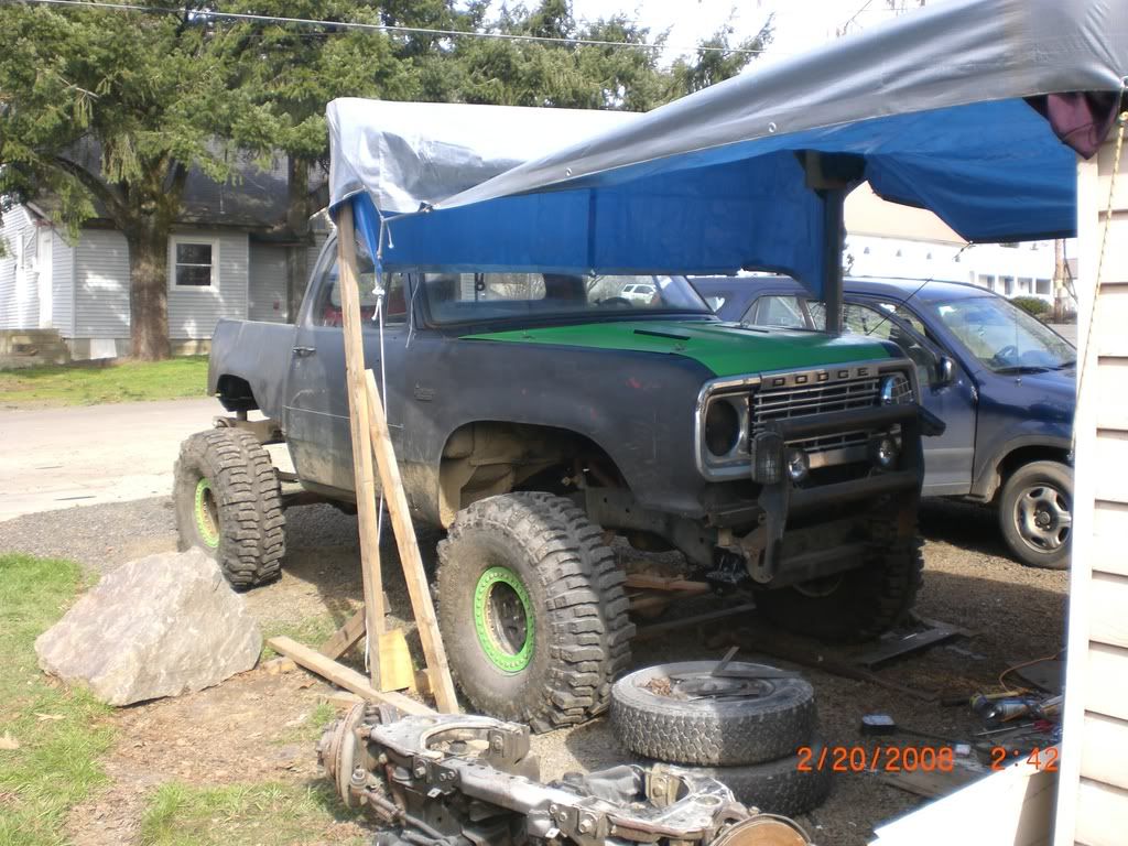

you should leave it at stock height and trim the fenders, it is the best alternative, also you will find your self on your tires instead of your lid from being lifted so high. here is a photo of my dodge on 38.5 s running a 3 in body lift as of now will be coming off soon, so this is three in taller than stock stock height and i only have 3 inches trimed off my fenders never come close to rubbing my tires.

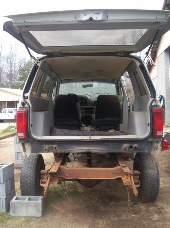

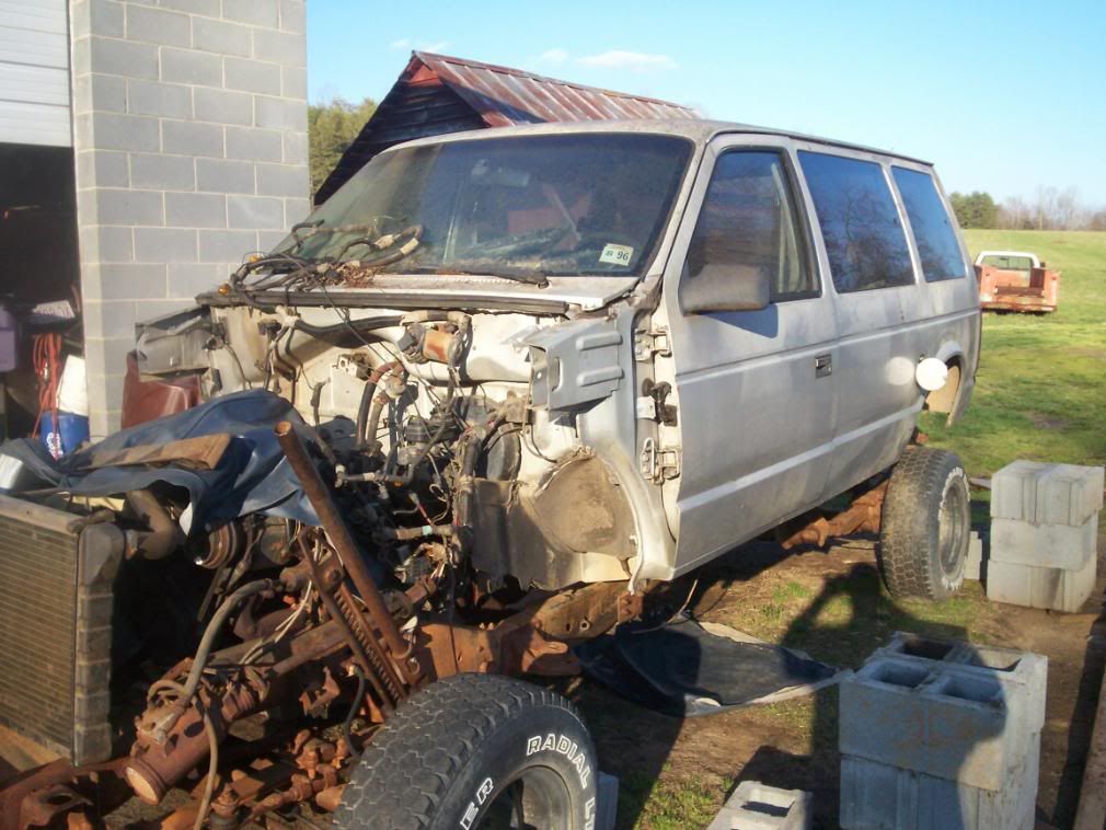

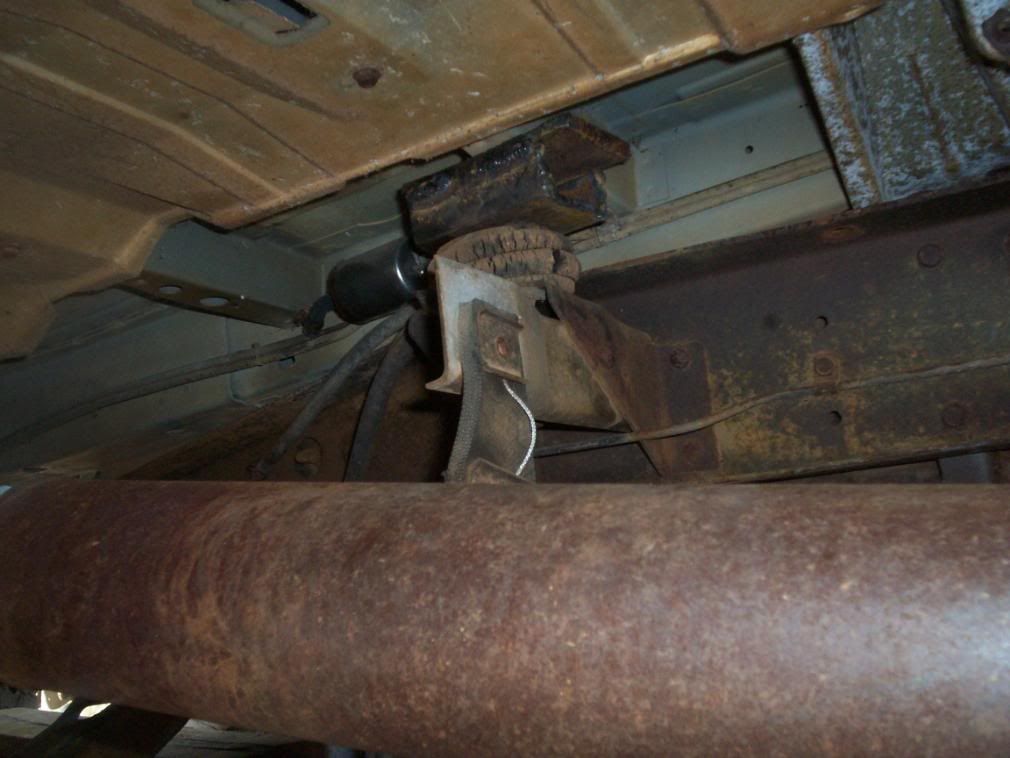

Discussion starter · #13 ·
I redid all of my measuring this weekend and the dodge van will fit i just have to fab a little on some body mounts. As for the firewall and all it will fit i will just have to fab new fenders and a hood. it wont actually set much further back than the truck cab as long as i center the rear fender wells over the rear axle. i try and post pictures as soon as i start. Also thank you for the tip power wagon, i think i will be able to accomplish what i want to do by just cutting on my fenders and maybe adding a slight body lift.... im going to avoid the suspension lift at all cost mainly just to save more money for tires...thnks again for all of your help
Discussion starter · #14 ·
Update

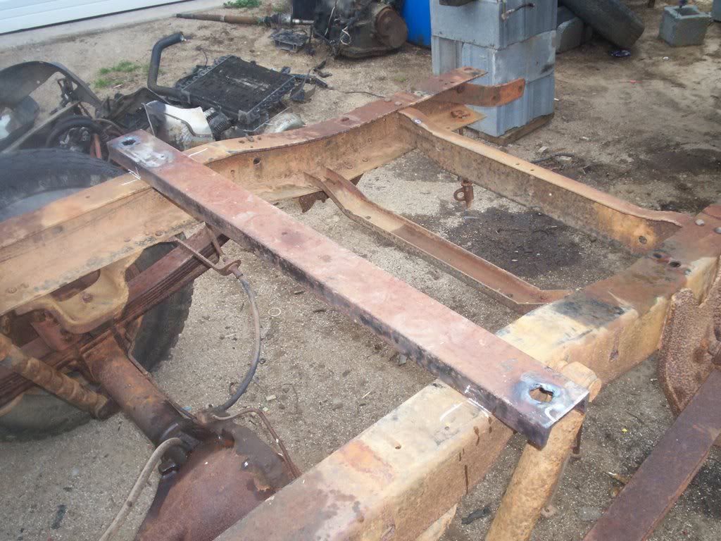

Just a quick update... i stripped the truck frame and then stripped the van and cut off the front clip. I rolled the frame under and all is looking good. the frame rails on the van are going to sit perfectly with the trucks frame. one more weekend and i should have it all mounted and the only thing left for me to do is to fab the front end. Im planning on making it like a race car front end. 1x1 square tubing and using the van fenders, cut them and fill in the gap with sheet metal. ill will post pictures after this weekend.
I may be miss-reading this, but does this mean your just going to weld the two frames together?
why not hes putting a minivan on a 4x4 frame :grinpimp: sure sounds like it to me
Discussion starter · #18 ·

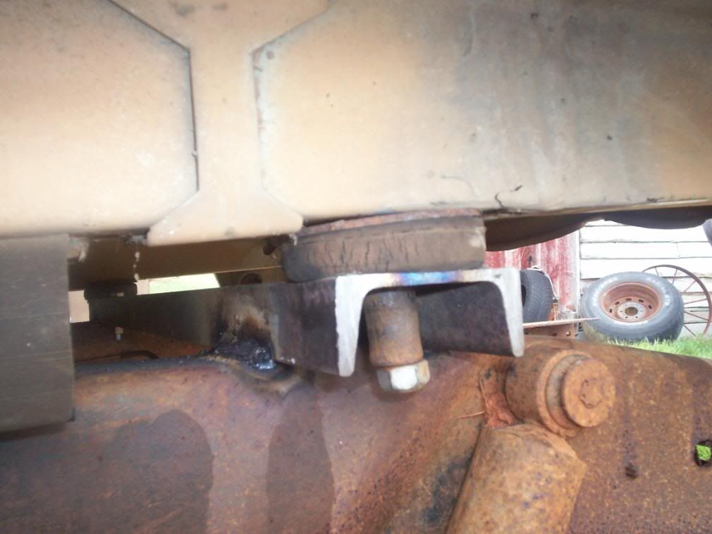

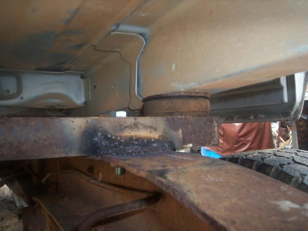

well i'm not really "just welding them together" i'm actually making mounts for the frame off of the truck frame...ill have pictures after this weekend. sorry for any confusion and not having pictures sooner.
