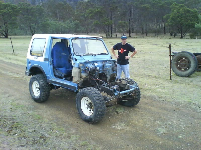

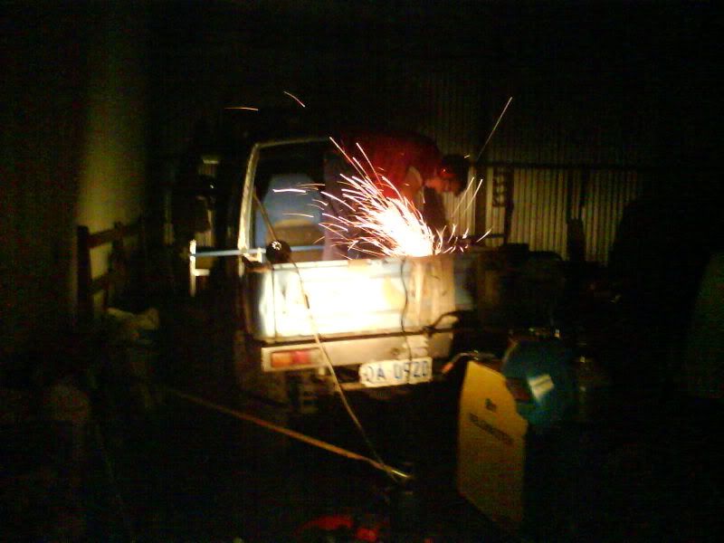

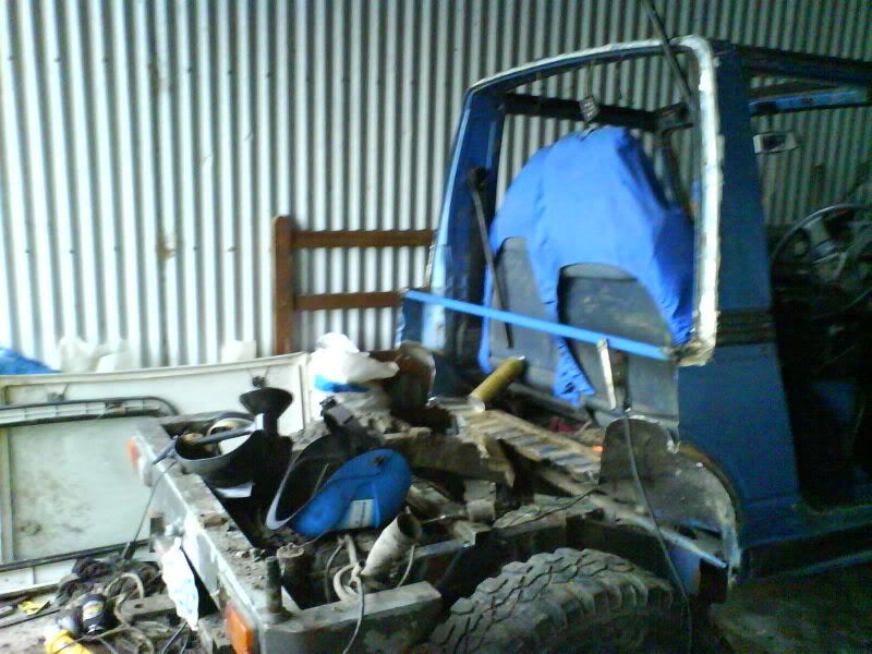

Hey guys this is the zook im curently building for tuff truck 08.. specs are
4afe corolla motor (will be supercharged)
borge warner auto
zook transfer with 6.5 gears
cut down tub with soft top
gq patroll diffs (do you get those in america?)
3link parnard all round
18inch air shocks all round. with limmiting straps
39.5 iroks (hopefuly 42' mitchilins b4 tuff truck)
full exo etc...
ok heres some pics
how i got it and the start
273 Posts
103inch wb
second hand iroks got them for $500 aus.. about 300 or so american
it was going to be coiled at one stage...
273 Posts
Discussion Starter · #5 ·
Well thats how it sits atm.. still have to do alot of work but as you can see its starting to come along!:homer:

Ummmm... is it just me or does it seem like his suspension will have no articulation laterally? I see bushing at both end of his links with no way to pivot. :eek:
273 Posts
Discussion Starter · #9 ·
it is all only mocked up.. but how do you meen? th bushings flex quite well...
with no rear parhard it flexes quite well.. have had it all twisted up a few days ago...

Given, there is a certain amount of flex with rubber or poly bushings, but they are resistive to the forces you are putting on them, mainly rotation. They are also limited by the width of bracket you mount them in. Without room for distortion they will flex very little. Also, you should keep in mind that if they can distort one way, they can distort in others and may prove to shift while under load. That, and they will wear quickly because of the flex. I suggest you use, at least on one end of your links, a Johnny Joint, RE, or even a heim joint.
273 Posts
Discussion Starter · #12 ·
they are mounted on bolts, so there for alowing for movenemt latraly... they are patroll links... would u like a pic of one out of the rig?
i may be chainging to hemis all round b4 to long with my new job but these should do fine for now...
