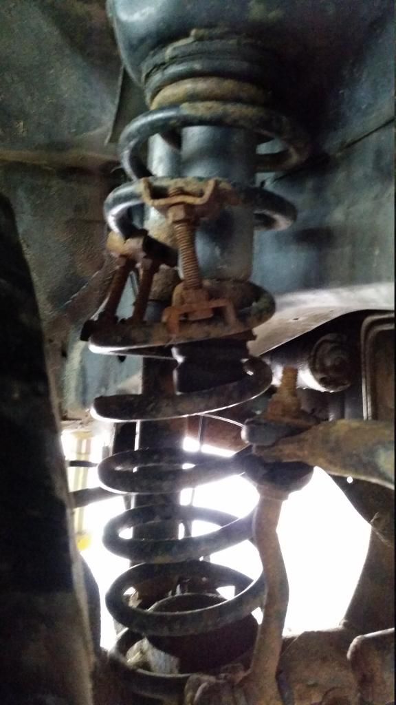

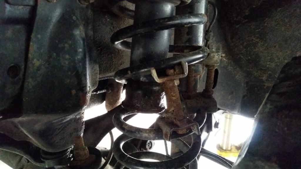

What's up? I'm a newb to the off road world so looking for some expertise from everyone. I traded a guy an SKS (AK47 gun) and a 14 ft jon boat for this 96 Grand Cherokee yesterday. It has no title so this will just be used for riding trails and as a family type "side by side" around our property. I don't want to go crazy with this thing, since I have two hot rods I'm working on, but I would like to make it run and drive good, still have a bed area, and seats for everyone to ride along. I'm thinking maybe door bars and a cage eventually but for now a small lift. So check out the pics and please let me know of anything I should look for. The transfer case is stuck in 4lo, the springs look like they put some cheap "lift" clamps on them, the transmission is slipping in and out of gear (see pics, there is a bolt loose and the trans isn't flush with the block) and the flywheel bolts are rubbing. The guy did the chop top on it, put on 33's, did some other work to it too but I want to fix some of it. Let me know what u think or what needs to be done. I just want something mild like maybe 2" of lift, fix the things that need fixed and get it driving good. Should I just take the sway bars off since its gonna be off road only? It starts right up every time, looks like it has some oil leaks around the valve cover, all the lights work, radio works, windows work except passenger rear.

The VERY first thing I would do is replace that cobbled suspension with this:
Amazon.com: Rough Country 632.20 - 3.5-inch Suspension Lift Kit with Premium N2.0 Series Shocks: Automotive
Whatever that piece of metal is in the throttle body is, should not be there. Neither should those pvc shavings :shaking: . Get the trans bolted up correctly. The tcase issue is probably caused by the shifter linkage. Remove the linkage from the case and see if you can move the selector arm on the case manually. A cutoff wheel on a grinder will cure the clearance issue between the front tire and the fender. Weld the spider gears in the rear end and beat the piss out of it :laughing:
edit: oh yeah, and take that front swaybar off and throw it in the trash!
