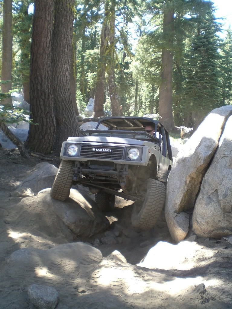

Build threads that drag on forever irritate me, so I swore I would get this out wheeling before I started one. It is certainly not done yet, but I have a couple of trips on it now, so here goes.
Pictures first; a little before and after
early days:

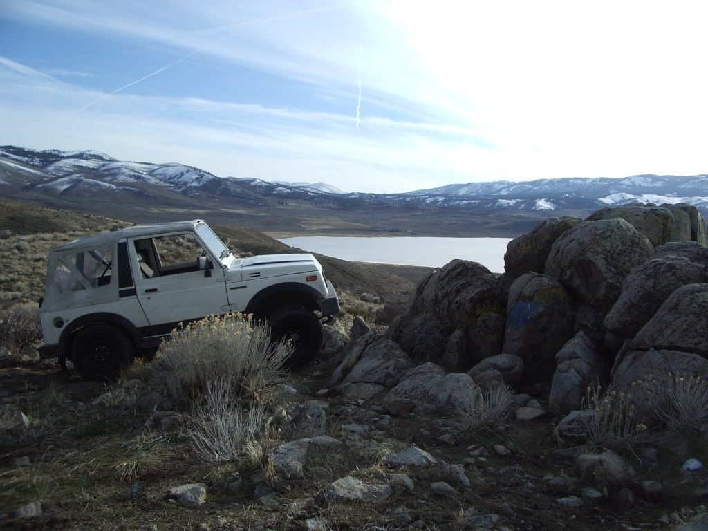

February 06, Mormon Emigrant Trail
March 06, Reno hills
over the last few years:

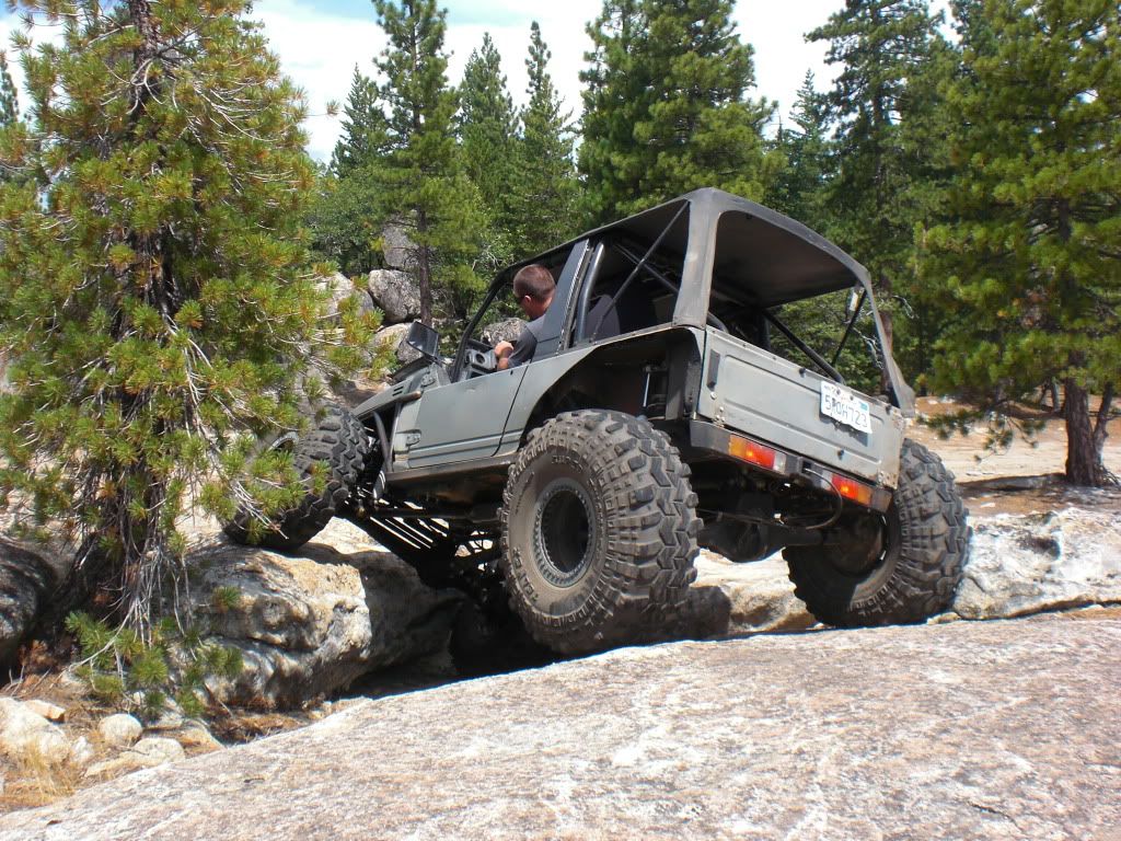

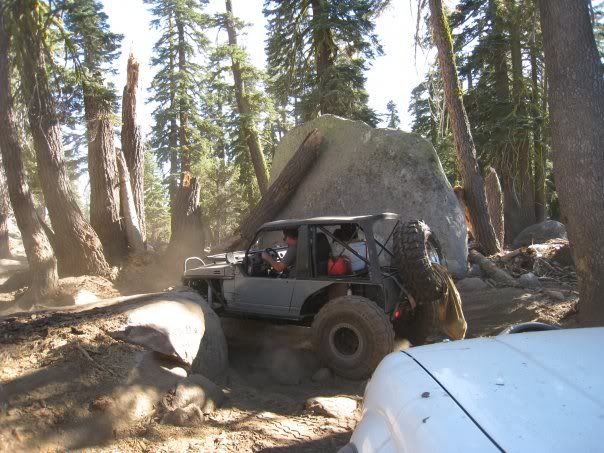

August 06, Rubicon
May 07, Moonrocks
August 08, Barrett Lake

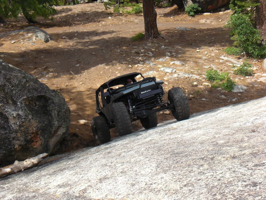

and now to where this stage of the build will lead us:
August 09, shake down run

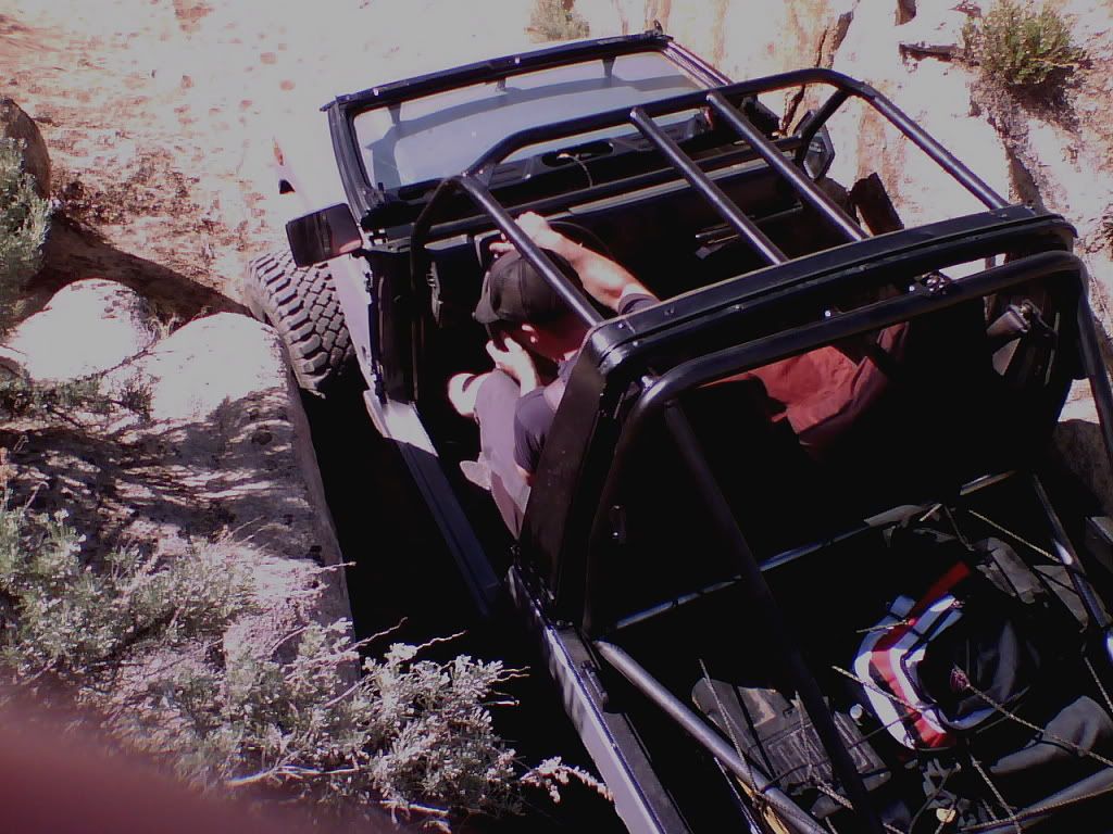

don’t mind the E-brake cable poking me in the receiver
the only (short, poor quality) video I have
YouTube - Capps Crossing AUG 09
September 09, Barrett Lake

So far its been awesome. I don't want to say it does donuts and drifts turns without videos though :D. Once I get a full belly skid under it, I will determine if it needs to come up a little, though I wouldn't be suprised if an inch or two get added, more for up travel than anything else

Goals
104ish” WB, 3 link/panhard front, 4 link rear, conventional coil springs/shocks, Toyota minitruck axles, low and wide, moderately street-legal.
I have been building, buying, bartering and collecting parts for some time now to minimize down time. Buying everything up front wasn’t in the budget anyways. Plus, I have spent the last 2-3 years wheeling instead of pondering a rig on jack stands.
I plan to reuse as much as possible to keep cost down (I am a Samurai owner). Radiator, gas tank (at least temporarily), proportioning valve and master cylinder, tail gate, hood, grill, doors, top(s), headlights, taillights, etc. Home built and used parts is the name of the game. This ain’t no comp buggy, so fuel capacity, storage/interior room, spare tire, stereo, CB, etc. are all a must
I will do my best to to keep this in chronological order, but I am sure some of it won’t be. Details, pics, part numbers and prices will be included as much as possible. It also might take me some time to document, so don’t expect everything at once :flipoff2:

Lets see if I can guess you have trail-gear four link in rear custom three in front. Those look like stock tj coils or there equivalent with 6.5 in the zuk case on a manual tranny. The flat belly is genius and the low cog you have by slamming the body should make you semi fearless. 36-38" swampers on toy axles. You used jj's for the links. I can't see an airline so maybe not arb maybe lincoln locked front and rear or ??? 4.10 gears in the diff you look like you are in the middle of the build and new ring and pinion usually comes last for most folks trying not to pay all at once for stuff. Gonna guess wb is 96to98" really hard to tell. It looks like ruff stuff weld on beadlocks. Its a great looking build you should be proud. Do you trailer or drive it?
1,166 Posts
Discussion Starter #15
no kit, I did the links on both ends
yes
close. Trail Tough 6.4's, stock motor and trans
yep, 38.5 SXs on minitruck axles
correct
5.29's/spool/lockright
I actually bought the built axles used 3 years ago
104.5" wb
I put a lot of thought into keeping it proportioned, so if it looks shorter, I will take it as a compliment :D
good eye. I am pretty sure they are the only 39 bolt beadlocks out there, easy giveaway if you actually counted them
Thanks! I am. I drive it around town some, and have driven it to the trail, but its a pain in the ass to drive it very far. I am currently flat towing it

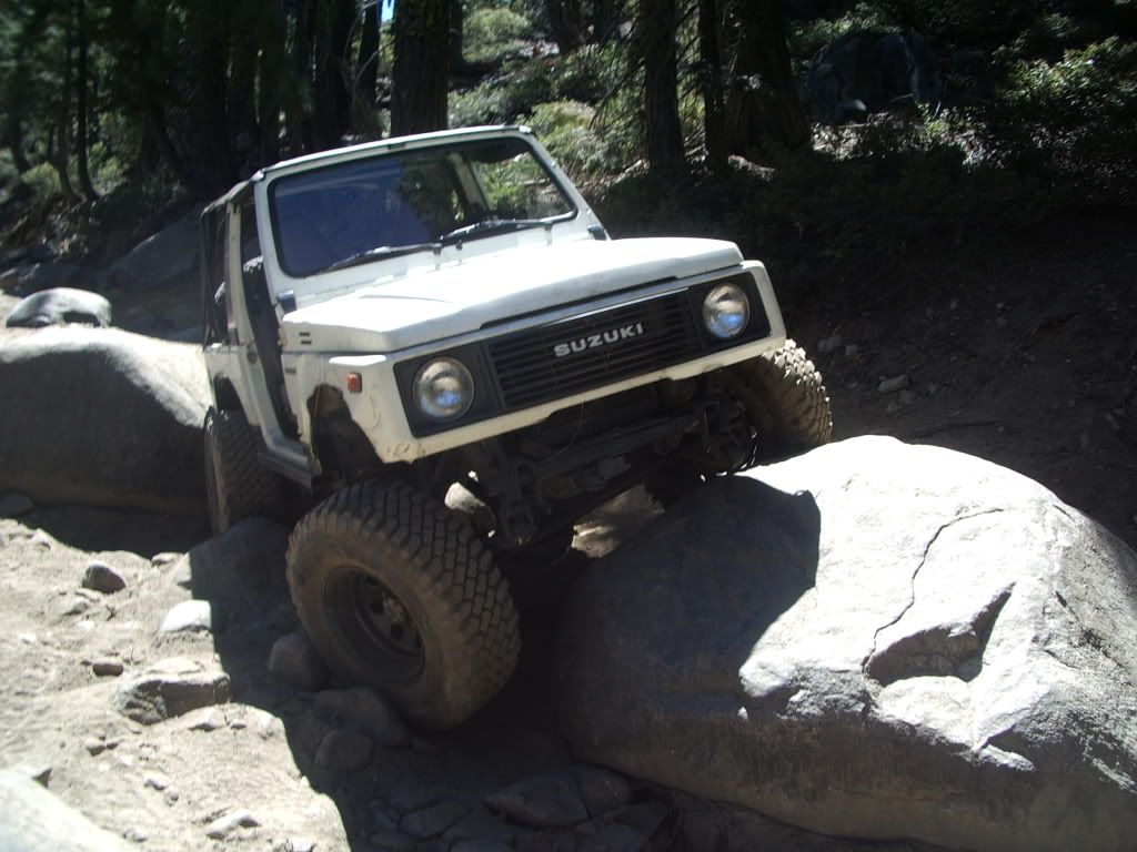

Before I get too far ahead, a brief history:
Feb 2006
As originally purchased for $1300, bone stock with an awesome paint job. Not quite the green (er, yellow?) trim I had imagined on the phone, but I needed a car and had driven over two hours (Sacramento to Santa Cruz) to see this thing. Good running condition and pretty clean.
About 10 minutes later, hadn’t even taken it home yet.
I am quite thankful for spray paint
