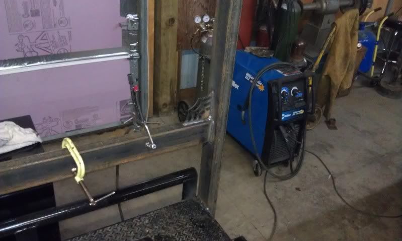

Heres the first stantion.

And updates, we've been really busy with other projects, but we did have the rear uprite/guide laser cut with a groove and the roller bushings turned to run inside that tube. I am on my way to pick up a load of steel.
