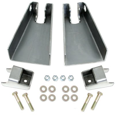

i am expecting a set of ORI's in the next few days but in order to mount them I need some new shock mounts. I am currently running the single piece one that Poly sells (no the 2 separate tabs that you weld). If i am reading this right, the mounting width of the ORI's is 1.60". how are you mounting yours? grind down the mounts or does someone make one that is wide enough?

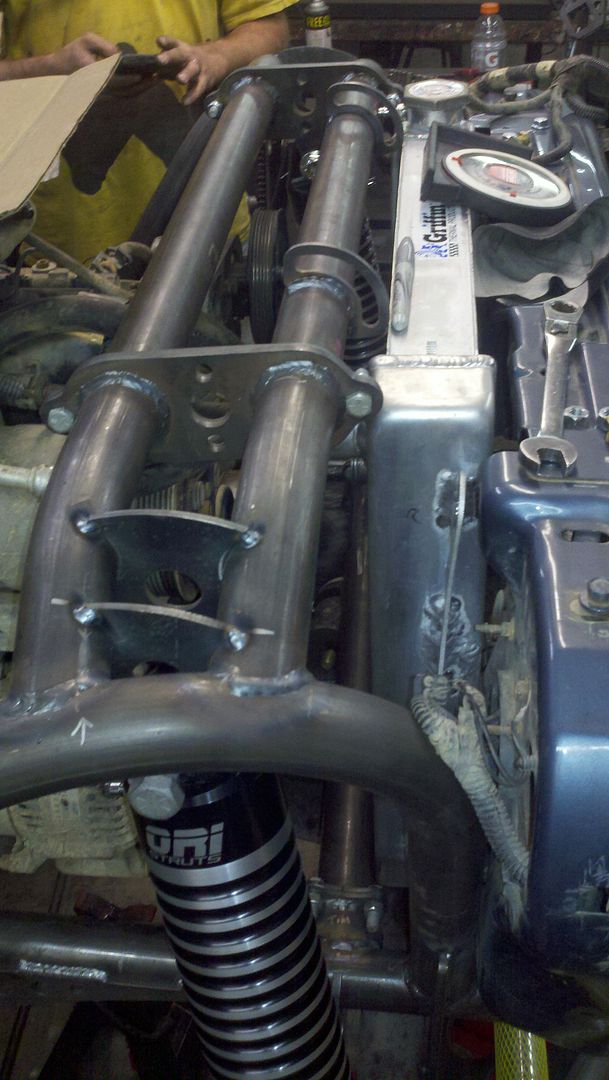

I'm in a similar situation and having not dealt with misalignment spacers before I'm hoping to get a quick bit of advice. I'm installing some ORIs in the rear of my Jeep and the spacing of the misalignment spacers is 1.60". That's just about 1/16" inch too long to fit into the upper/lower mounts of the Synergy towers/mounts I've got. I would think it'd be reasonable to sand down the outer ends of the spacers until they fit, but like I said, I haven't dealt with misalignment spacers so don't want to accidentally miss something.
And input would be appreciated. Thanks, fellas... And here's the towers/mounts I've got:
turn your spacers down so they fit 1.5" overall like I did or order some 7/16" wide spacers
Thanks! Will do...
Thanks for the input! These Synergy mounts are pretty beefy, that's for sure. And I plan to add some gussets to them, as well as tie them into the rear cage down tubes. Not sure the cage tie-ins will be done before Easter Jeep Safari, but if not I'll get to them immediately afterward.
