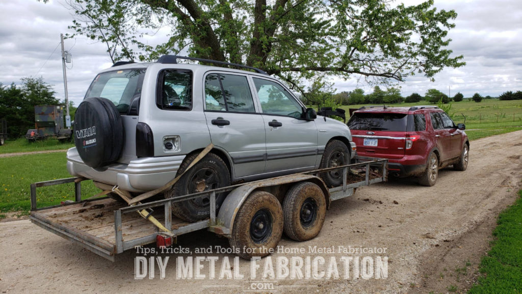

So after many months of looking I happened upon a gem of a Suzuki Vitara/Tracker/Sidekick. 4 cyl 5 speed 4×4 165k miles and a clean title! I debated on the 4cyl vs v6 but I wanted it to be super light and need to polish up on my stick driving skills. All of the V6’s I found were autos.
Left on an adventure to go get it about 1.5 hours away in Wifey's (spotless) rig
Which I promptly got stuck about 3 miles from my final destination...
After adding about 2 hours to our journey and the guy I was to buy the Vitara from coming to pull us out with his tractor. We were on our way with the new ride.
Tally so far: $1,200 plus an extra $200 tip to the seller for coming out, breaking his truck in the process (not sure what happened, shut off and wouldn't start), and getting his truck and 4x4 tractor covered in mud. I really appreciated his help.
Stock as brought home photo for future reference
So why is it named PJ? When I brought it home the wife and I asked Sam our 3.5 year old what he wanted to name it and he said 'Pizza Johnson'. We have no idea where that came from but it stuck, so now it is officially 'PJ'.

Freakin sweet! I had no idea those explorers were rated to tow that much weight!!
Thanks Diesel_Zuk.
The 2011 and newer Explorers (and most of the other similar sized SUV's) are rated to tow 5k. The Suzuki is ~3k and the trailer is probably another 1,500lbs-ish. It came pre-wired for trailer brakes so I picked up a used Tekonsha P3 brake controller that works really well.
Towed it 1.5 hours each way to KS Rocks just fine at about 12mpg (normally ~20mpg). I probably wouldn't use the explorer to tow it through the mountains though.
