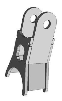

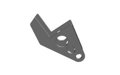

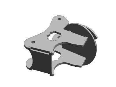

Okay guys, I am wanting to do a SAS on a 96 Explorer.
I am going with coils and radius arm set up. My axle/ wheels will be a 79 D60 front and 37's.
Here's where I need help.
I bought all these brackets from Ballistic Fab (kick ass quality I might add!!!)and they will work just fine for my plans...
And I am going to build my R/A myself.
I want to do them with tube, so heres my questions..
-What size and type joints do you recommend for the R/A's?
-What size and type joints do you recommend for the trac bar?
-What size and type tube?
I have all the skills and resources to build the R/A's, just not the knowledge of the materials I will be needing.

someone else had those upper link brackets fail because of the :rainbow: logo cutout :eek:
then I think they said they changed the part?

I have never heard reports of any of those brackets listed having problems. Any and all brackets that have failed are redesigned and updated.
apologies if I was thinking of the old design or some other bracket.. I can't find the thread right now but my memory tells me that is the logo that was in the middle of a bracket that failed, possibly due to operator error, what the hell do I know? :confused:
Not trying to stir up shit just wanted to make sure the OP stayed safe
